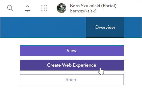

Step 2 – After signing in, click Create Web Experience. This creates a new web experience from the tutorial template.

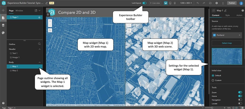

Step 3 – Examine the Web Experience Template.
The template includes side-by-side Map widgets that contain a 2D web map and 3D web scene. Click each Map widget in the template, or select one from the page outline in the side panel, to view their settings in the settings panel on the right.
Click Live view from the Experience Builder toolbar to explore the maps. Note that the maps pan and zoom independently. In the following steps you will configure the settings for both map widgets to sync them. Remember to turn off Live view when finished.

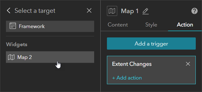

Step 6 – You will use a change in the extent of Map 1 to trigger an action in Map 2. Click the Extent Changes trigger.
Step 7 – Select Map 2.
This sets Map 2 as the target widget when a change in extent occurs in Map 1.

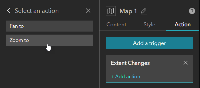

Step 8 – Select Zoom to as the action for Map 2 when the trigger occurs.
The Action panel for Map 1 should show the following: Extent Changes is the trigger, Map 2 is the target, and the Map 2 action is Zoom to.

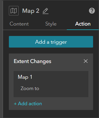

Step 9 – To complete syncing both maps, repeat steps 4 through 8 above using Map 2 as the trigger and Map 1 as the target.
When finished, the Action panel for Map 2 should show the following: Extent Changes is the trigger, Map 1 is the target, and the Map 1 action is Zoom to.
