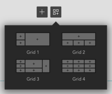

As a layout widget, Grid helps you easily align and organize other widgets in two dimensions. When you add a Grid widget, you are given the option of starting with one of four default layouts. You can modify each layout to meet your needs.

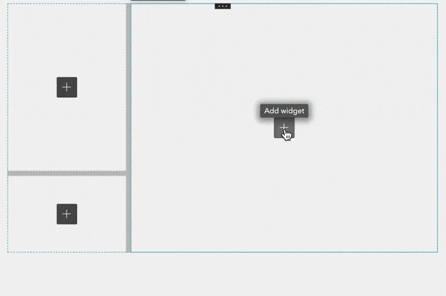

Grid item
The Grid widget works by organizing other widgets into grid items. Click the plus button to add a widget to a grid item.

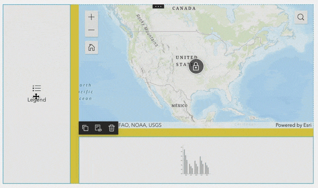

You can also drag and drop widgets to add them to the grid. When you drag a widget into a grid item that contains other widgets, the layout changes automatically depending on where you place the widget. You can place a widget in any of the following positions—left, right, bottom, top, or center. A shadow indicates where the widget will be placed. When you place a widget over the center, the widget is added as a new tab.

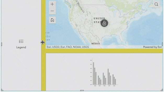

There are gaps between grid items. You can resize grid items relative to each other by placing the cursor in a gap, clicking, and dragging. You can also change the color and width of the gaps in the widget’s settings.
![Resize grid items Resize grid items](https://www.esri.com/arcgis-blog/wp-content/uploads/2022/11/ezResize.gif)

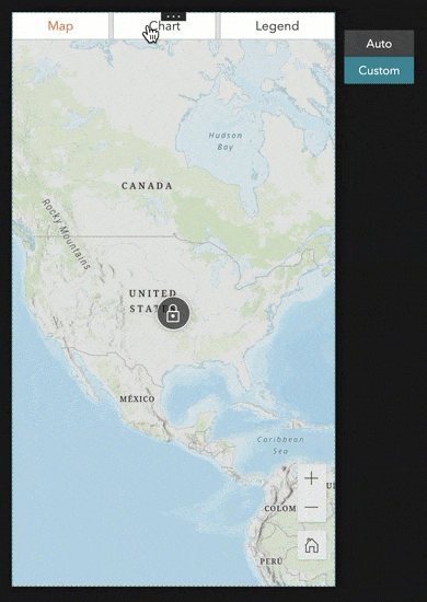

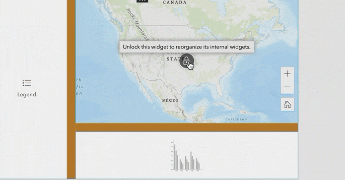

Note that when you add a Map widget as demonstrated below, a lock icon displays in the center of the map. This is because the Map widget can contain other widgets too. You can click on the lock icon to unlock the map and add other widgets like Widget Controller and configure them. When the map is locked, you can only configure and position the map itself. In general, widgets that allow you to nest other widgets inside of them, including Map, List, Card, and all layout widgets have the locked and unlocked states.
![Unlock the map in a grid item Unlock the map in a grid item](https://www.esri.com/arcgis-blog/wp-content/uploads/2022/11/ezUnlock.gif)

Optimizing for mobile
On mobile screens, all grid items configured on the desktop view are accessible through tabs. For widgets that are not needed on the mobile view, you may customize the mobile view by moving them to the pending list. By moving them to the pending list, you can have less tabs on the mobile view while keeping them on the desktop view.
![Optimizing for mobile Optimizing for mobile](https://www.esri.com/arcgis-blog/wp-content/uploads/2022/11/ezMobile.gif)

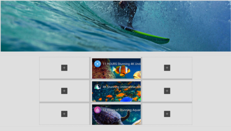

Keep in mind that Grid can be added to a full or scrolling page. In the latter, it is useful for organizing page elements, such as embedded media.
![Grid in scrolling pages Grid in scrolling pages](https://www.esri.com/arcgis-blog/wp-content/uploads/2022/11/File0-e1668489942817-768x437.png)

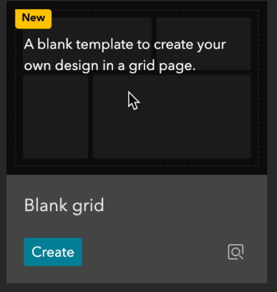

Blank grid template
Built on the Grid widget, the Blank grid template helps you quickly create your own design in a full-screen page.
![Blank grid template Blank grid template](https://www.esri.com/arcgis-blog/wp-content/uploads/2022/11/File1-e1668488272835.png)

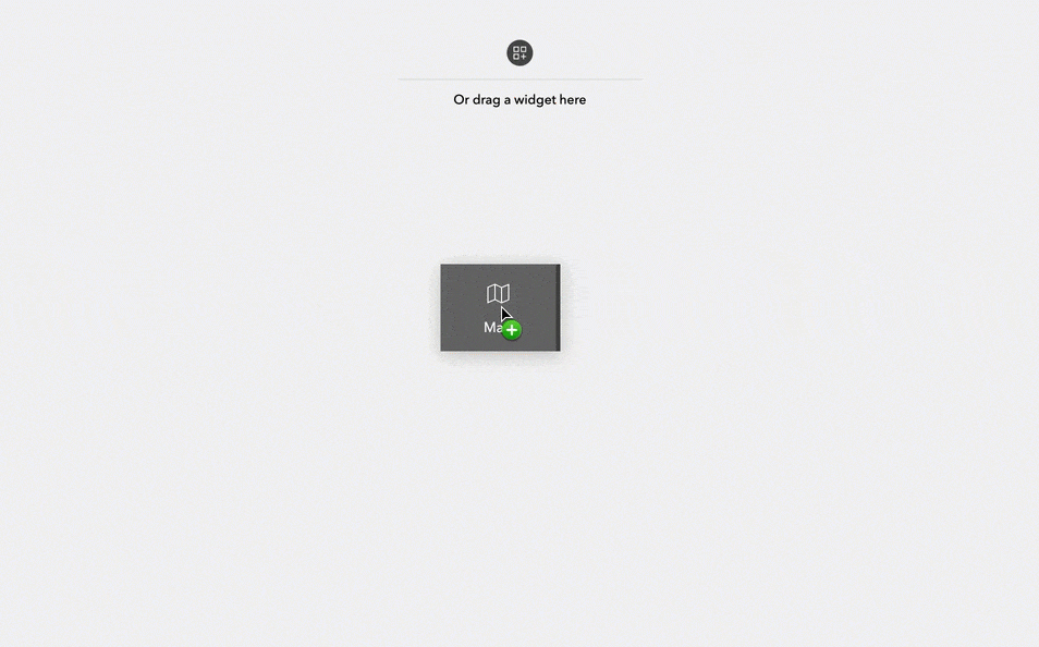

When you drag and drop widgets onto the page, the layout changes automatically.
![](https://www.esri.com/arcgis-blog/wp-content/uploads/2022/11/Blankgrid.gif)

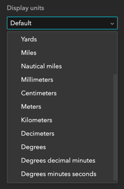

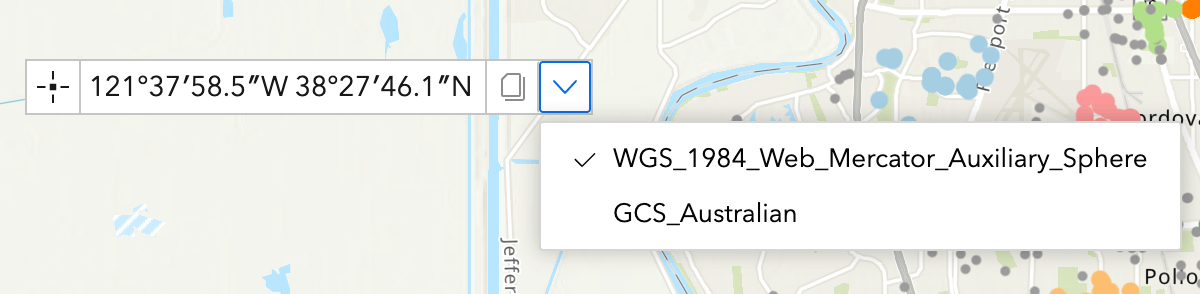

The Coordinates widget displays coordinates for web maps and scenes. Like its ArcGIS Web AppBuilder counterpart, you can configure the widget with one or multiple coordinate systems and project them on the fly with your preferred display units.
![Coordinates widget Coordinates widget](https://www.esri.com/arcgis-blog/wp-content/uploads/2022/11/File2.png)
![Display units option Display units option](https://www.esri.com/arcgis-blog/wp-content/uploads/2022/11/File4-e1668488383632.png)

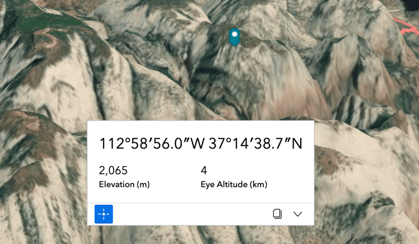

The widget offers two styles—Classic and Modern. For 3D scenes, it also displays elevation and camera altitude values if available.
![Display coordinates on 3D scenes Display coordinates on 3D scenes](https://www.esri.com/arcgis-blog/wp-content/uploads/2022/11/coordinates-3D0.png)

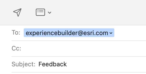

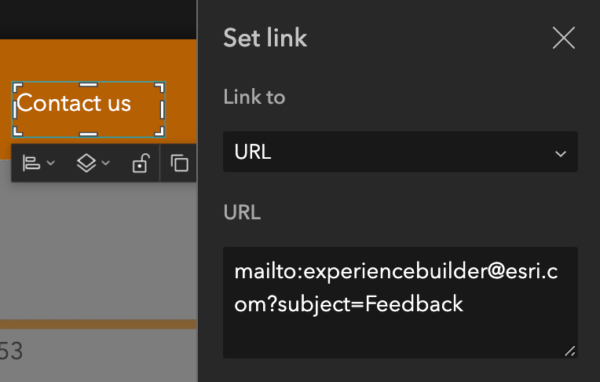

Set link

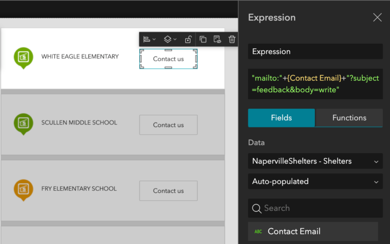

Sometimes you may want users to contact your store, for example, by email, phone number, or SMS text message. You can now use the URL option to set a link to any of those contact options. In the example below, the Contact us text on the header is set to a mailto link with an email address and subject. When a user clicks it, their email application opens with that information automatically populated.
![Set links to email addresses Set links to email addresses](https://www.esri.com/arcgis-blog/wp-content/uploads/2022/11/File12-e1668488509964.png)
![Open the email application Open the email application](https://www.esri.com/arcgis-blog/wp-content/uploads/2022/11/File12-1.png)
When you have an attribute with email information for each record in a layer, you can format a contact list by constructing an expression with the field.

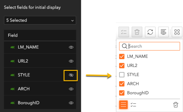

In addition, you can turn the visibility of selected fields off by default, which can be changed by users at runtime with the Show/hide tool.
![Turn off visibility of selected fields by default Turn off visibility of selected fields by default](https://www.esri.com/arcgis-blog/wp-content/uploads/2022/11/File10-e1668488585920.png)

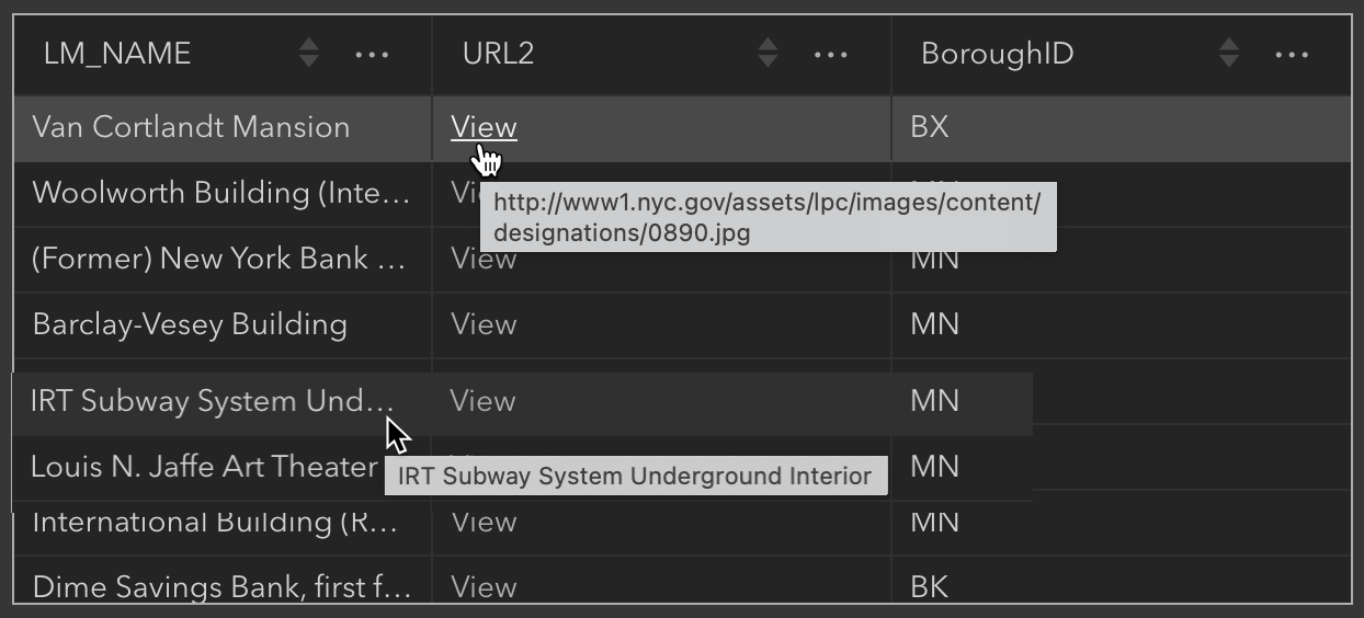

For fields containing long strings, you can now hover over the cell to view its entire value in a ToolTip. You can also click URLs in cells to browse to their location.

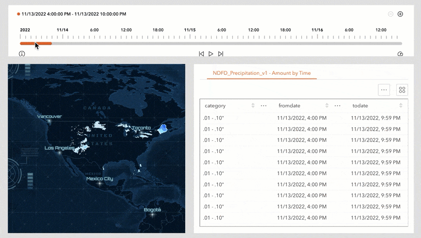

Timeline
When you play or drag the entire time slider forward and backward, a table connected to the same data will automatically filter.
![](https://www.esri.com/arcgis-blog/wp-content/uploads/2022/11/Timeline.gif)
Also, if your data has a time offset, the widget now honors that offset.

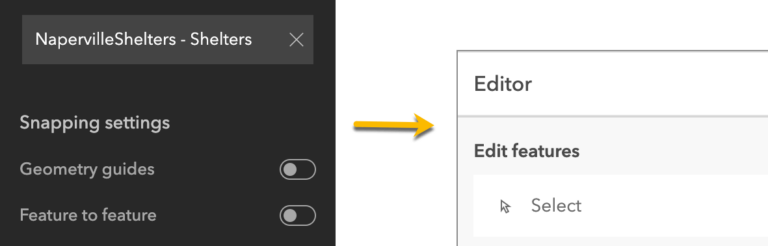

For non-GIS users, the snapping capabilities may be confusing. You can now turn snapping tools off in the widget’s settings to simplify the user experience.
