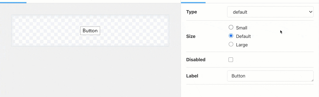

With Playground, you can dynamically view a subset of UI components on the canvas by interacting with their properties. Take Button as an example:
Button in playground

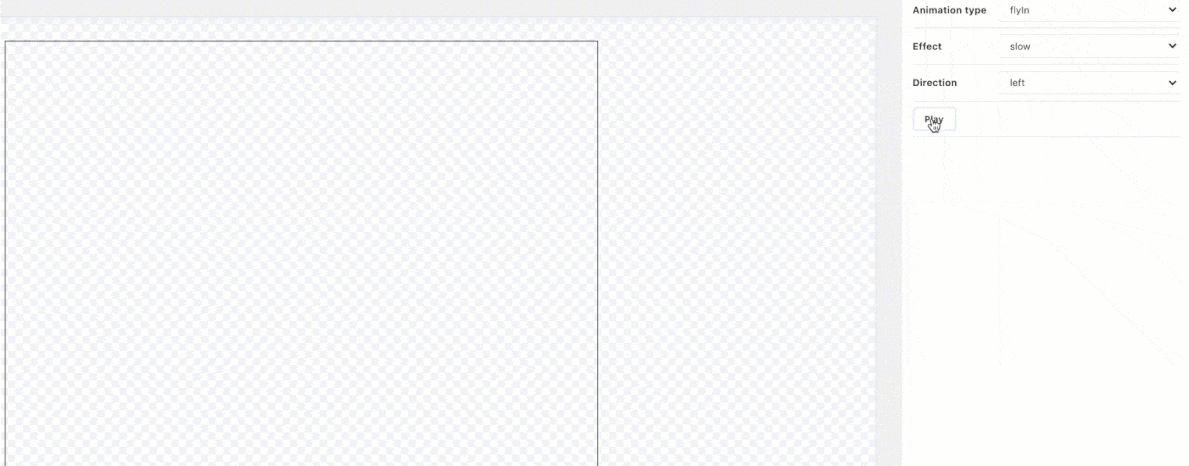

The animation component below is another example:
Animation playground

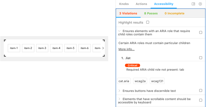

It also checks accessibility violations for each UI component with suggestions. For instance, one of the violations in the scroll-able component is that it does not comply with an ARIA rule defined in WCAG.
Accessibility check

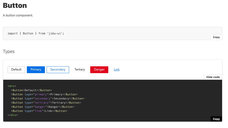

With Components, you can access samples and API documentation for UI components, such as Button, under the Docs tab, and copy and paste the sample code to build your own buttons.
Copy Button code

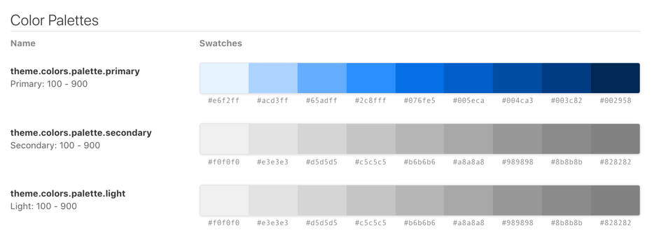

With Theme System, you can view the core variables, such as color, font, icon, etc. The icons include common SVG icons used in Builder and widgets.
Color variable

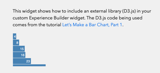

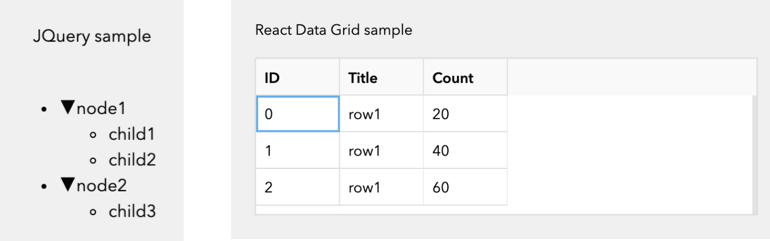

You may be interested in using third-party libraries in your custom widgets. Depending on if the library is used in one or multiple widgets, three options are recommended and illustrated in the D3, JQuery, and React-data-grid sample, respectively:
D3 sample
JQuery and React data grid
