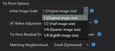

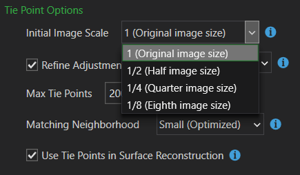

One way to potentially fix uncalibrated images is to increase the image scale that the tie points are generated. By default, Drone2Map uses an initial image scale of 1/8 (Eighth image size). If an image is dropped during the free network adjustment, it is not used during the refinement process. Modifying the Initial Image Scale value to 1 (Original image size) will help improve tie point generation and lead to more consistent matches between images.
Tie point options
Available image size options for extracting tie points.

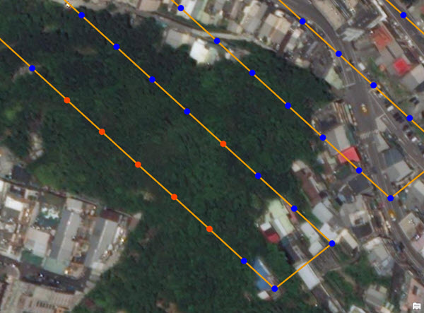

Overlap problems typically are caused by poor flight conditions or flight planning. One way to potentially salvage the data is to increase the size of the image neighborhood that Drone2Map will use to find matching neighboring images. This can be done through the Processing Options Adjust Images section. The setting for Matching Neighborhood handles what size of a neighborhood the adjustment will use when finding neighboring images. Increasing this setting from Small (Optimized) to Medium or Large will increase the number of candidates for tie points between neighboring images.
Flight path showing uncalibrated image points
Project adjusted using the small matching neighborhood setting, resulting in multiple uncalibrated images.
Flight path showing calibrated image points
Project adjusted with the large matching neighborhood setting. Uncalibrated images are now calibrated.
If these suggestions do not help, then the problem is more than likely the flight itself. The project will have to be re-flown with proper flight planning guidelines. For flight recommendations see the following blog: Drone2Map flight planning

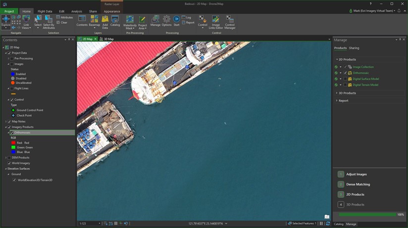

Water by nature can be quite turbulent and reflective. Therefore, it is notoriously hard to derive feature points between drone images where much of the image is of water. Attempting to process these images in photogrammetry software can sometimes cause the water body areas in the orthomosaic to have artifacts and display as patchy, discolored, or jagged areas.
Waterbody reconstruction issues
Imagery consisting mostly of water may have difficulty reconstructing.

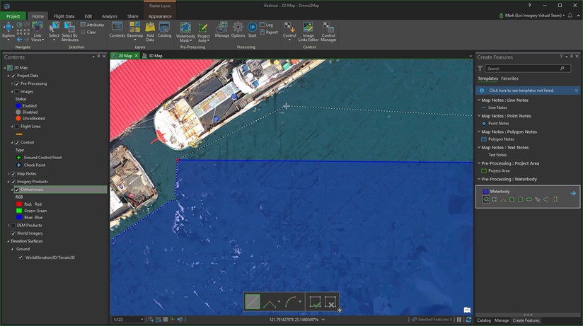

A waterbody mask being drawn
Drawing a waterbody polygon area to mask an area of poor water reconstruction.

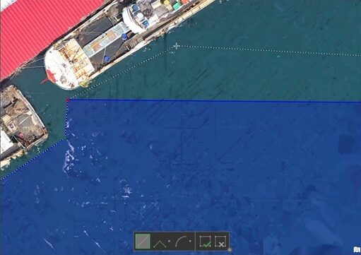

When this happens in a Drone2Map project you can attempt to correct the erroneous areas by applying a waterbody mask. This functionality can be found on the Home tab under the Pre-Processing tools group. A waterbody mask can either be drawn as a polygon or imported from a polygon feature class over the area experiencing reconstruction problems. There are two processing methods when using a waterbody mask, precise and coarse. The precise option assumes you have precisely defined the boundaries between what is water and what is not using the waterbody mask polygon. The coarse option allows for more flexibility and will attempt to correct water areas even if manmade features or shoreline areas appear within the waterbody mask polygon. Regardless of the option chosen, when the processing is re-run the waterbody mask area will be interpolated to smooth the area.
Results of a waterbody mask
Results of using a waterbody mask to interpolate and clean up poor reconstruction of water areas.

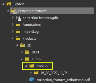

Both the waterbody mask and correction features tools work on the concept of tile based processing. True Orthomosaics are initially generated as tiles, then mosaicked together to give you seamless products. Which is helpful because Drone2Map can then select and re-process only the tiles that overlap with the polygon features that you have drawn. This method drastically cuts down on processing times and allows for faster turnaround when running quality control on your projects. Backups are also created each time you process so that you can revert back if not fully satisfied with the results.
Project backup location
Backups are created when re-processing products.

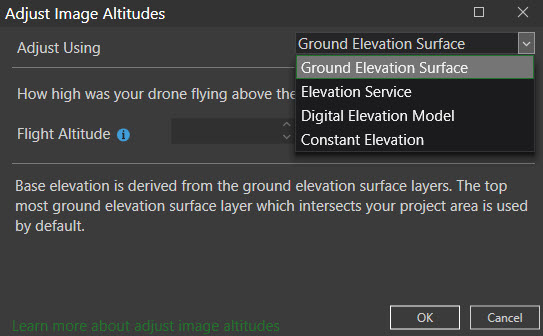

One the quickest and most convenient ways of fixing the altitude is to use the Adjust Image Altitudes tool found under the Flight Data tab. Once you have selected the problematic image points you can adjust the height of those images to align with a variety of input elevation sources. This is generally a good option if you are planning on publishing your imagery products to ArcGIS Online or ArcGIS Enterprise and aren’t concerned with survey grade accuracy.
Adjust image altitude
Adjust image altitude tool with elevation options.

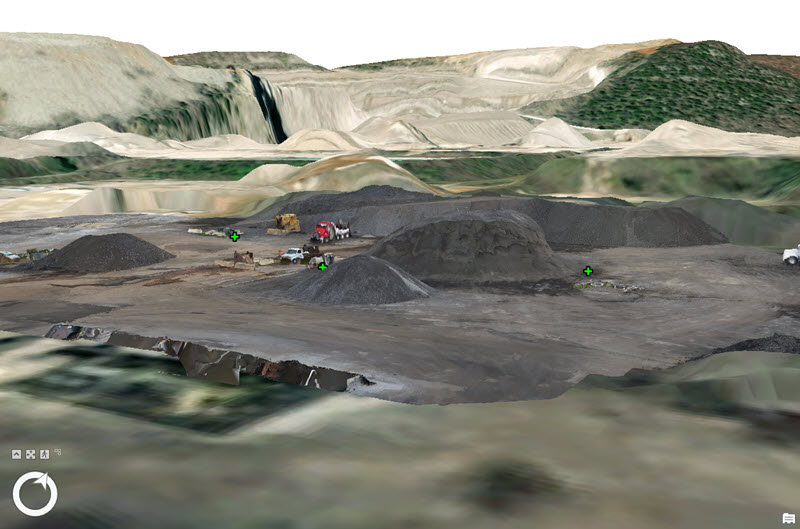

Another way to attempt correcting poor vertical accuracy is to use Ground Control Points (GCPs). It is always good practice to be collecting GCPs with each flight project if possible. If you frequently find your products are appearing above or below the elevation surface when viewing them within a map or scene, then GCPs will help align the heights properly. When you import ground control points into Drone2Map each point should have a pre-recorded height or elevation value. By linking images together using those GCPs and running your processing, the software will adjust the output products to the same elevation of the GCPs.
3D product appearing above the ground
Vertical offset from the elevation layer with a 3D mesh.

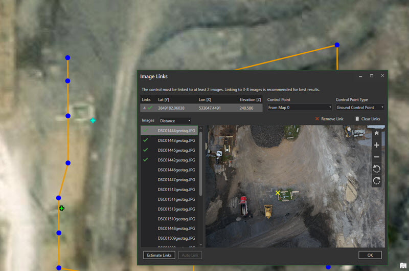

Even if you did not have the chance to collect GCPs within the field for that given project you can still create GCPs. Drone2Map allows you to create GCPs based off the basemap. While this is not going to be close to the accuracy you will receive by collecting ground control points in the field, it can still help with adjusting products to align with the ground surface. This is just one possible option to explore in correcting vertical issues, for more information on other solutions see: Having a bad case of vertigo
Creating GCP links
Manually creating links between images for GCP's.
