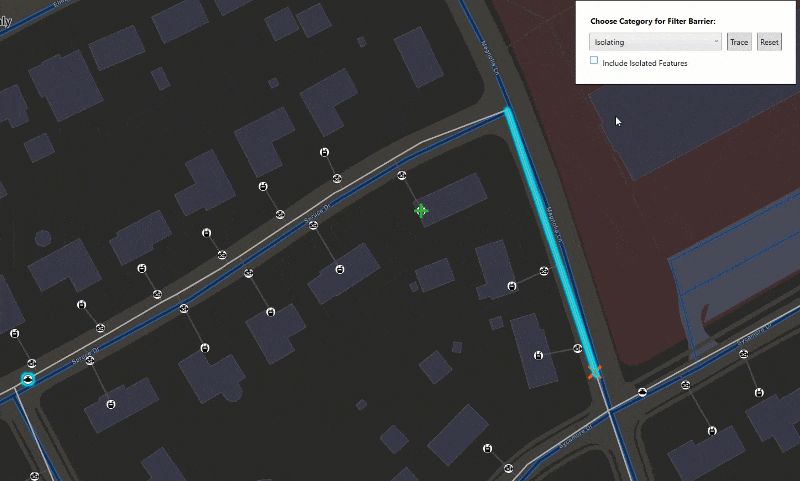

Over the last few releases we’ve nearly completed support for all trace types and configuration parameters. We already support the idea of using starting points and barriers in a trace. In general, barriers block traversability to the source. With Update 10 we add support for filter barriers which can stop trace results without stopping traversability to the source. This is important for modeling squeeze off points for gas pipelines. This addition basically completes our support for configuration parameters.
![Use of filter barrier in isolating trace Use of filter barrier in isolating trace](https://www.esri.com/arcgis-blog/wp-content/uploads/2021/01/RuntimeU10-unfilterbarrier.gif)

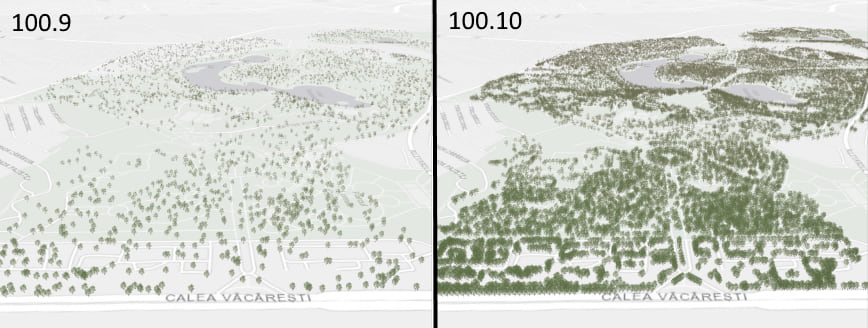

In Update 9 we released support for feature tiles in a map. In Update 10, we support feature tiles in a scene. We’ve also added an API to enable/disable use of feature tiling for developers that choose to do so.
![Difference in features returned with and without feature tiling Difference in features returned with and without feature tiling](https://www.esri.com/arcgis-blog/wp-content/uploads/2021/01/RuntimeU10-3dfeaturetiles.png)
