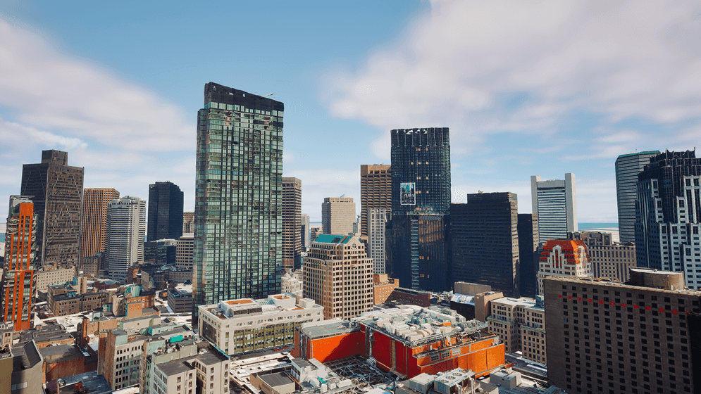

The Unreal Engine Maps SDK now supports 3D Tiles, expanding the seamless integration of 3D geospatial and photorealistic data in your apps, and one of the most requested features from our developer community. In the SDK, 3D Tiles layers function similarly to the existing 3D scene layers, such as integrated mesh and 3D object, enabling you to easily integrate a range of layers and data sources into your apps. Utilize existing tools to visually clip and mask these layers to focus on the most relevant data for your specific area of interest.
Integrated Mesh 3D Tiles of Boston, generated with ArcGIS Reality
Integrated Mesh 3D Tiles of Boston, generated with ArcGIS Reality. Copyright © 2023 Bluesky Geospatial Ltd. / Esri.
3D Tiles layers will align perfectly with your existing layers, because this release introduces support for layers in different vertical coordinate systems, and automatically transforms them into the spatial reference you’ve selected for your map.

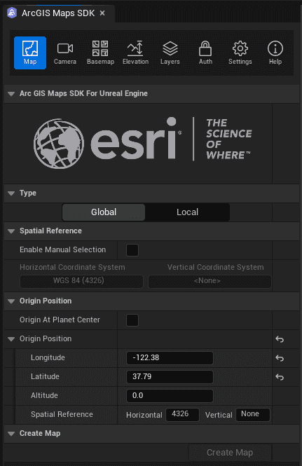

Editor support for setting a map spatial reference
Setting the spatial reference of your map is now supported in the Unreal Editor through the Map Mode UI dialog or components in the Outliner window. While it has always been possible to set the spatial reference of the map using the API, when using the UI the spatial reference was automatically determined by the first layer loaded, usually your basemap. You requested more explicit control in the Unreal Editor integration, and now you can choose your desired spatial reference from a predefined list or specify a custom spatial reference using the Well-Known ID (WKID) format.
Editor support for setting a map spatial reference has been added to the Map tab in the Map Mode UI.
Editor support for setting a map spatial reference.
