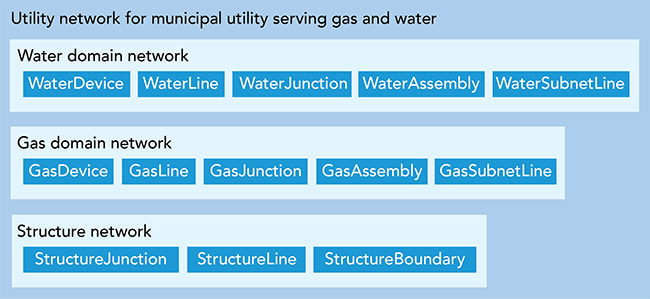

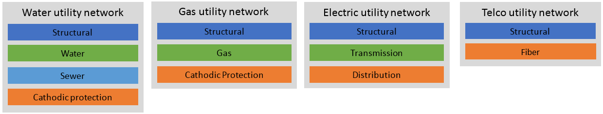

First, let’s discuss the concept of domain networks. It is common for a municipality to manage one or more types of commodity networks. In the utility network, domain networks are equivalent to commodities. A deployed utility network can contain one or more domain networks and one structure network. The number of domain networks maintained is determined by the type of model you are building and the industry you manage.
How are domain networks created? When you configure your utility network, domains are created using the Add Domain Network tool or as part of the automated process for configuring a utility network via the Utility Network Package Tools. Domain networks can be added to an established utility network if business needs change over time. For example, an additional domain network can easily be added to an existing utility network if a municipality that manages a water domain expands to add a gas domain.
The real world has many interdependencies between different utilities. The utility network enables the real-world model to come to life by allowing capabilities such as connectivity between features from different domain networks. For example, you can have an electric domain network that feeds a water pump. Gas pipeline networks can be utilized to illustrate the network that supports electric combined cycle generation.

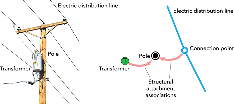

When discussing domain networks it is hard not to talk about structure networks. The structure network is shared amongst all domain network features within the utility network. Features within the structure network do not have any resources such as water or electricity flowing through them but serve to support other network features that are part of delivering a commodity. For example, a vault (which is a structure) can contain valves and regulators that are features of a domain network.
The structure network promotes non-networked features into network awareness. It allows you to expand the foundation model into a wide range of informative products such as inspections, or business intelligence deliverables about all aspects of the utility business. Items like poles, pads, ducts, trenches, stations, and casings are now network aware and can be projected in 3-D space because of its z-scale awareness.
The key purpose of a structure network is to support a type of association called structural attachments. This is a way to efficiently identify which domain network devices or lines are attached to a structure feature. This satisfies a utility’s need to rapidly identify which structure, such as a pole, is associated with a device that may be experiencing an outage. Structural attachments can also be used to create a list of structures that are supporting a section or utility subnetwork. In another post, we will dive deeper into the concept of structural attachment associations.
