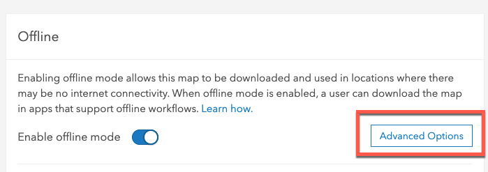

Access web map’s offline settings
Within the web map’s offline settings, select Advanced Options.

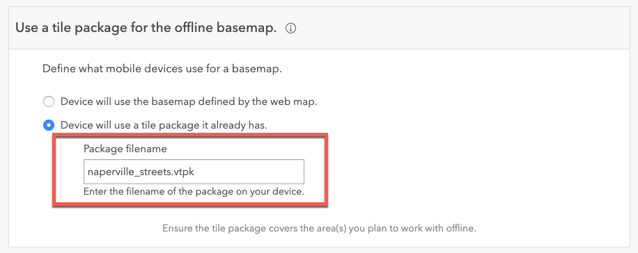

Specify file name of basemap
Indicate that the web map should use a tile package on the device as a basemap
Specify the name of the basemap you want this map to use when working offline. Supported tile package formats include raster tile or vector tiles. (.TPK, .TPKX, or .VTPK).
Save your changes

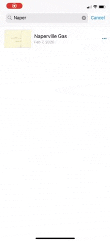

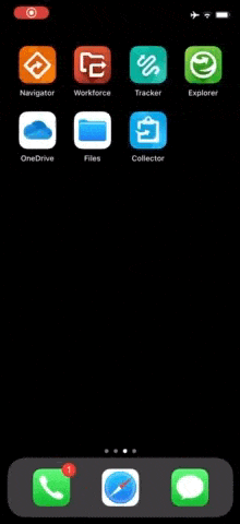

Share basemaps using the Files app
With the latest release of Collector for ArcGIS you now have another alternative to get your basemaps out to the device. Using the Files app on your iOS device you can copy a basemap from cloud storage and make it available from Collector. In addition, this eliminates the need for iTunes.
This offers several advantages over the traditional iTunes method:
- Minimize impact on GIS staff. These are simply shared once using the preferred sharing tool (OneDrive, Google Drive, etc.)
- Allow distributed mobile workers to sideload their basemap since there’s no requirement to physically connect to a computer
- In areas of limited office connectivity or bandwidth, workers download the basemap to their device at home or their nearest coffee shop

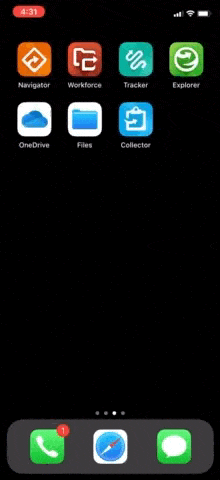

Peer-to-Peer basemap sharing
One final approach is to reduce the number of independent downloads of the basemap. This is particularly important when you have multiple mobile workers in the same geographic area and connecting to the same Wifi network. For example, a number of field staff are at the same location and need to use the same basemap. In this case, one person can download the basemap, then use technologies like AirDrop to share that basemap with others nearby. This also has the advantage of minimizing cellular data usage if WiFi is not available.
AirDrop generally performs well, even for large files such as tile packages.
