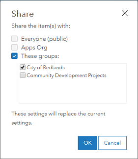

For a map to be accessible by others in Collector, it must be shared with a group (in addition to containing editable data).
- Check the checkbox for the group you want to share your map with and click OK.
![Share dialog Share dialog](https://www.esri.com/arcgis-blog/wp-content/uploads/2018/12/shareDialog.png)

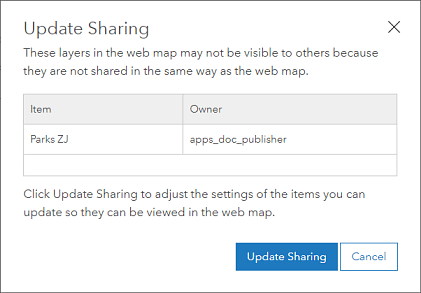

- If your layer isn’t shared with the same group, you’ll be prompted to update its sharing. Click Update Sharing.
This is important: otherwise your mobile workers will be able to open the map but not see or work with the data it contains.
![Update sharing for your layer Update sharing for your layer](https://www.esri.com/arcgis-blog/wp-content/uploads/2018/12/layerShareDialog.png)
