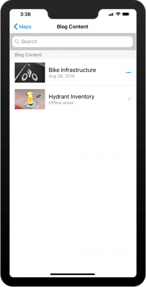

Before we look at how to remove maps, let’s look at an example set of maps available to a user in Collector.
Now let’s remove the Bike Infrastructure map from Collector.

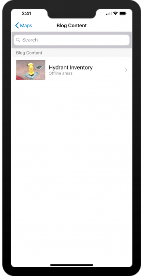

Head back to Collector, refresh your list of maps and notice that the web map is no longer available.

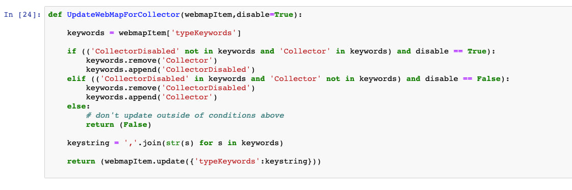

The function below updates some of the typeKeywords associated with the web map item, effectively making the same changes as the option in the web map settings we used earlier.
The following Python function takes two parameters: a web map item, and a boolean indicating whether we want to hide or show a given web map in Collector.
This function works in both a traditional Python script, or in a Jupyter notebook. Change your mind and want to make a set of maps available? Just change the last parameter and the maps are available to Collector.

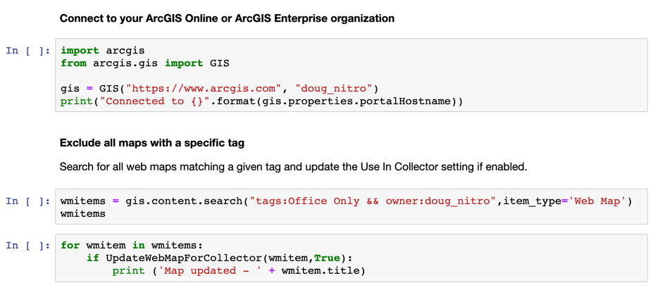

Let’s look at a couple of ways you could utilize this function to update a series of maps. Perhaps you have a set of maps with a specific tag indicating it is for office use only. Perform a quick search as shown in the example below and use our function to update the Use in Collector setting.

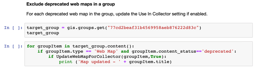

You can also update items in a specific group that have been marked as deprecated.
