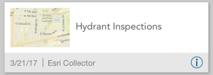

- From the list of maps, select Hydrant Inspections.
![Hydrant Inspection map card Hydrant Inspection map card](https://www.esri.com/arcgis-blog/wp-content/uploads/2017/11/IMG_6290-small.png)

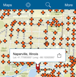

- Since we aren’t creating features, we need to go to where they are. Search for Naperville, IL, and you’ll see the hydrants. Or use the bookmark for the default map extent to see them.
![Hydrants in Collector Hydrants in Collector](https://www.esri.com/arcgis-blog/wp-content/uploads/2017/11/IMG_6291.png)

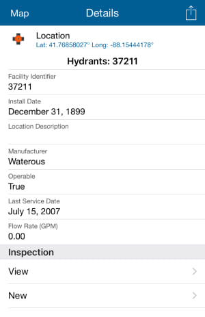

Select one of the hydrants (which one doesn’t matter) and see some information about it, including its identifier, last service date, and if it is operable. We’ll pretend that is the hydrant we are inspecting.
![Hydrant attributes Hydrant attributes](https://www.esri.com/arcgis-blog/wp-content/uploads/2017/11/IMG_6289.png)
Since we are doing an inspection, and not doing servicing or changing anything, we don’t want to change the details (attributes) of the hydrant itself. Instead, we’ll log a report. Inspections can be important over time, so we want to allow the hydrant to have multiple such reports. At the bottom of the details, there is an Inspection section with options for View and New.
- Select New to add your report. A form opens, prompting you for the information you’d want to report while doing your inspection. For example, if it needs paint, or draining, you can submit that information here.

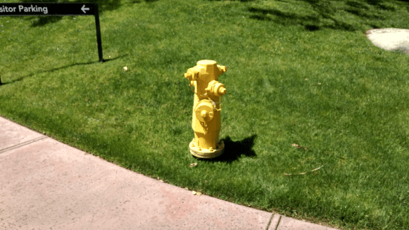

- For this inspection, we want to be sure to include a photo of the hydrant’s current state. Take and attach a photo using the attachments button (a camera on iOS and Windows, and a paperclip on Android).
![hydrant photo hydrant photo](https://www.esri.com/arcgis-blog/wp-content/uploads/2017/11/hydrant.png)

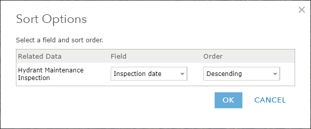

- The hydrant features are how we’ll access our inspections. We’ll use most of the defaults for the hydrant pop-up, but we do want to configure it so that the inspections show with newest inspections first. Make sure you are configuring the pop-up for the hydrants (features), not the inspections (in the table), and use the Sort Optionsbutton at the bottom of the Configure Pop-up pane.
