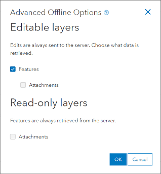

Maps for these workers should be set up so that they get the latest positional and attribute information about assets, but not the attachments. Attachments can be large and quickly grow the size of downloads. On the map’s item page, go to the Settings tab’s Web Map section and beside Offline Mode click Show advanced options. Uncheck the boxes in Advanced Offline Options for attachments of both editable and read-only layers.
![Advanced Offline Options set for no attachments Advanced Offline Options set for no attachments](https://www.esri.com/arcgis-blog/wp-content/uploads/2018/05/Scen2-settings-small.png)

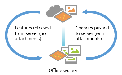

When they go offline initially, these workers only take features (both editable and read-only) and not any attachments.
When they sync, they won’t download any existing attachments, but they get updates to the features themselves. They also send the features and attachments they’ve collected to the server.
![Offline changes pushed to server and features retrieved (without attachments) Offline changes pushed to server and features retrieved (without attachments)](https://www.esri.com/arcgis-blog/wp-content/uploads/2018/05/Scen2.png)
These workers have the information about existing features that they need to do their job, but not the complete picture presented through the attachments. Since attachments can be large, this gives a good balance to the amount of information downloaded for features and the amount of time and bandwidth needed to share their edits.
