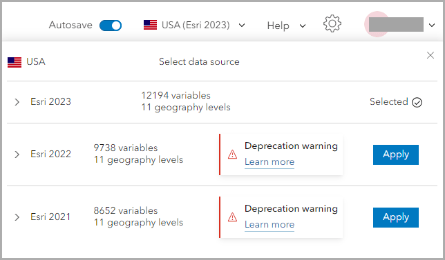

Deprecation notices were added to the Esri 2021 and Esri 2022 data sources in the Country/Region drop-down menu in Business and Community Analyst to explain this migration and deprecation. These data sources were removed in June 2024 release. In preparation for the data deprecation, notices and blogs like this one, showed users how to clean-up sites that may have administrative boundary changes and update infographic templates with newer vintage variables.
Esri 2021 and Esri 2022 data sources will be deprecated in the June 2024 release.

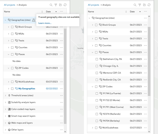

Let’s walk through an example of what it looks like if there are administrative boundary changes in your sites. Using the Esri 2023 data source, we are prompted that 9 saved geographies are not available and cannot be used. By switching to the Esri 2022 data source, we can see that there are changes in four Places (cities) and five California ZIP Codes. These geographies have changed since they were last saved in our project.
9 saved sites are not available.
To understand what geographies are out of date, swap the data source used in the Country/Region drop-down menu to each of the historic data vintages. With each data source, look for changes in the names of saved sites. We recommend organizing sites by geographic type, such as ZIP Code, Place, or County, to quickly scan for differences. Use the Project pane to add new geography layers and name them appropriately for each geography type.
Another method to understand what geographies are outdated is to create a new layer and move the features that may need updating into it. Name this layer To sort. Switch the data source to the newest vintage (Esri 2023) and highlight the differences in sites. If there are no differences, then the sites are valid with the current 2023 administrative boundaries. Move these validated sites into a new geography layer. Name this layer Sorted.
It might seem cumbersome, but a few minutes invested in planning and organization can save many frustrating hours later.

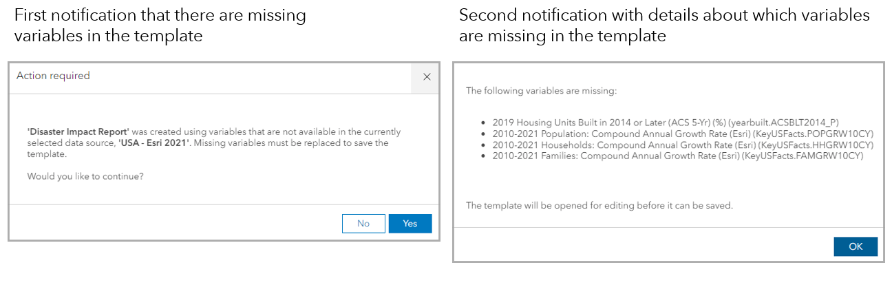

For instance, we migrated the Disaster Impact Report Gallery template, which uses the Esri 2021 data source, into our infographic builder using the Esri 2023 data source. We received two notifications to describe the missing variables.
Example notifications about missing variables in the template are shown.
In order to update the infographic, replace missing variables using the data browser.
