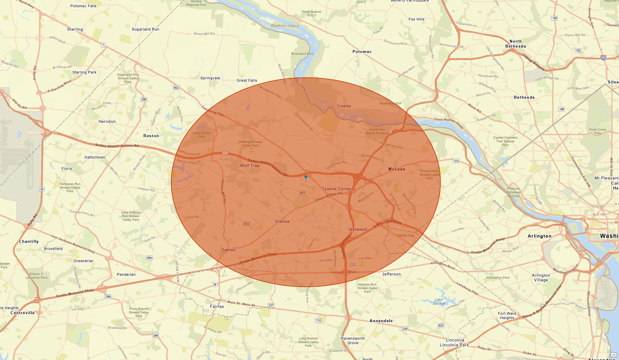

Business Analyst users regularly use rings to depict a trade area for a business or organization. The Generate Approximate Drive Times tool offers further insight into the ring and how people move about within it. For example, Figure 1 shows a five-mile ring around Esri’s Vienna, VA office:

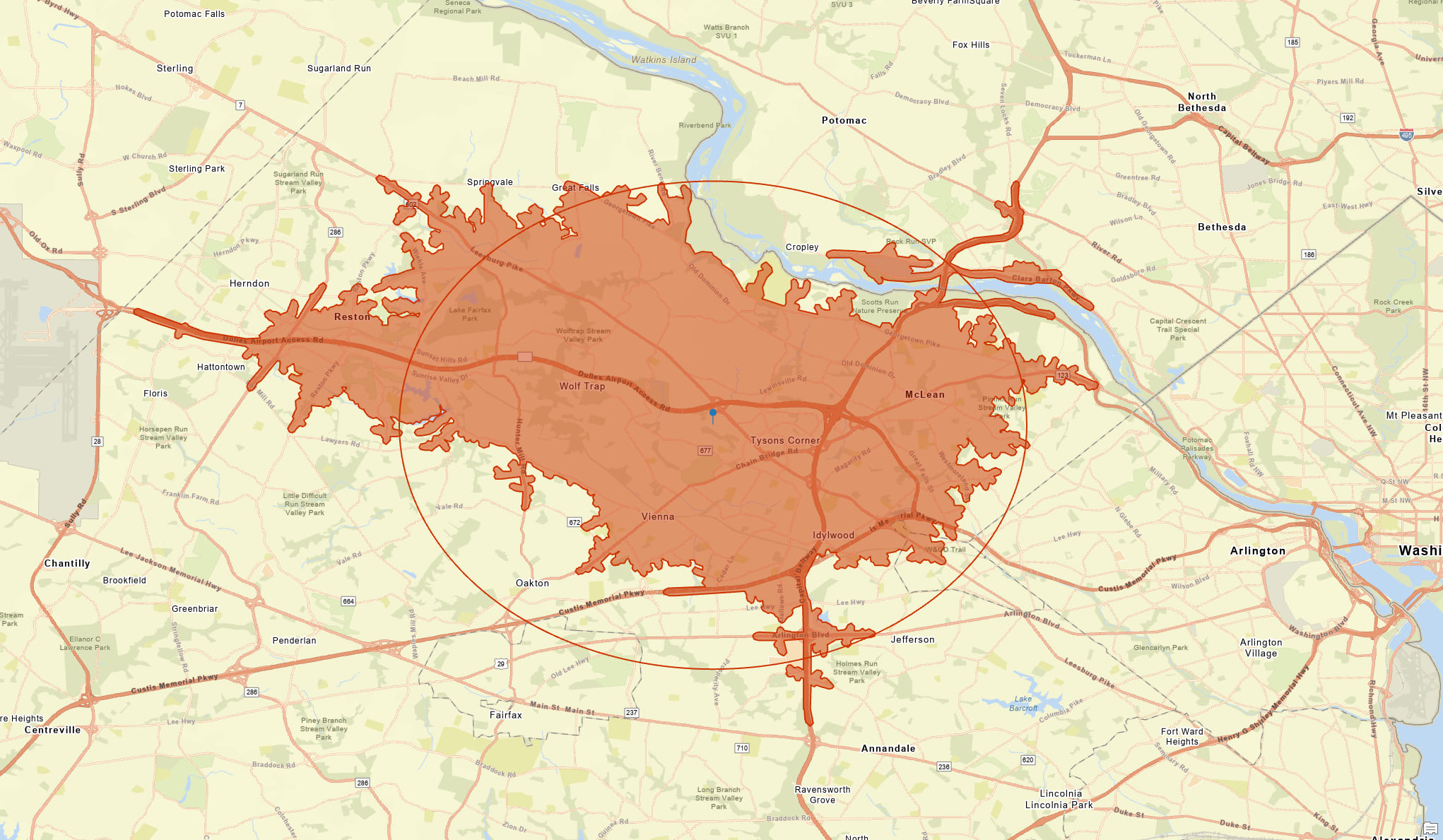

However, human movement in a region is never uniformly predicted by a simple radius. Roads improve transit time, while vehicular traffic and landforms (such as rivers) impair it. When we run the Generate Approximate Drive Times tool, we get a more complex picture of the ring around the Esri office – the new trade area factors in roads, rivers, traffic, and other features that aid or obstruct travel (Figure 2). This information can help determine where to market your products and services. It can also be used as a benchmark when considering additional locations for a business. The results will vary greatly between urban and rural locations, as roads tend to be more diffuse in less populous areas.
