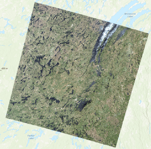

Now you have created a tiled imagery layer based on the multidimensional image in your ArcGIS Online organization. This imagery layer contains three Landsat scenes with eight raster bands for each input image that you can use for your analysis or visualization projects. Multidimensional images in ArcGIS Online Map Viewer can also be visualized with the multidimensional pane to refine the range or animate the map. Hosting tiled imagery layers can be used within your organization just like file based rasters. You can add them to ArcGIS Pro projects, use them in web maps, and also share them in Dashboards and Story maps. These imagery layers do not need to be downloaded to be used and provide a Saas based streaming experience for your organization.
Multidimensional imagery layer
Once the imagery layer is created, you can add it to Map Viewer.
