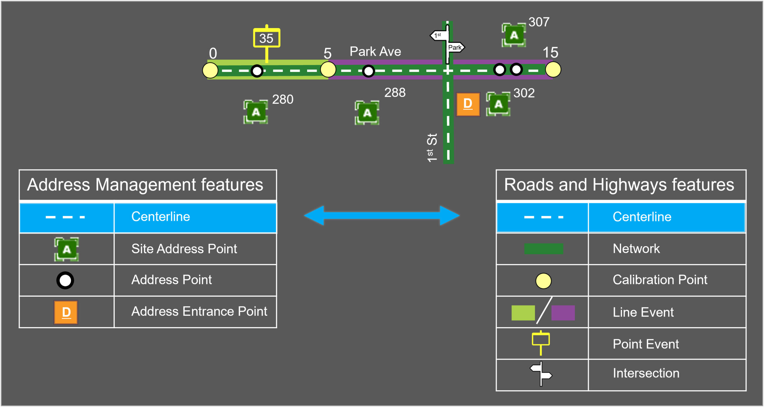

The combined Address Data Management-Roads and Highways deployment pattern solves common issues that organizations typically encounter when managing data. Now, the two solutions can be deployed in a single geodatabase with a shared centerline feature class. This single centerline model provides a single source of truth within the organization and prevents editors from duplicating work and creating centerlines within each business unit.

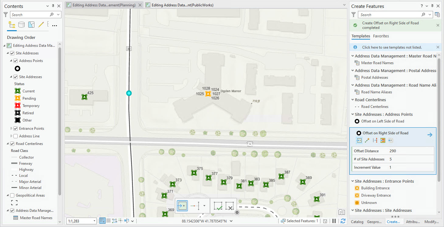

ADM comes with a geodatabase with a fully defined schema out of the box, giving users the choice to deploy the schema as-is or make changes depending on their organization’s business needs. ArcGIS Roads and Highways can be configured within the ADM database via geoprocessing tools, allowing users to customize their schema as needed within a single geodatabase. When the schema is finalized, the feature classes and tables are published as a feature service and can be shared within the organization.
Single application to maintain and edit (and do quality control)
There are tools in both ADM and Roads and Highways for ArcGIS Pro to complete editing address and roadway characteristic data. This reduces the need to go between different applications or maps. Additionally, a combination of attribute rules and ArcGIS Data Reviewer can be utilized in ArcGIS Pro to perform quality assurance/quality control.

For organizations utilizing non-Esri/third-party applications that need a combination of address and road attribute data in a single feature class or table, the Overlay Events geoprocessing tool takes centerlines with address information maintained by ADM and combines it with roadway characteristics, such as number of lanes and speed limit that are managed within Roads and Highways. You can run analysis utilizing geoprocessing tools on this service and publish the results for use in these other applications.
