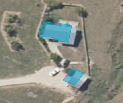

This warning means that one or more of your data layers use a geographic coordinate system (GCS) that is different from the one used by the map. Any time that happens, ArcGIS Pro has to apply a transformation to make the data draw in the right place. Transformations are part of the “projection-on-the-fly” process. But sometimes a transformation can’t be found. When that happens, projection-on-the-fly is not working fully, so ArcGIS Pro warns you about it.
When a transformation is missing, ArcGIS Pro chooses an approximate display, which can result in features from different layers being misaligned. These offsets usually range between several centimeters and several meters.
Building polygons offset from imagery basemap due to missing transformation

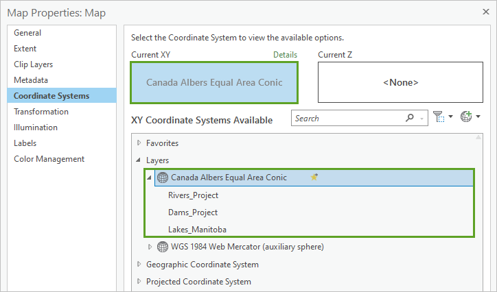

1. In the Contents pane, right-click Map and choose Map Properties.

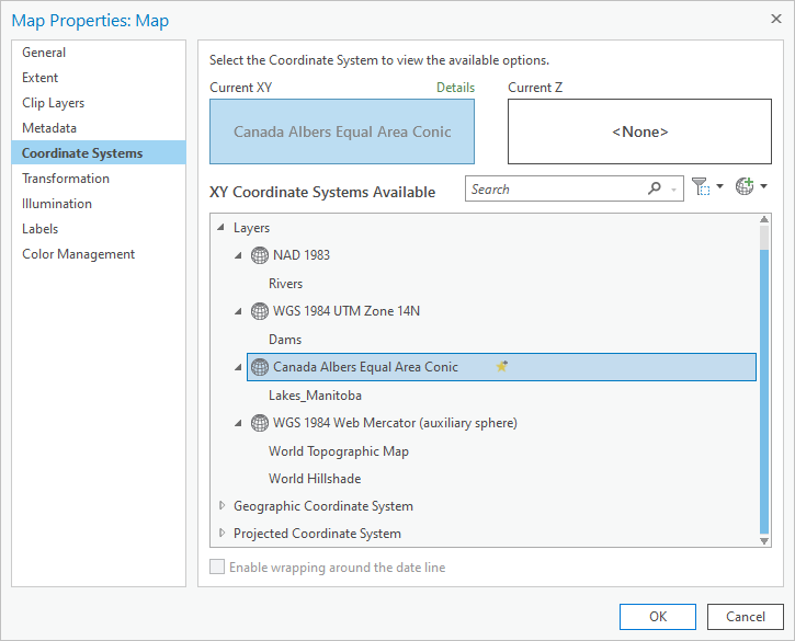

2. In the Map Properties window, click the Coordinate Systems tab.
3. In the XY Coordinate Systems Available list, click the coordinate system that you want. This will change the coordinate system of your map.
Coordinate Systems page in the Map Properties window
In this example, I chose Canada Albers Equal Area Conic because it’s the coordinate system used by one of my thematic data layers. I know that I’ll be doing some area calculations, so an equal area projection is a good choice.
4. Next, you need to make sure all layers that will participate in your analysis or editing use the same coordinate system as your map. Look at the Layers list and take note of which layers will need to be converted. If you’re unsure if a layer needs to be converted, assume that it does.
In this example, the Dams and Rivers layers need to be converted. The basemap layers can’t be converted, but they also are not participating in my analysis, so that’s ok.

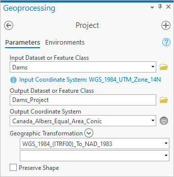

6. Use the Project geoprocessing tool to convert layers into the same coordinate system as your map. If you have raster data, use the Project Raster tool instead.
You may need to use a geographic transformation as part of the Project process. If that’s the case, you can choose the first one in the list.

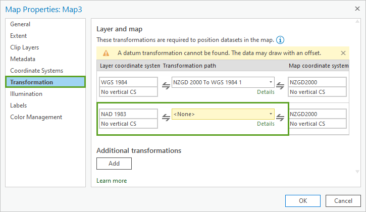

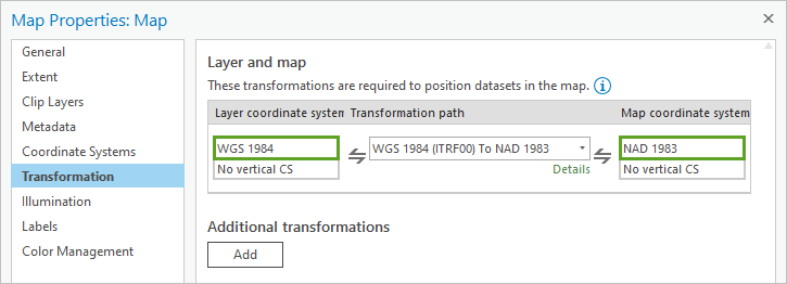

2. In the Map Properties window, click the Transformation tab.
This view will show you which coordinate system is causing the warning.
Transformation page with one transformation missing
In this example, the data that uses the geographic coordinate system NAD 1983 is causing the warning.

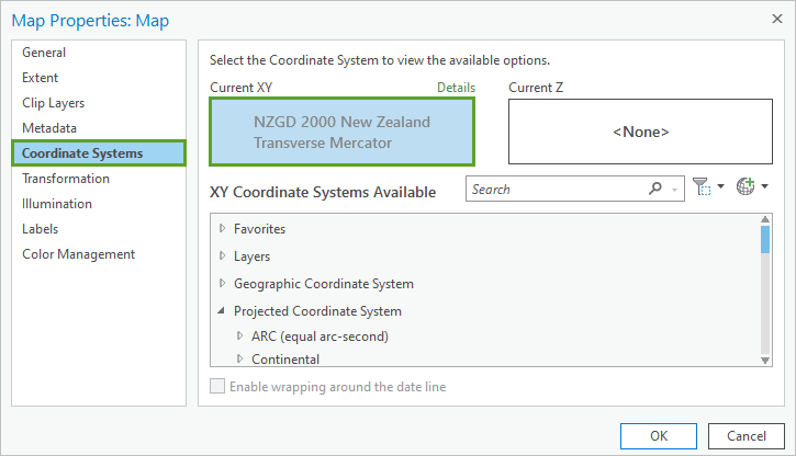

3. Click the Coordinate Systems tab.
In this example, my map’s current coordinate system is NZGD 2000 New Zealand Transverse Mercator. But the map I want to make is of Canada, so it’s not a good choice.
The reason a transformation couldn’t be found is because there is no overlap between the New Zealand datum used by the map and the North American datum used by the data. In this case, simply choosing a more appropriate coordinate system for your map will eliminate the need for the missing transformation.

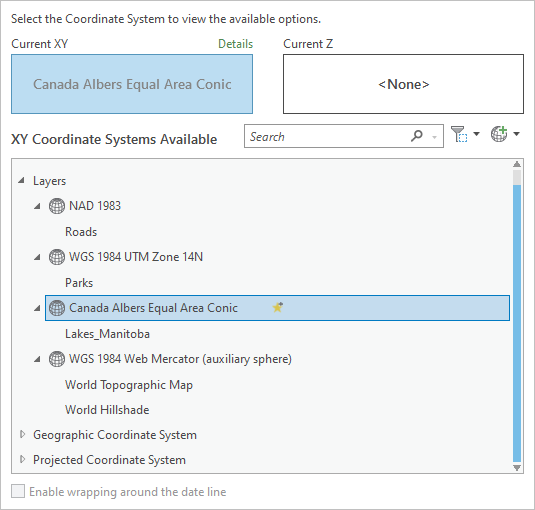

4. Choose a new projected coordinate system from the list.
Learn about how to make that choice here: Choose the right projection.
Because you’re making a map, you should choose a projected, not geographic coordinate system. Read about the difference here: Geographic vs Projected Coordinate Systems.
I decided to use Canada Albers Equal Area Conic for my map’s coordinate system. One of my map layers already uses this coordinate system, so I expanded the Layers list and chose it from there.
Canada Albers Equal Area Conic chosen from the Layers list

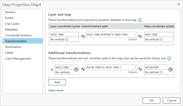

5. In the Map Properties window, click OK. Your map will redraw with the new coordinate system.
Next, you’ll check if you have any missing transformations.

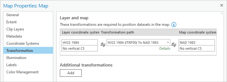

6. Reopen the Map Properties window and click the Transformation tab.
Transformation page
There are no missing transformations! You can now continue mapping!

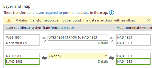

Missing transformation due to mismatched vertical coordinate systems
In this example, I’m using vertical coordinate systems. Both the map and the data use the same geographic coordinate system (NAD 1983) but they have different vertical coordinate systems (NAVD 1988 and NAD 1983). No transformations were found to convert between these two.

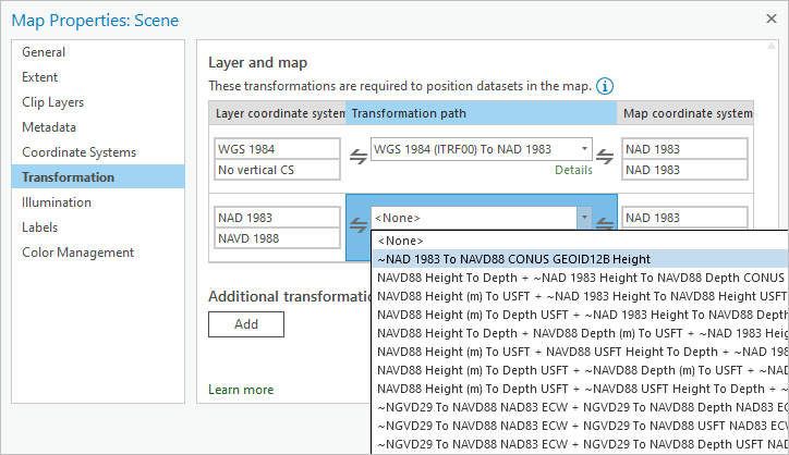

In fact, there are several transformations that will work here. They are just not included in the default installation of ArcGIS Pro, because they are very large files. But you can download and install them separately.
1. Close ArcGIS Pro.
2. Download and install supplementary coordinate system files from My Esri.
7. When the installation has finished, reopen ArcGIS Pro.
You may still see a transformation warning, but this time, you’ll be able to fix it.
8. Open Map Properties and click the Transformation tab.
9. Click and choose the first transformation from the list.
Available transformations list

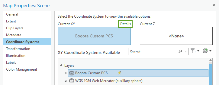

Either your data or your map uses a custom geographic coordinate system
1. Open the Map Properties window and click the Coordinate Systems tab.
2. Choose the coordinate system that is causing the warning.
3. Click Details.
Coordinate systems details link

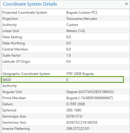

4. In the Coordinate System Details window, under Geographic Coordinate System, find the WKID row.
If WKID is 0, that means that the GCS definition is custom and you will not be able to find a transformation.
This is a case for the Create Custom Geographic Transformation tool. For an example of how to use this tool, see Adding a Newer Coordinate System Definition to an Older Version of ArcMap.

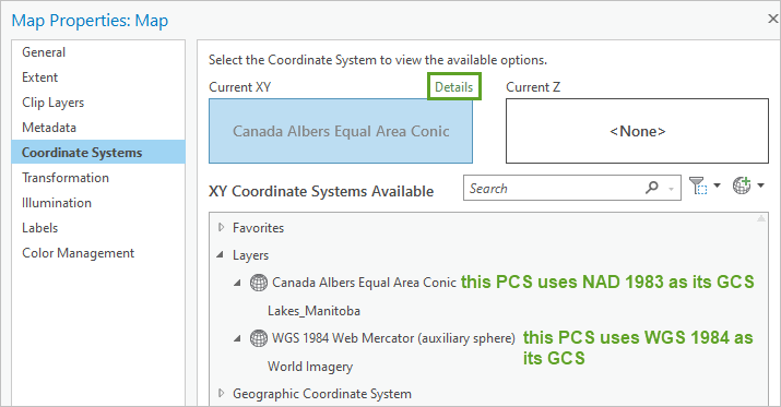

Why do the coordinate systems have different names in the Transformation tab and the Coordinate Systems tab?
Transformations only apply to geographic coordinate systems (GCS). The Transformation tab will only list GCS.
Transformation page with GCS highlighted
But in the Coordinate Systems tab you may also see projected coordinate systems (PCS). The secret is that every PCS contains a GCS. Click the Details link to find out what GCS is used inside a PCS.
Details link in the Coordinate Systems page
Transformations are only needed to convert between the GCS. If you have many layers all with different projections, but all with the same underlying GCS, you won’t need a transformation.
