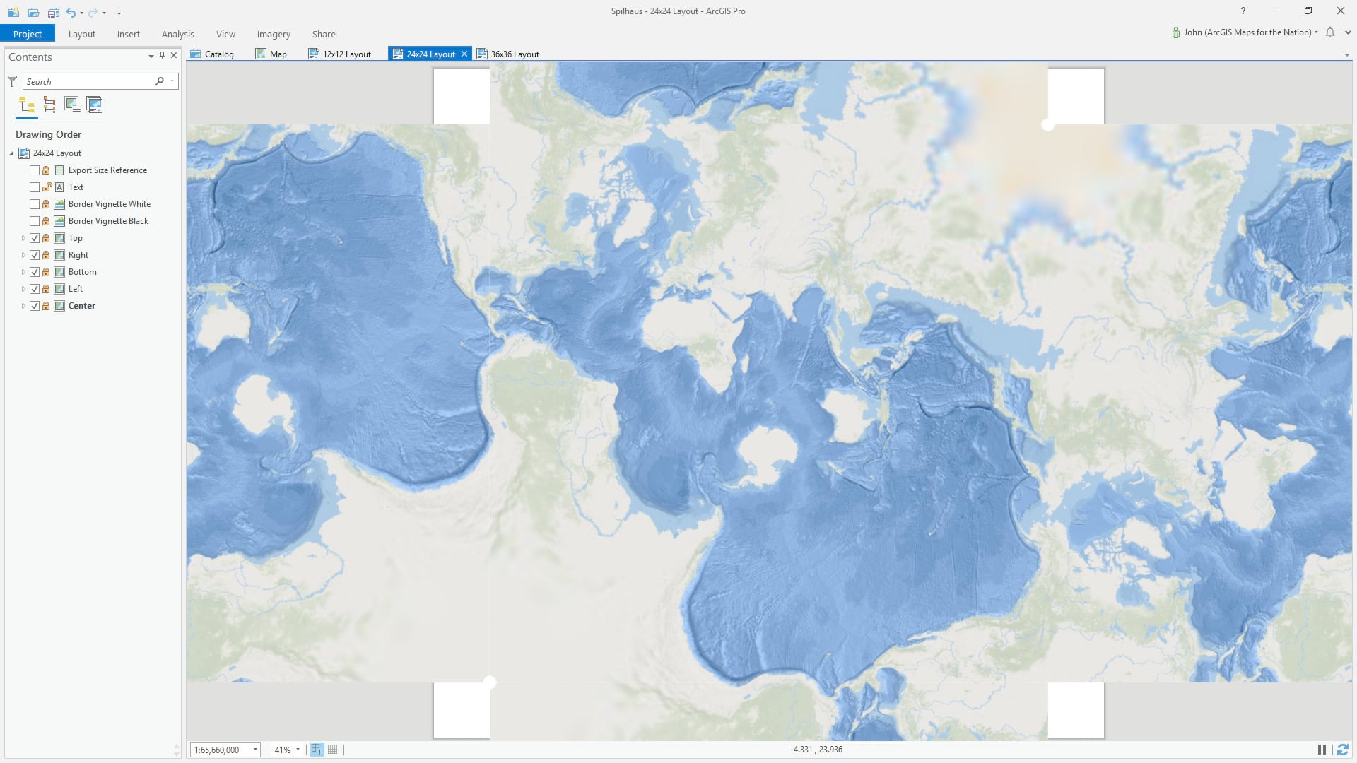

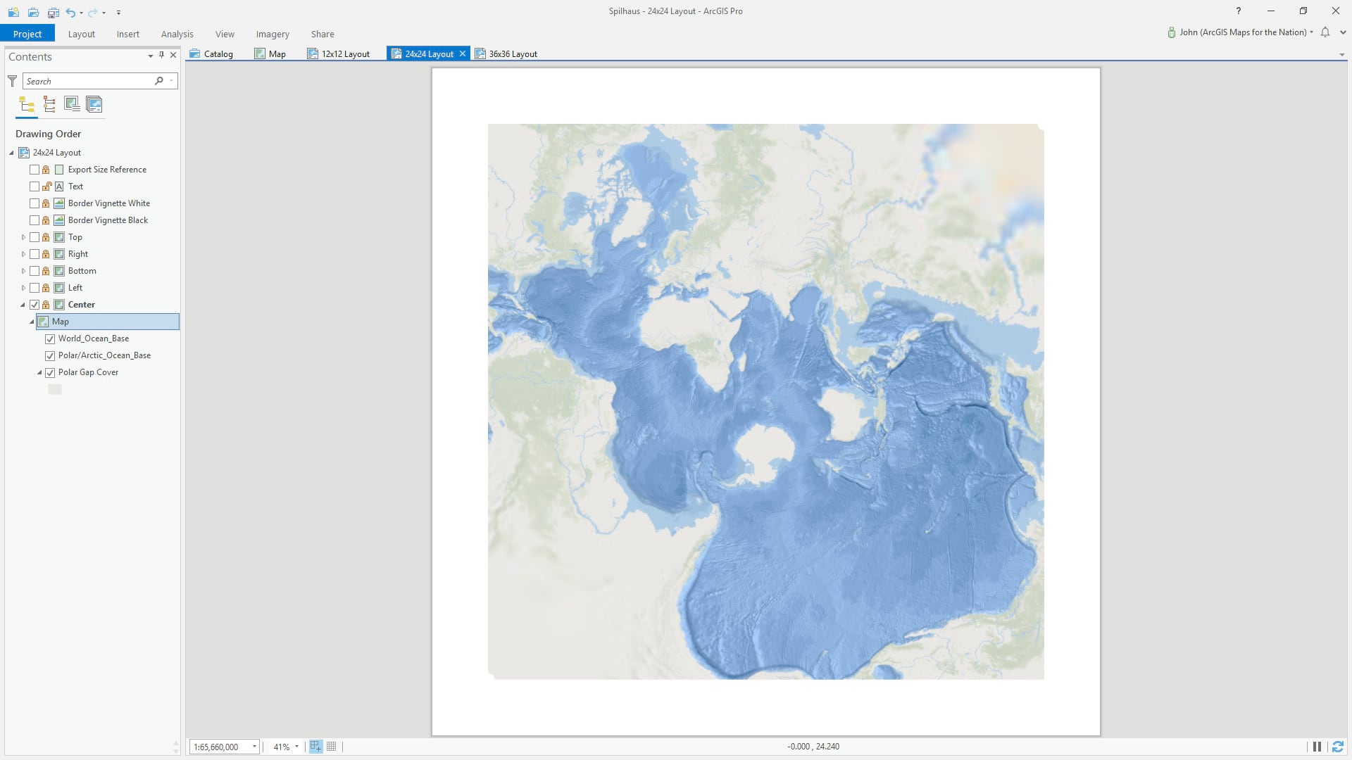

We made layouts that create an uninterrupted view of the oceans. Because repeating geography is a bit of a mathematical black hole in GIS, the Spilhaus map clips a bit of water at the perimeter in the Gulf of Mexico and the Bering Straits.
But in a layout, you can repeat a map as many times as you like, and also rotate them. So now we have an uninterrupted layout (with some helpfully-redundant bits of peripheral ocean).

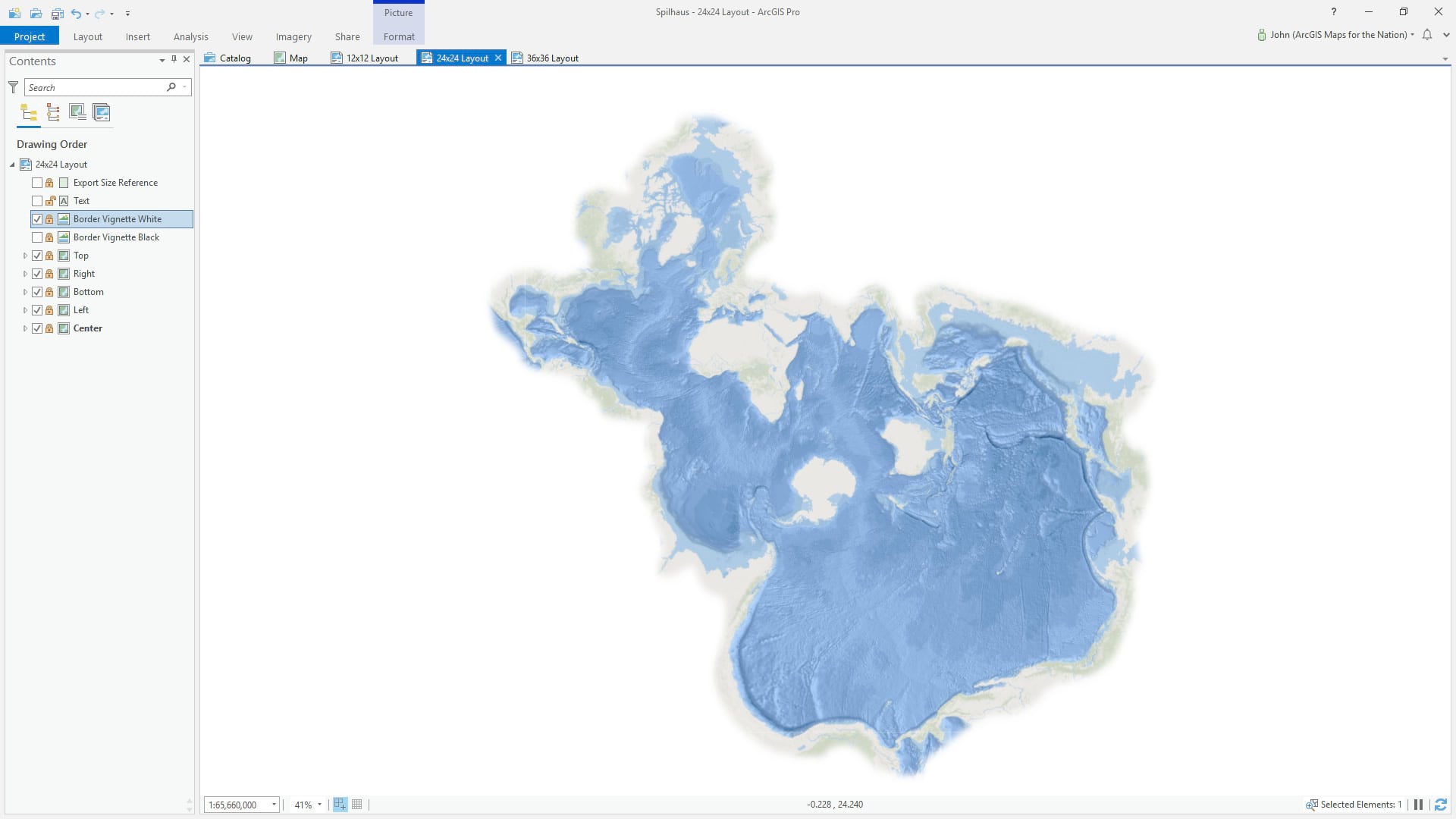

Gosh, look at that mess, though. Time to clean it up with a handy overlay graphic that helpfully occludes the land and overly-duplicate portions so we get a single glorious look at the one world ocean.

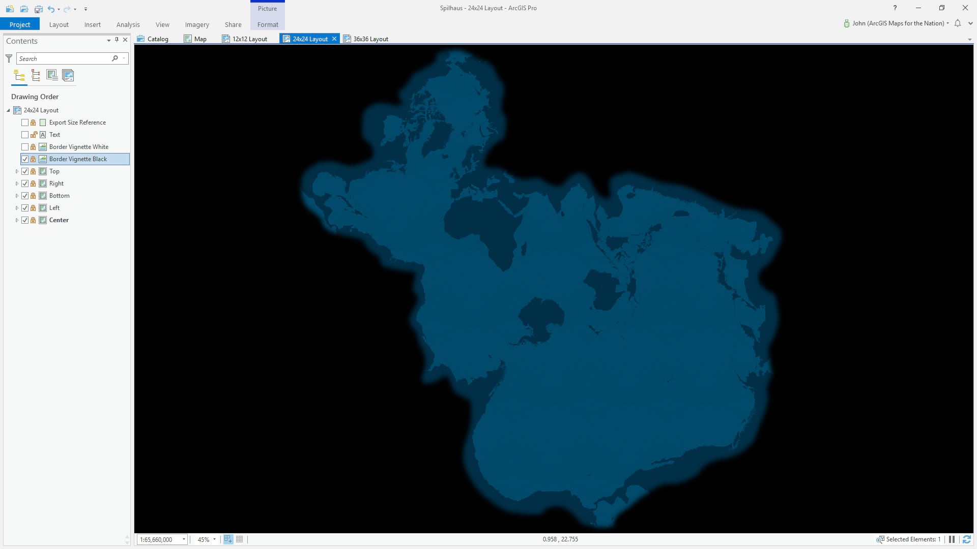

And you’ll notice in the project there is an alternative vignette overlay graphic in black, if that matches your map styling better.
