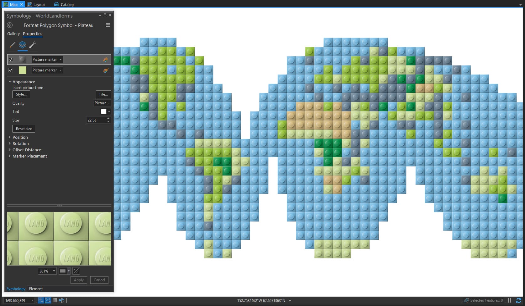

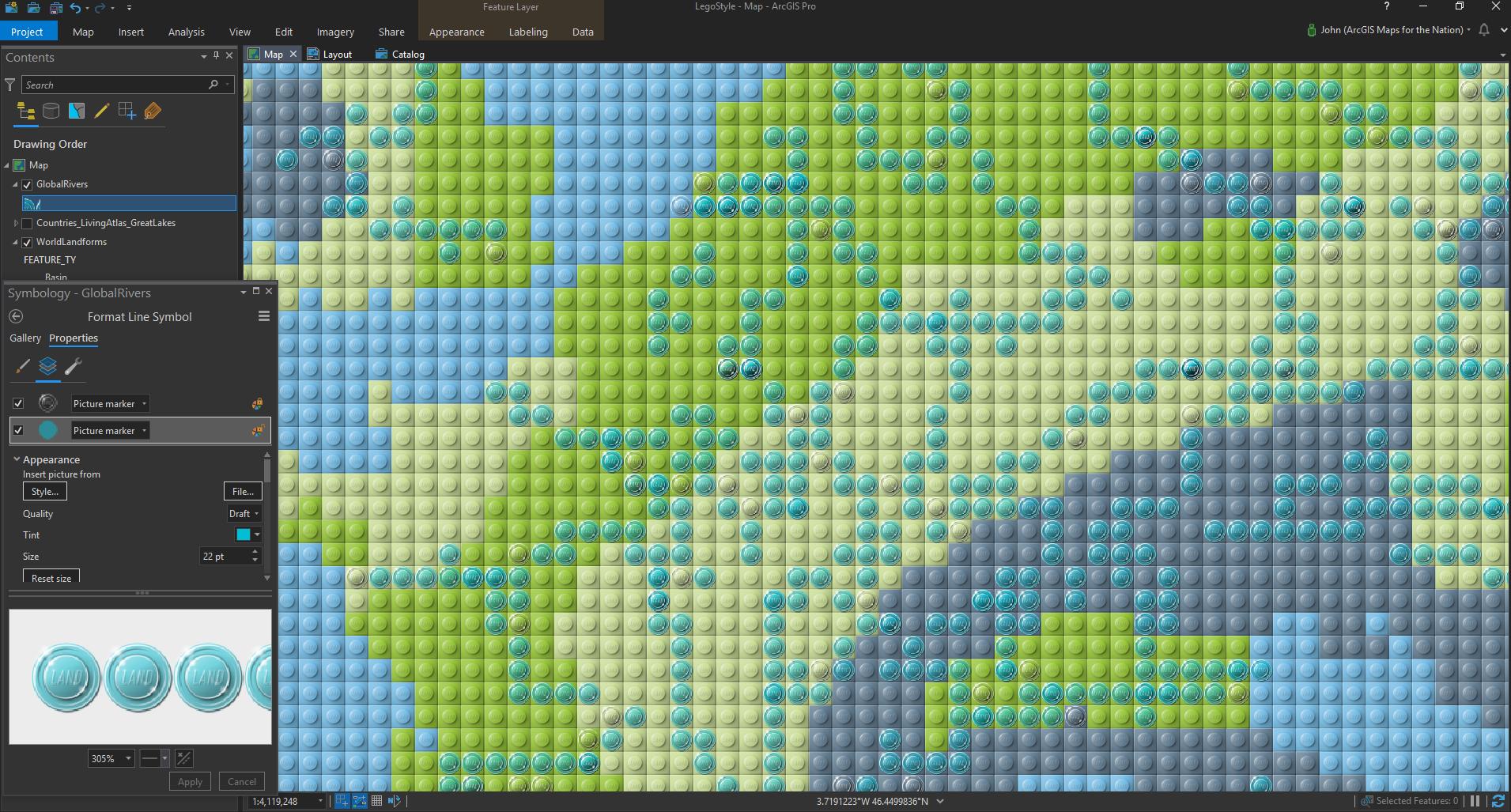

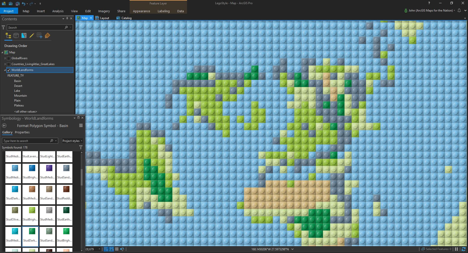

The technique is based mainly on these two sneaky texture overlays I made. They sit atop a dynamically colorable background element so you can use the symbology panel to apply any and all sorts of colors and color ranges to your bricks.

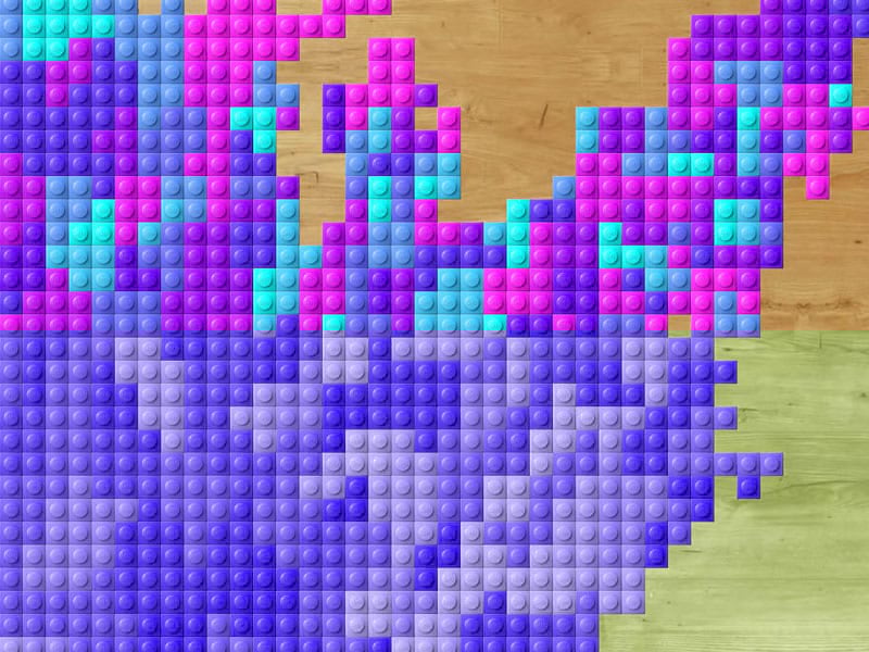

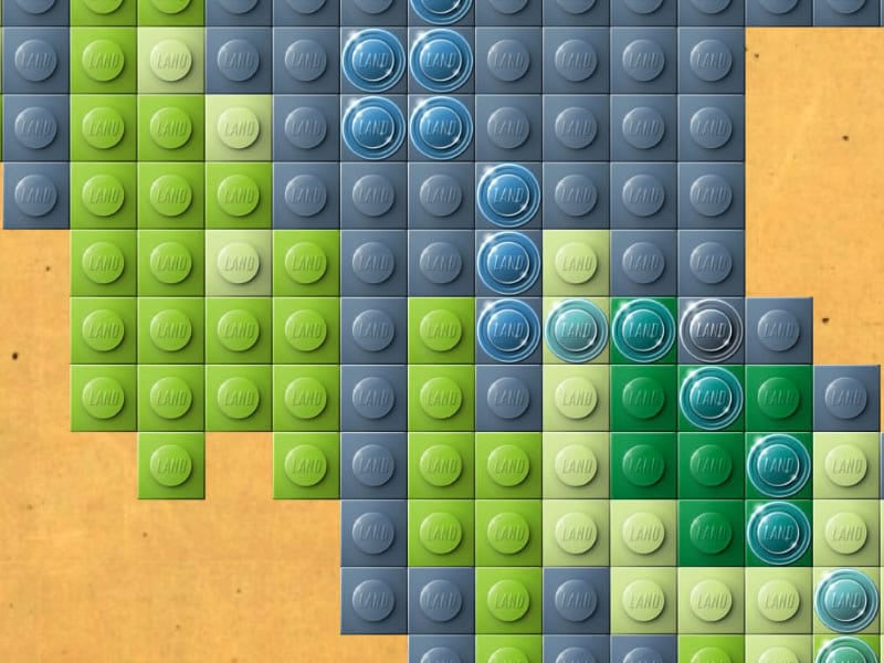

And since you need a nice solid surface to do your building on, I’ve also included some background textures that you can apply to your Layout background, or to this Global Background layer. You can build on a wood table top, Formica, a table cloth, or craft paper, or choose the classic bright green base plate. There is no wrong choice.
