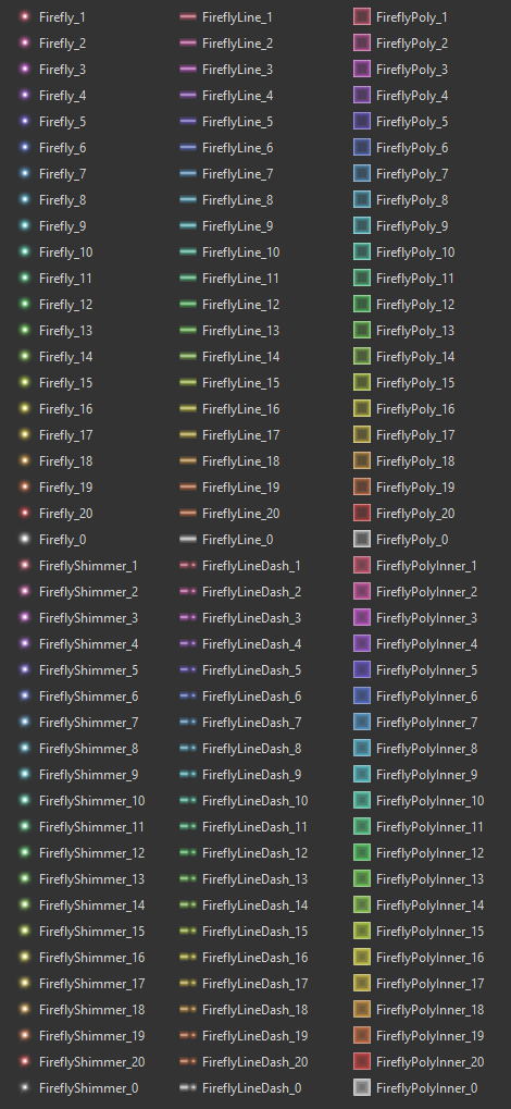

The Firefly style consists of the following point, line, and polygon symbols, packaged up for your adventures in ArcGIS Pro…

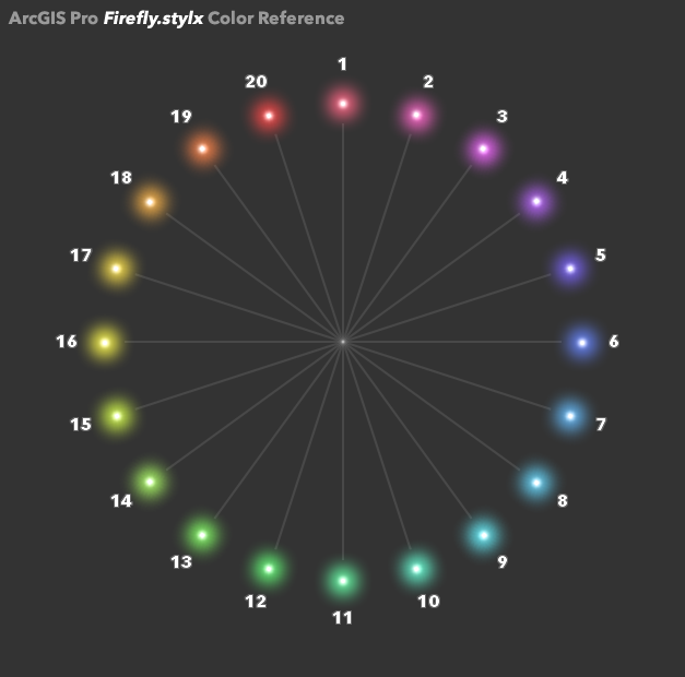

There are 20 pre-defined colors available for each symbol (but there is no reason you can’t tweak them for whatever visualization scheme you cook up). Here is a reference of their numbering…

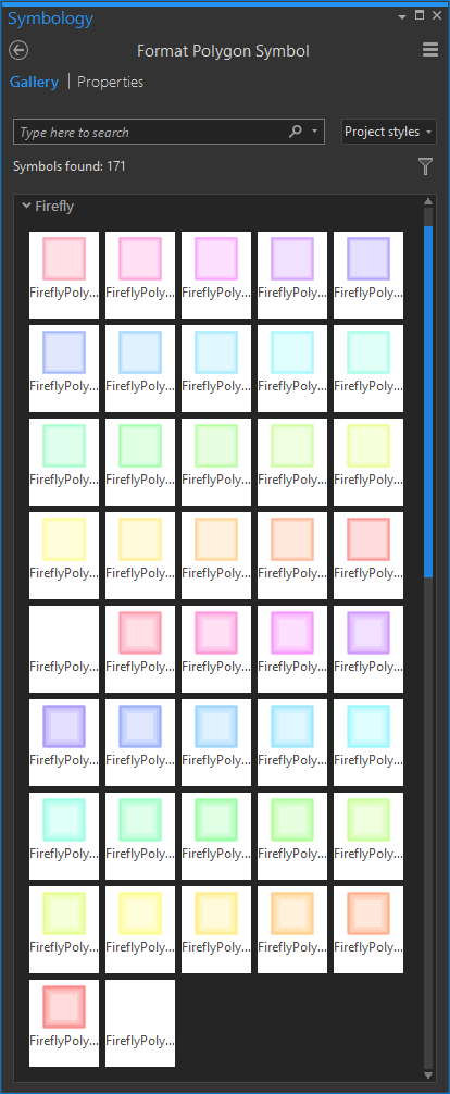

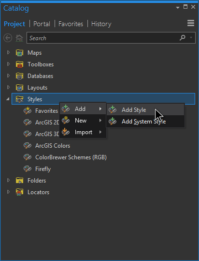

To add these to your Pro project, first download the Firefly.stylx file and save it to your machine. From your project’s Catalog panel, right-click the Styles category and choose to add a style.
Point it to your Firefly.stylx file and you are good to go. Thereafter, the firefly styles will be available in the project via the Symbology panel’s Gallery.

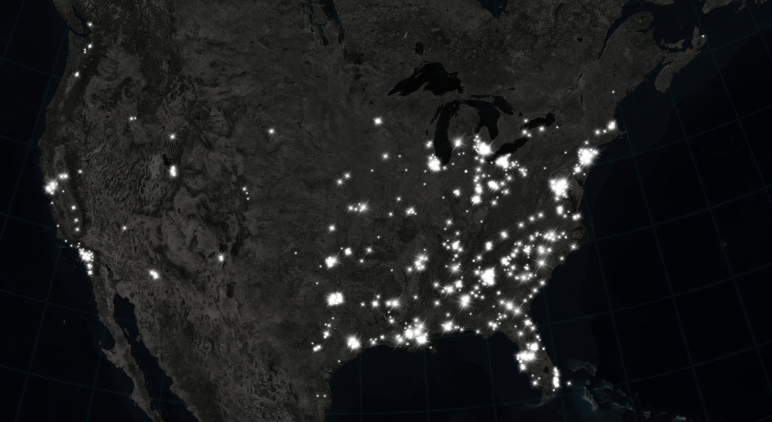

Here’s a look at the standard Firefly point symbol, in this case showing, obviously, Taco Bell locations scaled by revenue…

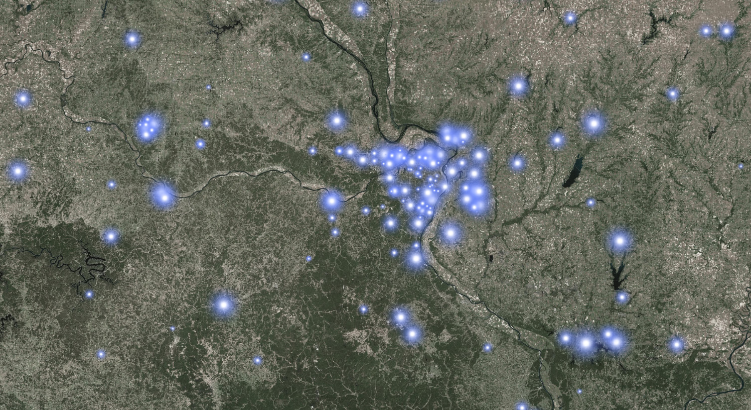

But sometimes you want to turn your Firefly point features up to eleven. I’ve got you covered. There is an alternative version with a twinkly lens flare shimmer sort of thing going on. Like in this map of luminescent earthquakes…

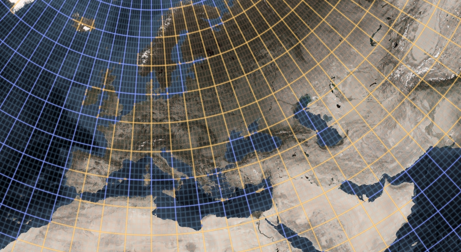

Firefly has two line styles. But, again, you can totally play with the Symbol settings to teach it whatever tricks you need. Here is the standard, solid, line illustrated in this map of glowtastic graticules…

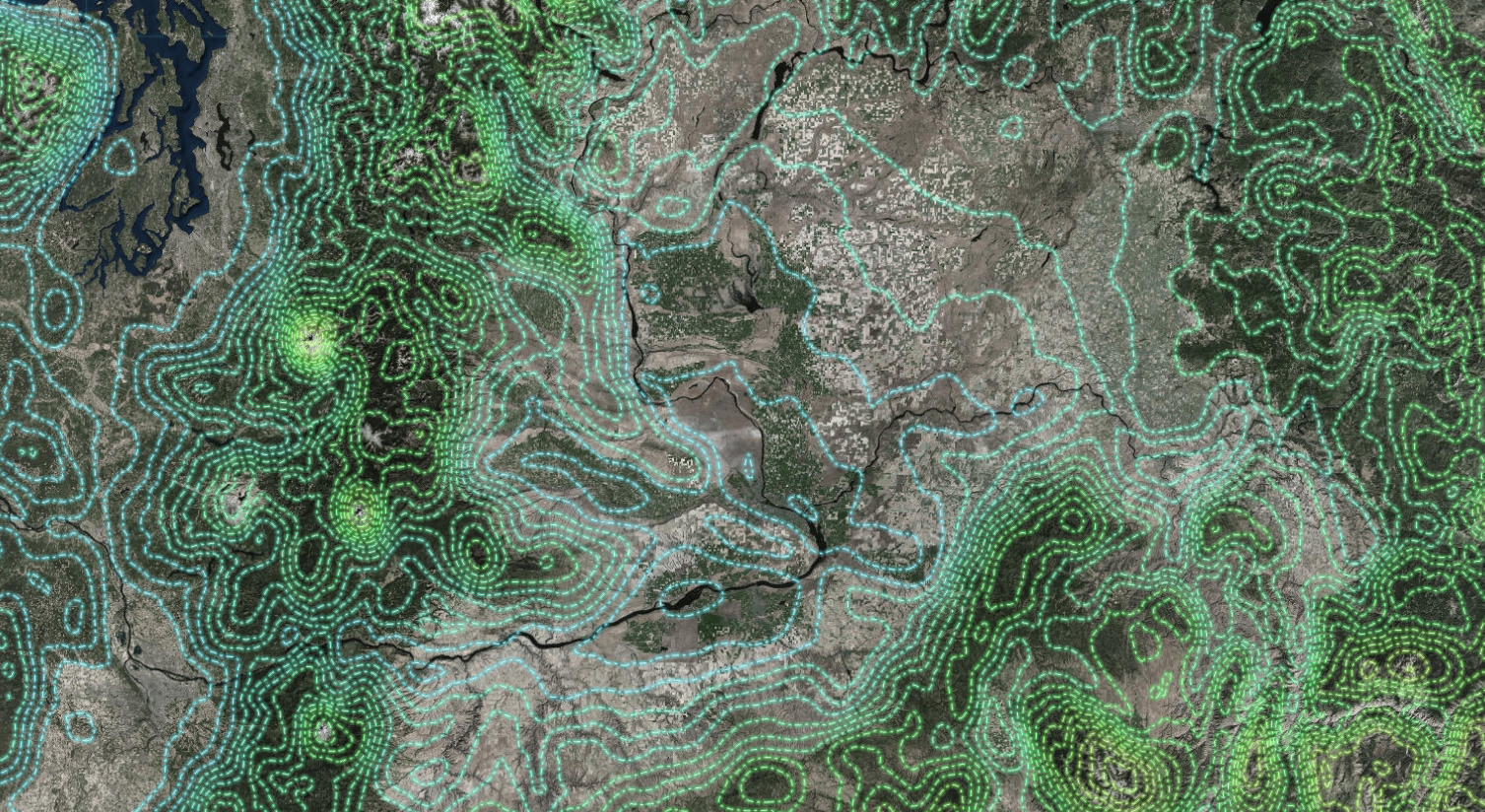

But sometimes you just need a dashed line. So here is an example of the dashed Firefly line style applied to contour lines in the Pacific Northwest…

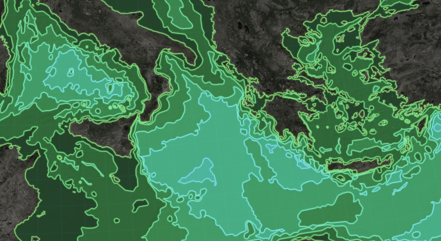

Here is a look at the Firefly polygon style. It is a glowing boundary with a faint fill, applied to these Mediterranean bathymetric zones, submitted for your approval…

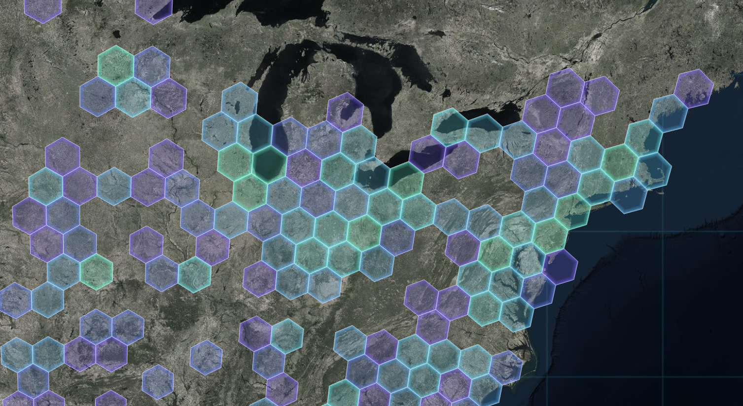

But when you have adjacent polygons, which is often the case with human geography data, the glowing edges of the Firefly polygons can bleed into, or overlap, each other and sort of make a mess. So here is an alternate version of the polygon fill with only an inner glow, as evidenced by these hexbins of aggregated Chipotle locations…
