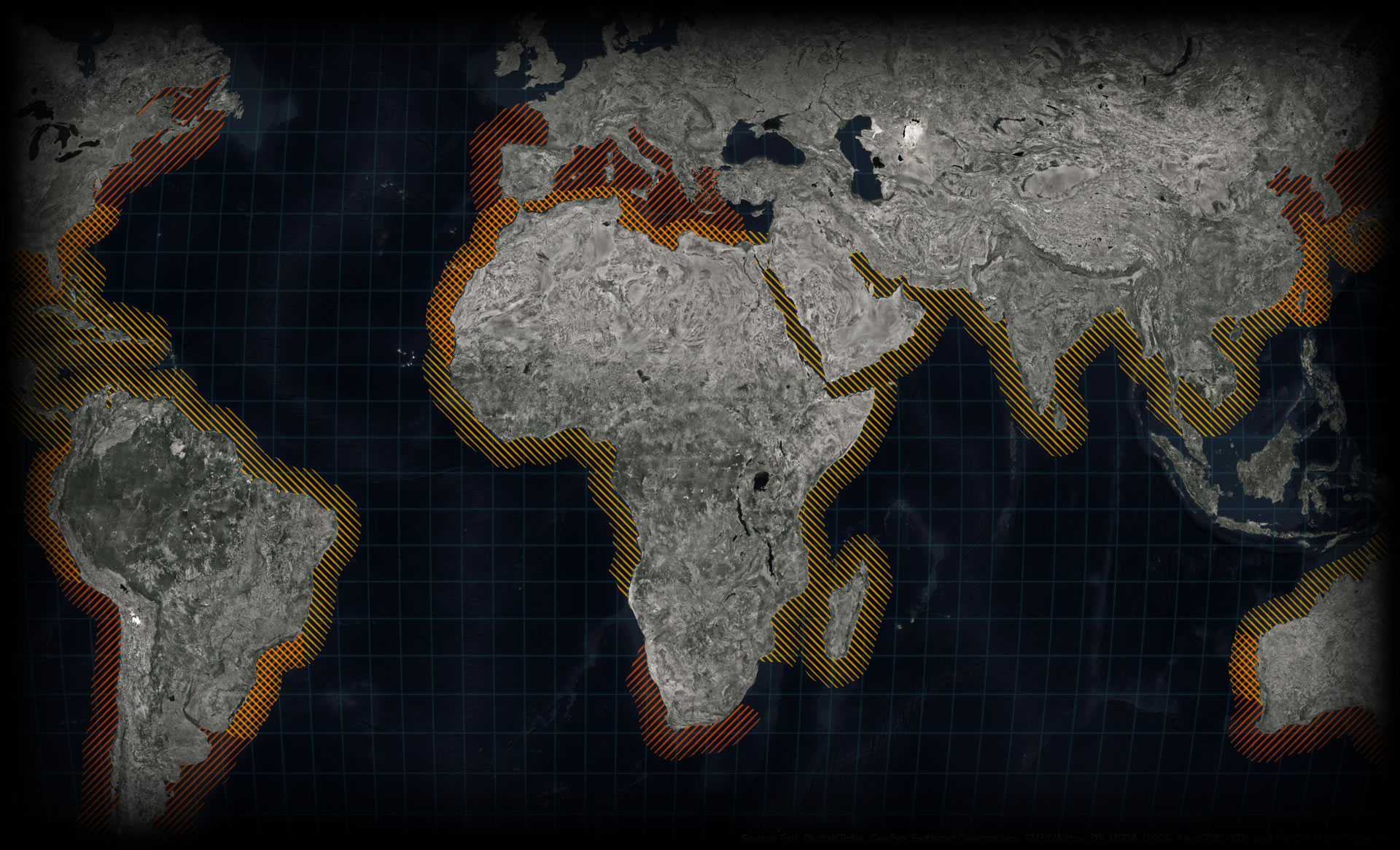

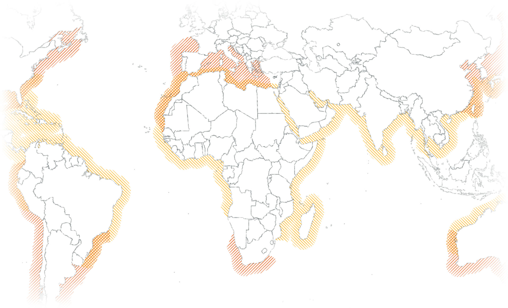

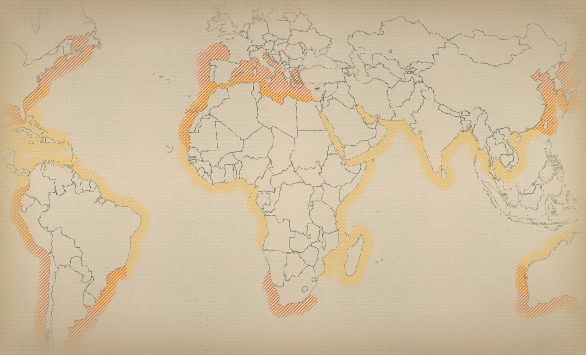

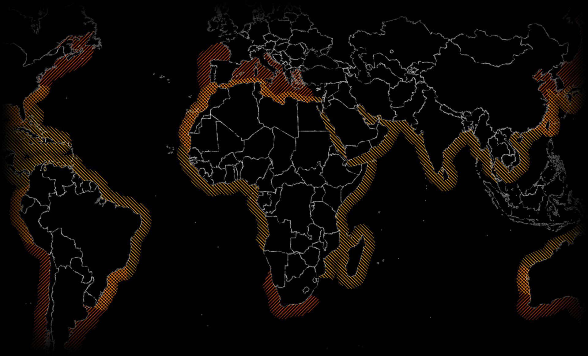

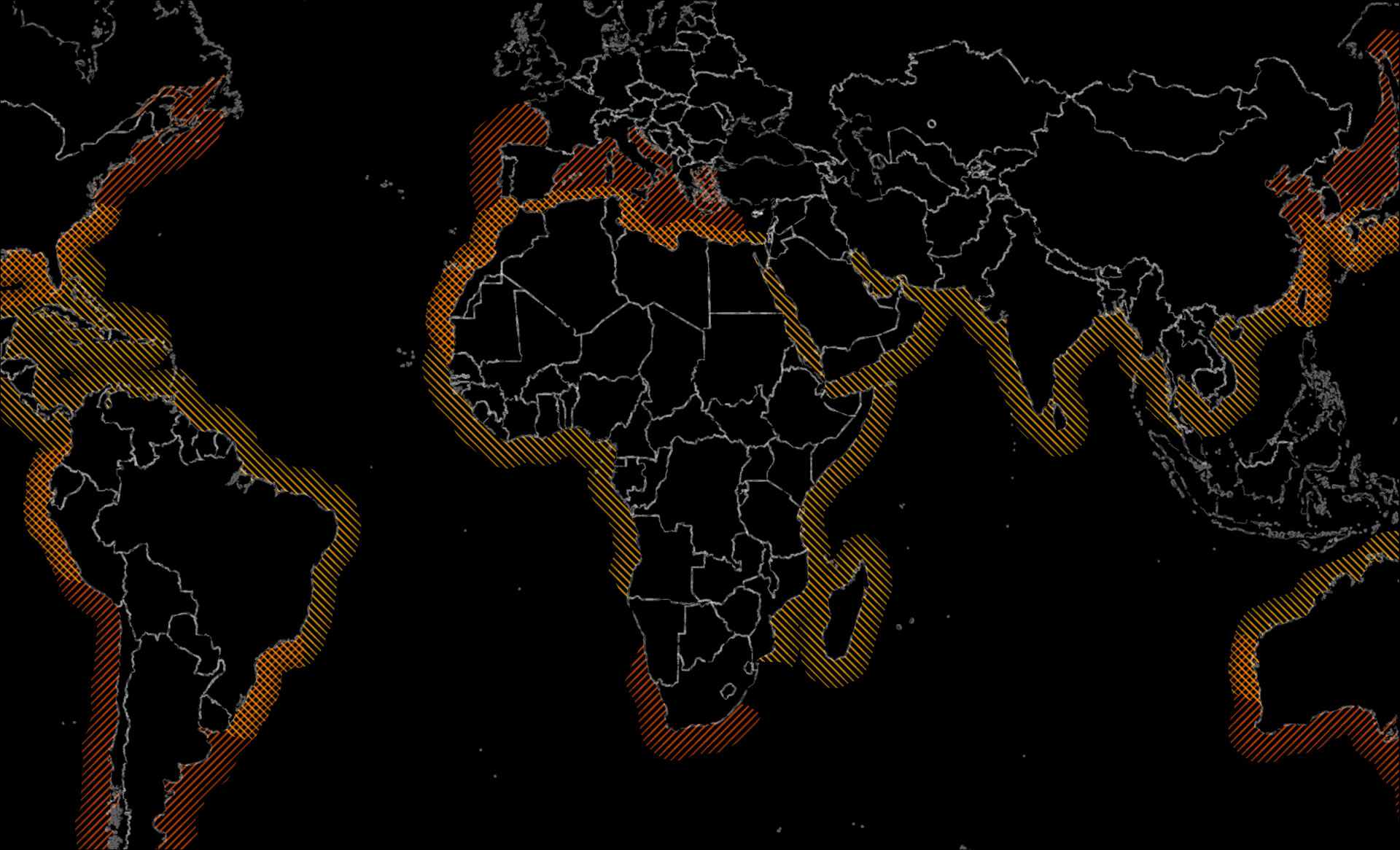

Here is a map showing the overlapping habitats of Great White and Great Hammerhead sharks (derived from this important work), focused on the waters around and about Africa. I’ve made it in both white and black…
The map edges end pretty abruptly. I could include a neatline with a margin. Or, I could add a vignette to feather the perimeter of this map…

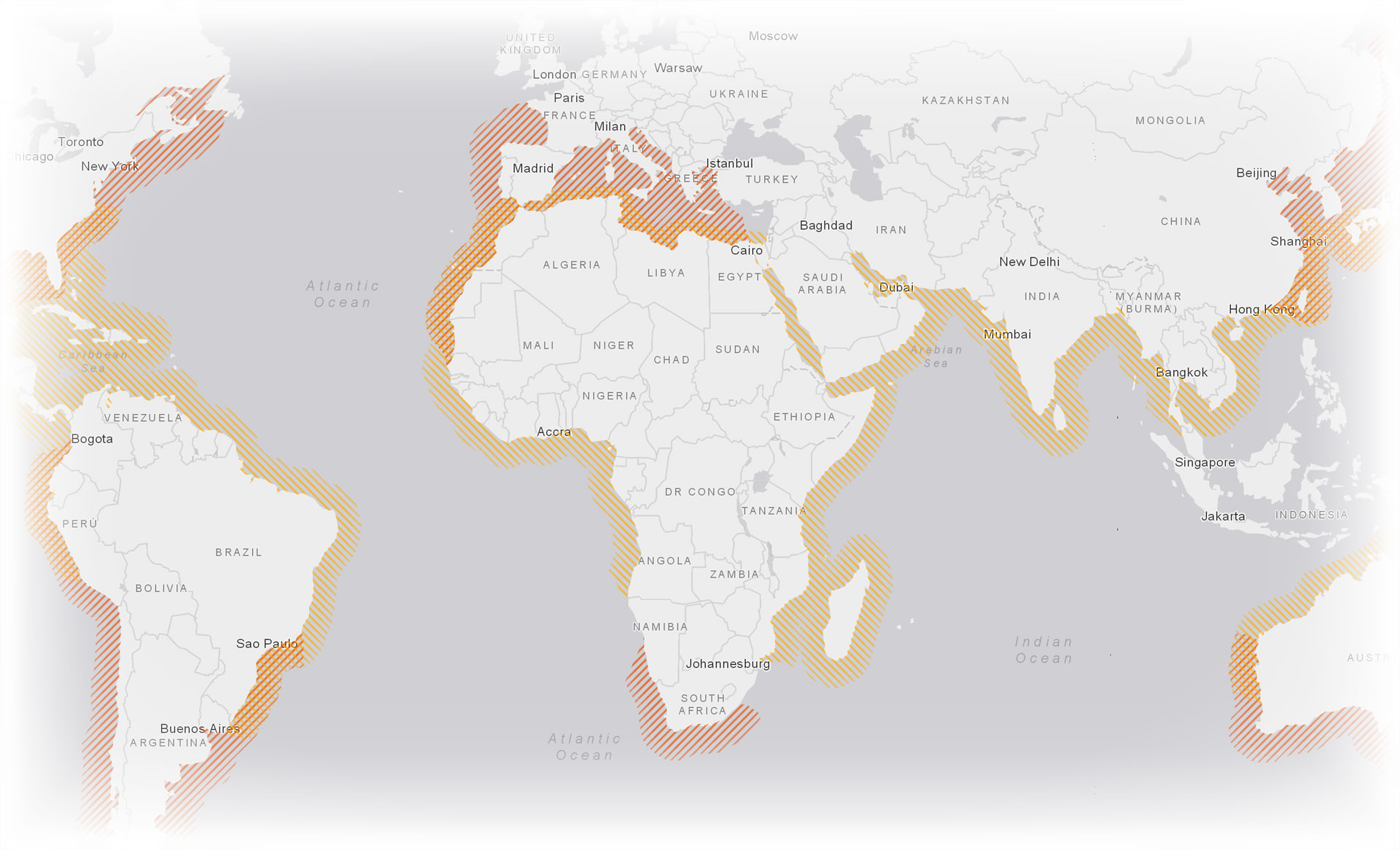

Or, if your maps are just generally light or dark, you can still use them. Here are the vignette images used atop the Light Gray Canvas basemap and the Firefly basemap.

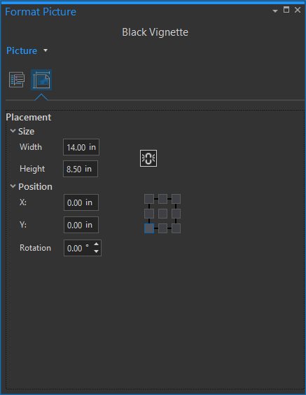

In ArcGIS Pro, you can insert a picture into a Layout and position it above or behind a Map frame.
You can download these white and black vignette image resources here.
In the examples, above, I added a (white or black) vignette image on top of the map. I stretched the image to match the size of the Layout. Note, you’ll have to unlock the aspect ratio so you can stretch the width and height independently to fit your layout.

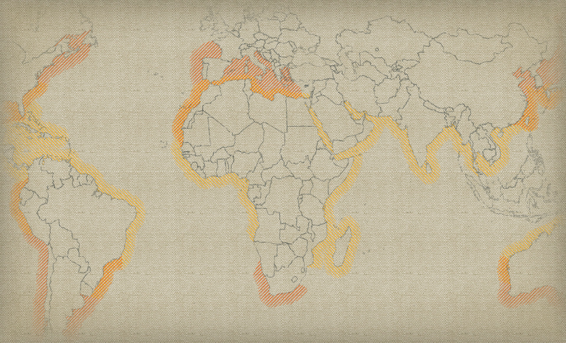

I’m glad you asked. There is no reason that your vignette images have to be boring white or black. Or any solid color. I, for some reason, like to make maps that appear to be hand drawn on physical surfaces. Did you ever notice how on old maps the ancient cartographer scraped fewer features onto the parchment when they got close to the edges? Or even how people drawing on chalkboards avoid the edges? Well I do. This tapering off of content at the edges has some of the cognitive benefits of vignetting, but it also happens to be a fun layout hack!

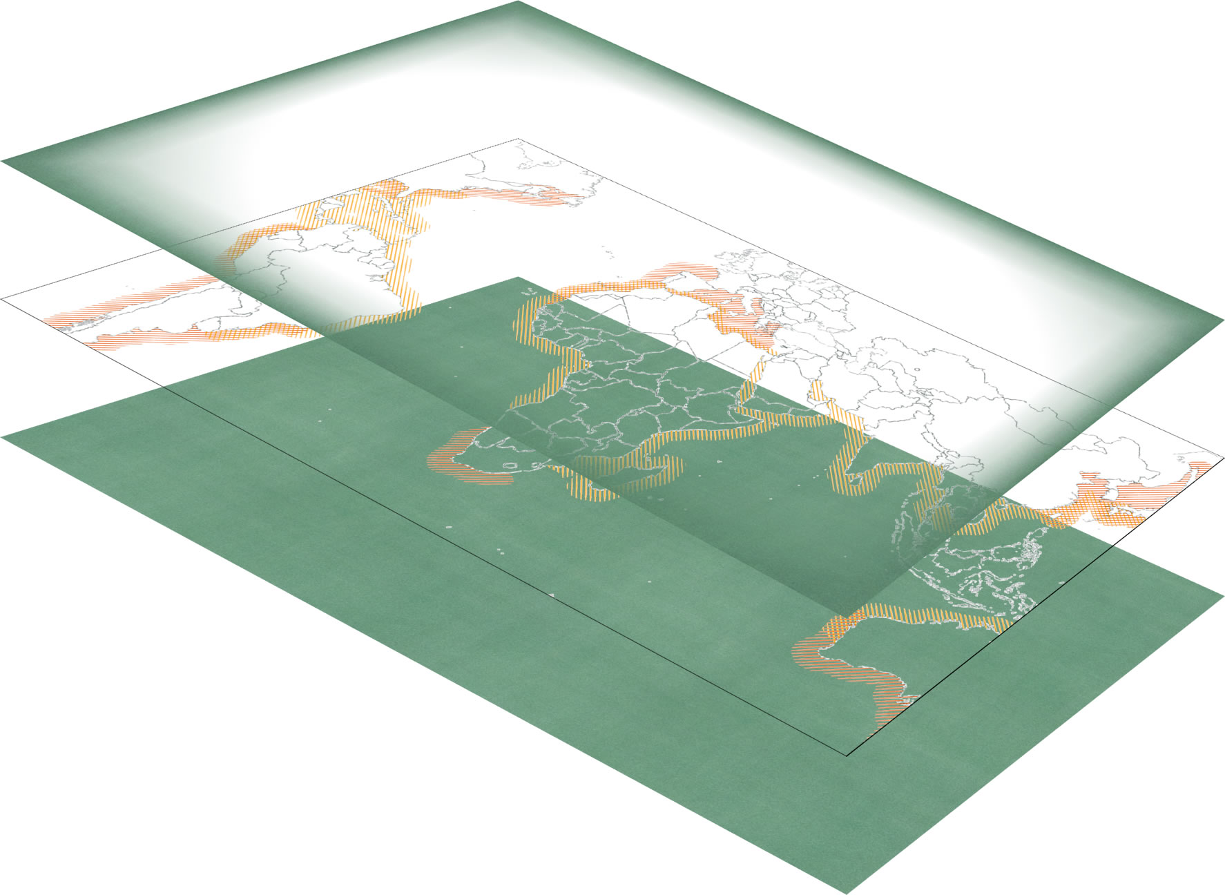

Wait a second! How do you get a vignette to match a textured background?? You make a map sandwich…
The ingredients, in the Layout, are…
I’ve gone ahead and created a handful of texture images for you (both the base image and the vignette image) and put them on the internet so you can use them with impunity…
Download a pile of textured vignettes.

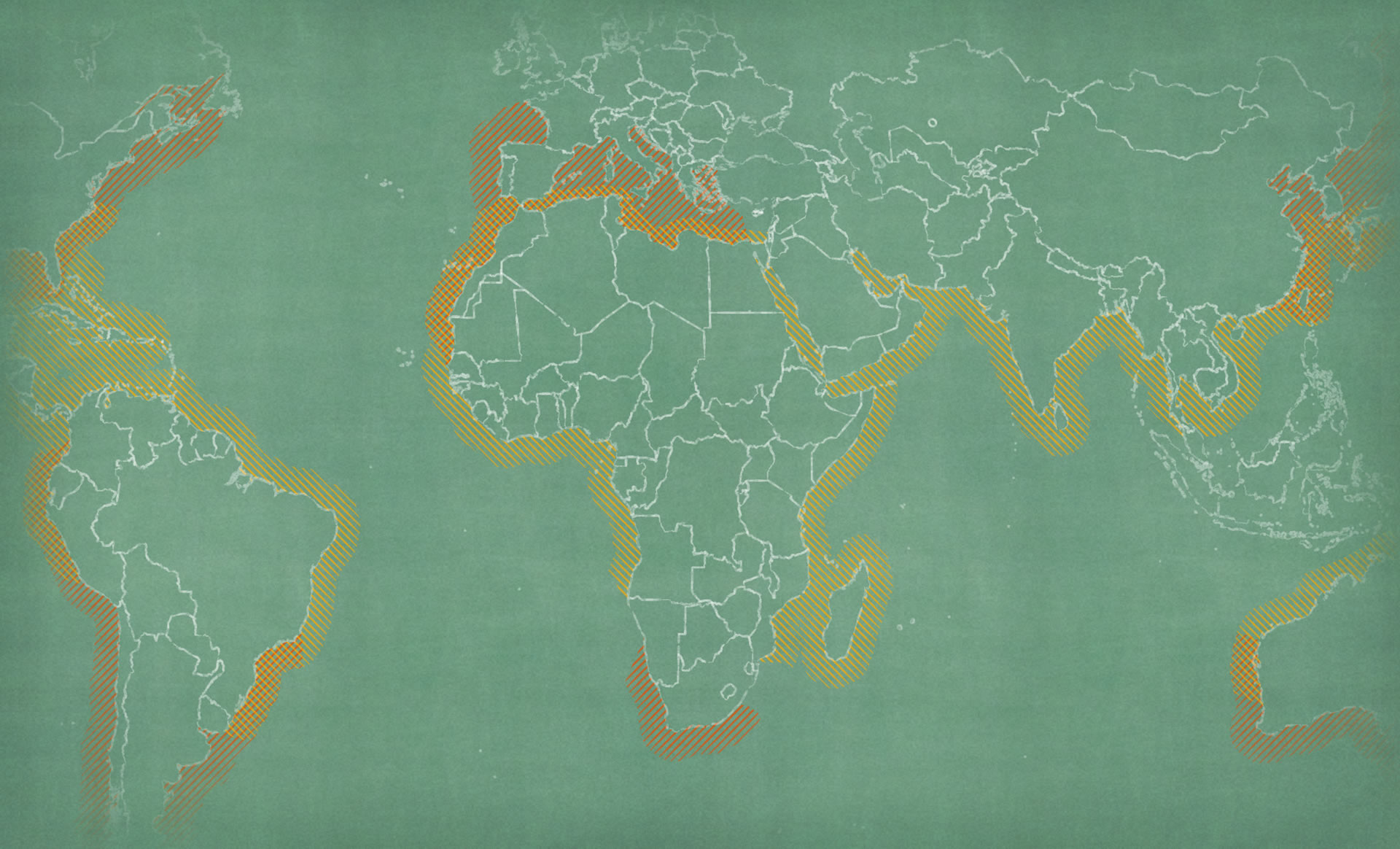

Here’s how they look with my shark map…

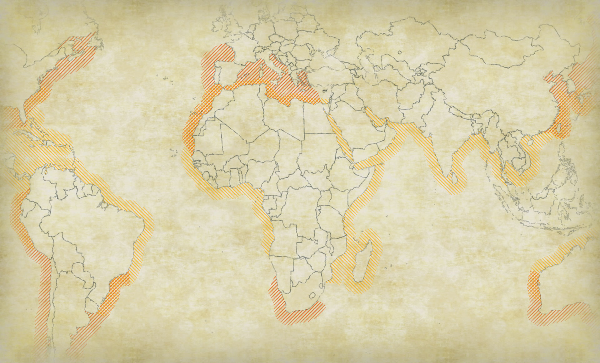

Ohhh, look at that. It’s almost like a tool a picture of a blank page of my dad’s 1970’s book club copy of Thoreau’s Walden with my phone and then used it as the map’s background and vignette texture!

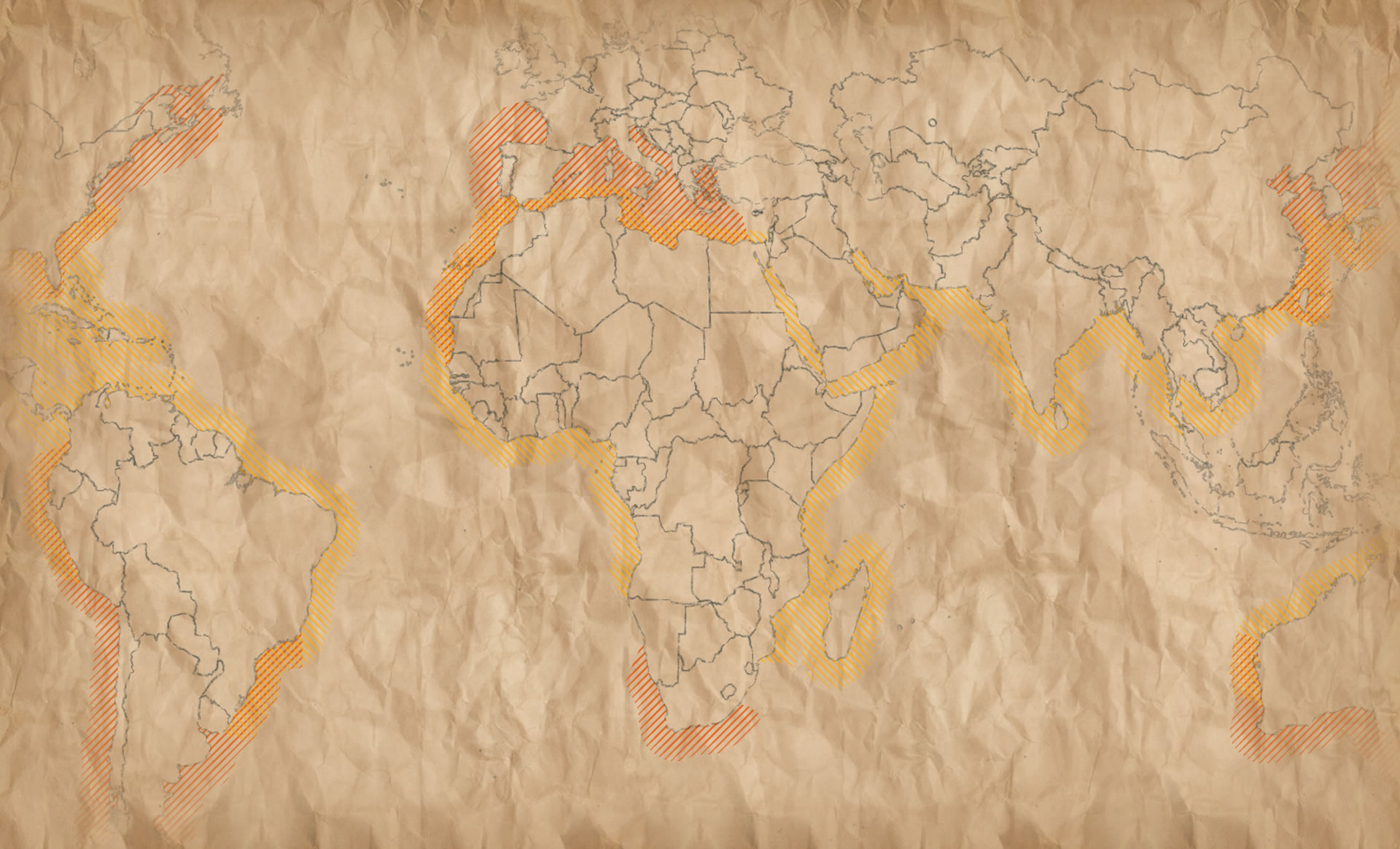

Hey, how about a map scratched onto a canvas?
Or scribbled onto a paper bag?
