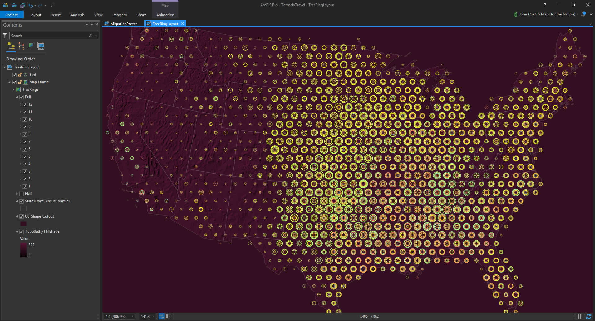

Here is a map layout of seasonal tornadoes, symbolized as stacks of graduated symbols atop a dark topographic hillshade basemap.
![](https://www.esri.com/arcgis-blog/wp-content/uploads/2019/03/1ProLayout.jpg)

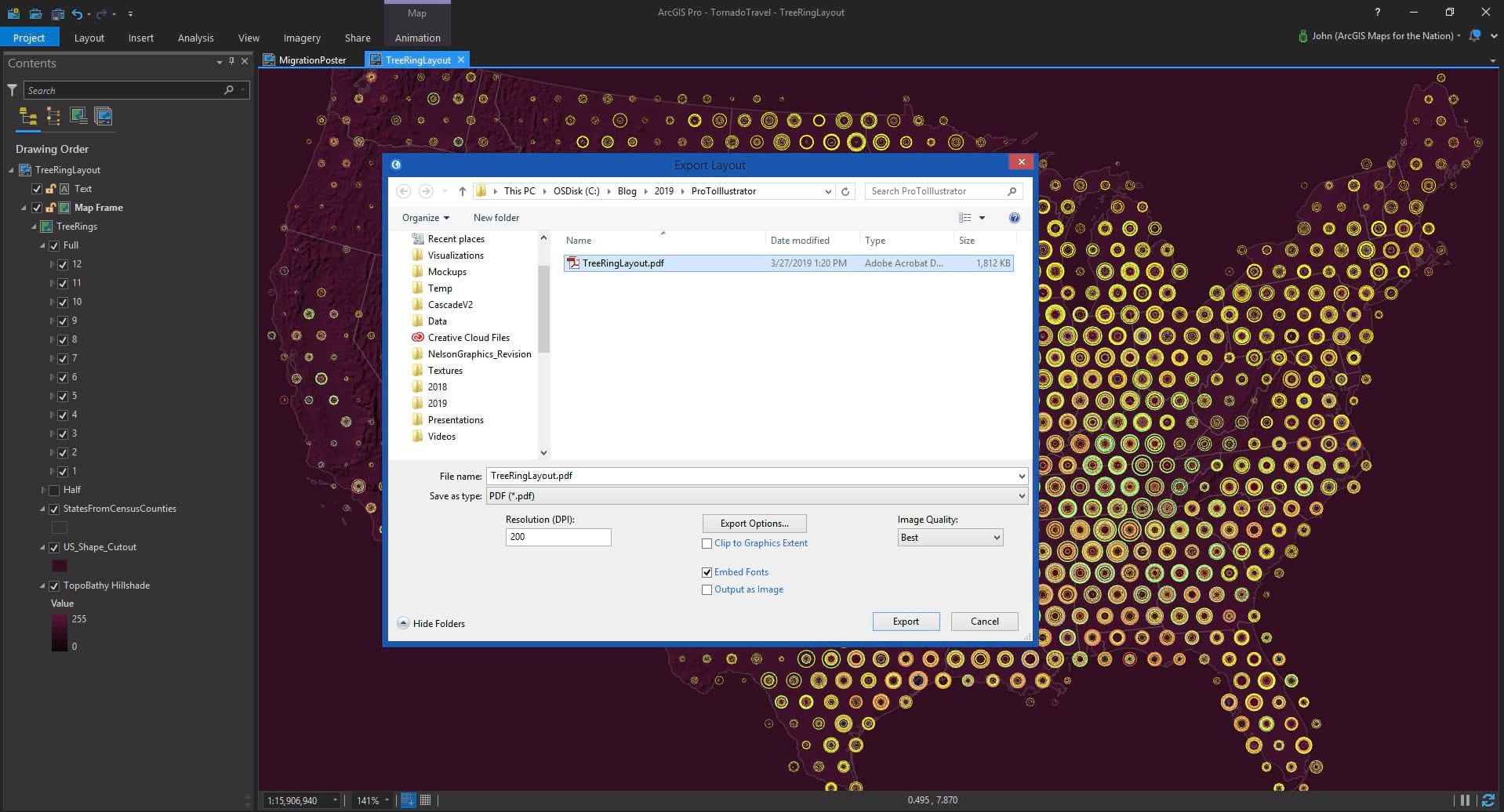

2 Export as PDF
In the share tab, there are a host of data formats available to export as. Choose PDF.
Any raster elements will be baked into the PDF as image layers, but vector layers will remain vectors. And text is honored, too, retaining the font and style.
If vector content has a style that Pro supports but isn’t supported natively in the PDF spec, it gets baked as a raster. But only if it has to.
Why no AI export option in Pro? Adobe closed the AI spec some years ago, so developing in the dark would be a dangerous game. But I’ve had nothing but success with this PDF route.
![](https://www.esri.com/arcgis-blog/wp-content/uploads/2019/03/2ExportPDF.jpg)

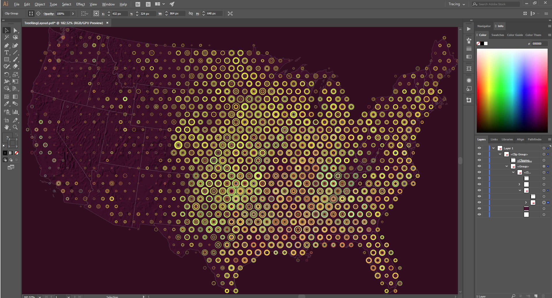

3 Open the PDF in Illustrator and Go Nuts
The PDF should look pretty solid in Illustrator. In my experience, the first order of business is to open up the layers list and dig deeeeep to find the actual content within the nested clipping masks. But I just drag them up out of the nest and tidy them up to whatever degree suits the task.
![](https://www.esri.com/arcgis-blog/wp-content/uploads/2019/03/3CleanLayersInIlly.jpg)

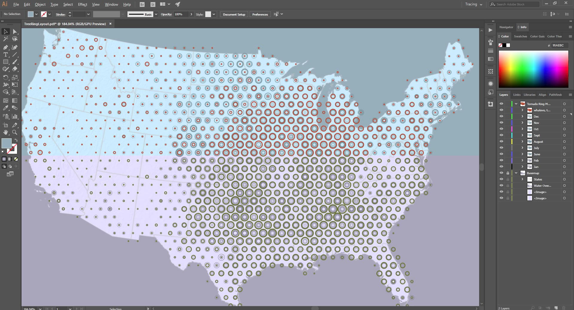

And since it’s now a living breathing Illustrator document you can do whatever it is that you want to do in Illustrator. Sometimes I use Illustrator do draw wacky legends or layer up indulgent graphic filters or assemble accompanying info graphics or do trippy things with titles or labels.
![](https://www.esri.com/arcgis-blog/wp-content/uploads/2019/03/4IllustratorWork.jpg)
