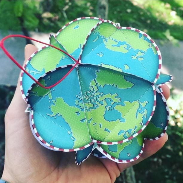

Here is a template (4MB zip file) with all the graphics and instructions you’ll need to be cranking out your own dazzling little yultide orbs. Get ready to live.
Step 1. Cut out all 20 little maps (tip, there are 4 PDF pages, you can stack the North Pole / Lower Latitudes and the South Pole / Upper Latitudes pages and save half the cutting).
Step 2. Crimp along the dotted lines and start assembling the little suckers. There are little letter guides to help you with the assembly (you think it’s be easy, but I tell you, you’ll be thankful for them; by the way, adding these letters was easily the most mind-bending part of building this template). Glue sticks or staplers have worked for me. It will get pretty crazy at the end, but you are a geographer and you’ll push through that. Nothing of value comes without some sort of effort.
Step 3. Enjoy. Make them with your kids. Give them to your friends. Geography is its own gift, so imagine the force-multiplying potential of these things. Hang them wherever you see fit, which is anywhere you please. Also, don’t forget to tack in a loop before it’s all closed up.

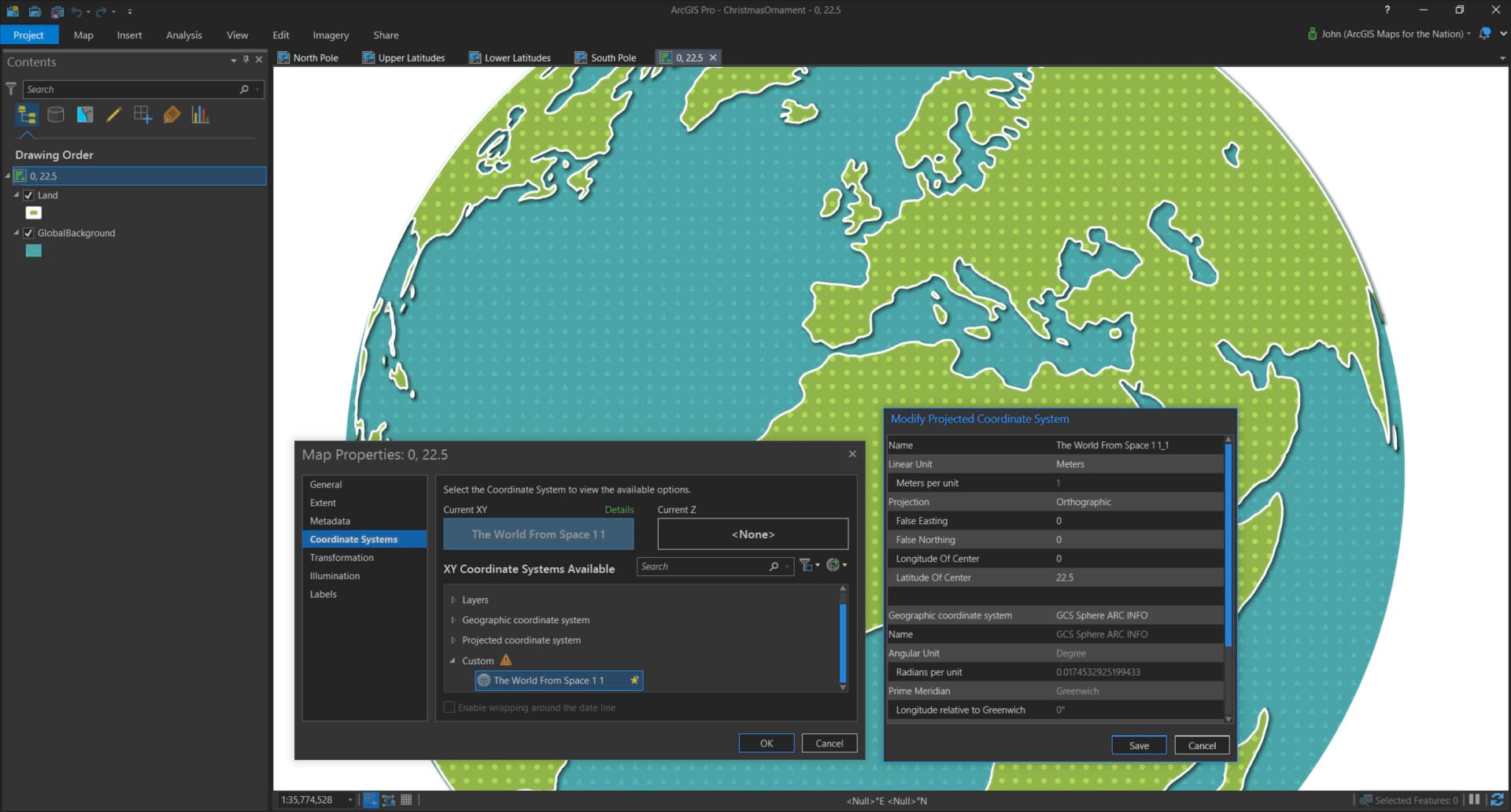

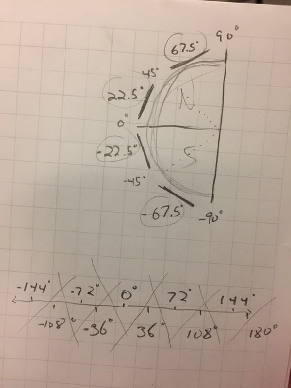

I first had to figure out all the orientations of my 20 map frames so they tessellate reasonably well over the geodesic sphere. This took some scratching.
Then I chose some symbology that looked reasonably Christmasy. The global land areas were drawn by Dylan Moriarty, available at Project Linework. I used a gradient line to give a shadow effect, and a wrapping-paper-like pattern via a regularly placed marker symbol.
The projection is an orthographic view (The World From Space, one of my very favorites), tweaked for each of the 20 separate maps to center over the right coordinate.

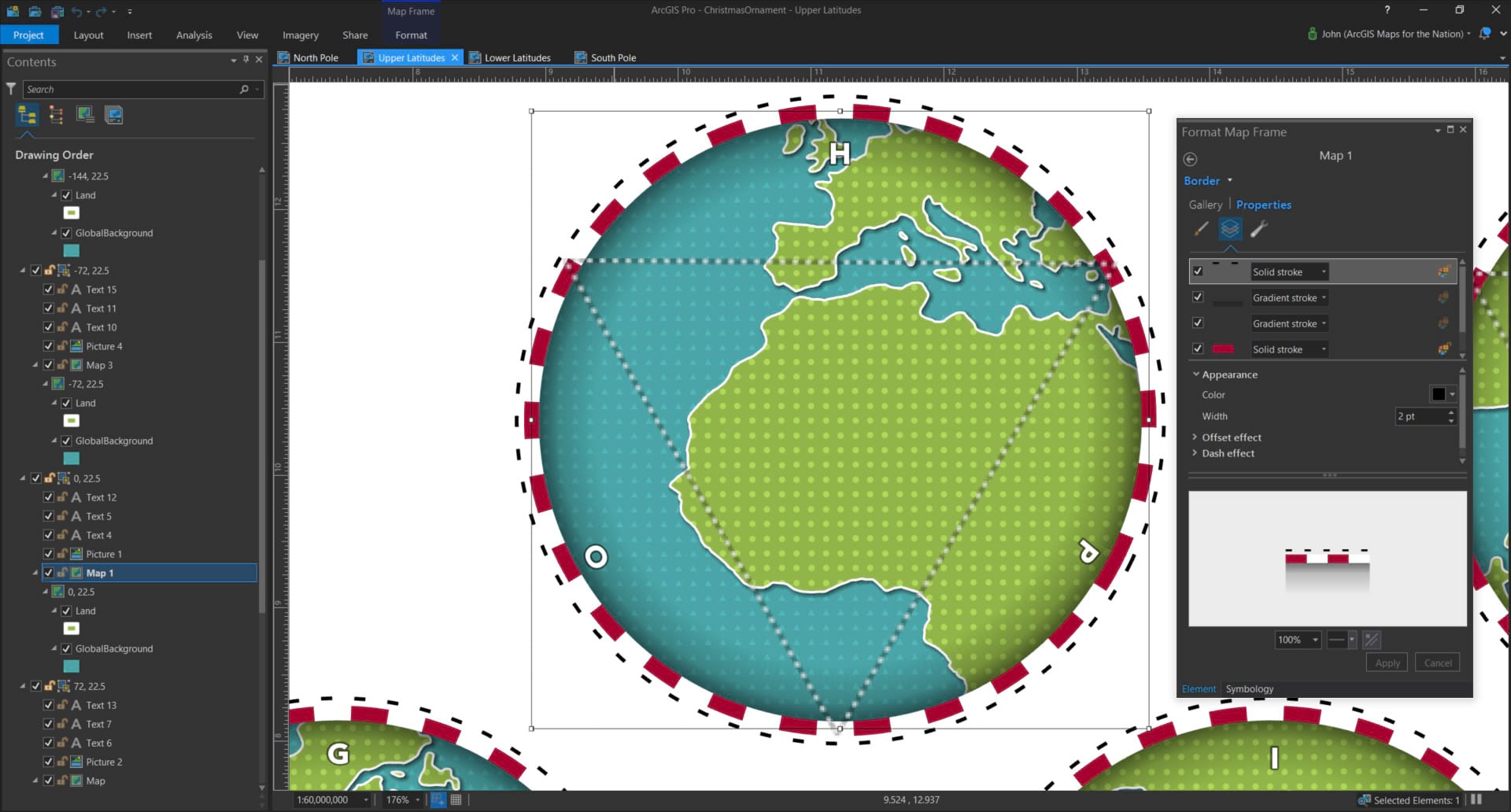

I brought the map frame into the layout and changed the shape to circular.
I gave the map frame’s border some over the top Christmas themed styling. Once it looked the way I wanted, I copy/pasted it for the 19 other little maps and then changed which map each frame held. Does that make sense?
