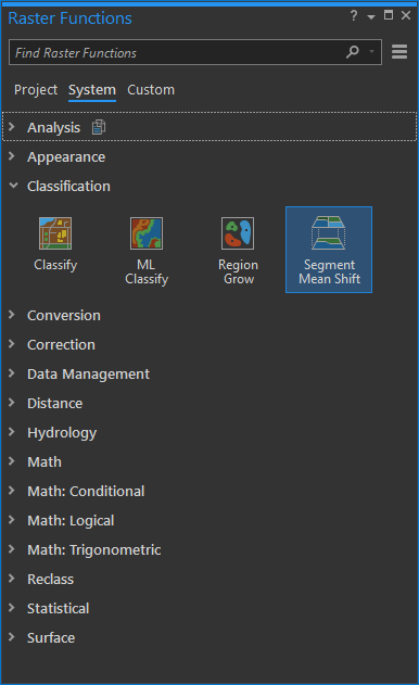

There’s a curiously named Raster Function in ArcGIS Pro has you covered. Segment Mean Shift lets you posterize images and image services (not tiles). So long as you are willing to wield it well outside of its built analytical purpose.

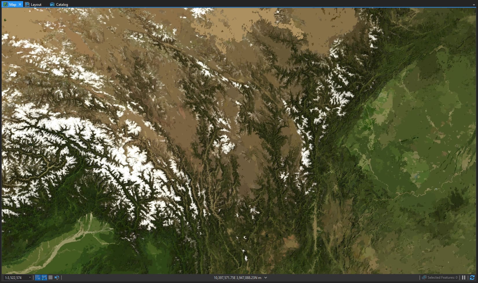

Here’s a look at the eastern portion of the Tibetan Plateau, where the Himalayas spill down into the Mekong and Yangtze headwaters. It’s a beautiful image (I downloaded it from the NASA Visible Earth site).

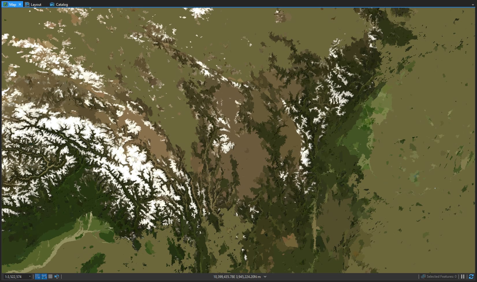

There are only three parameters. Spectral and spatial detail (a range from 1, really smooth, to 20, really fine) and segment size (how small should the pixel clusters be). Here’s a pass at moderate detail and a minimum cluster size of 20 pixels.
Which paints for us a lovely poster. A painterly map ready for all manner of features, titles, and legends.
Here it is with the settings tuned to retain a bit more precision. This is your world.

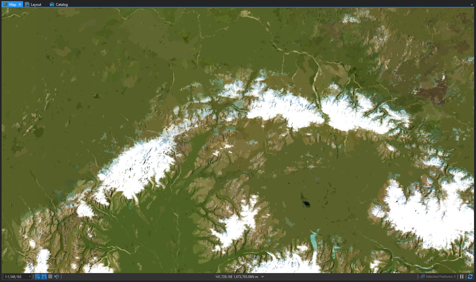

Here’s a posterized Denali…

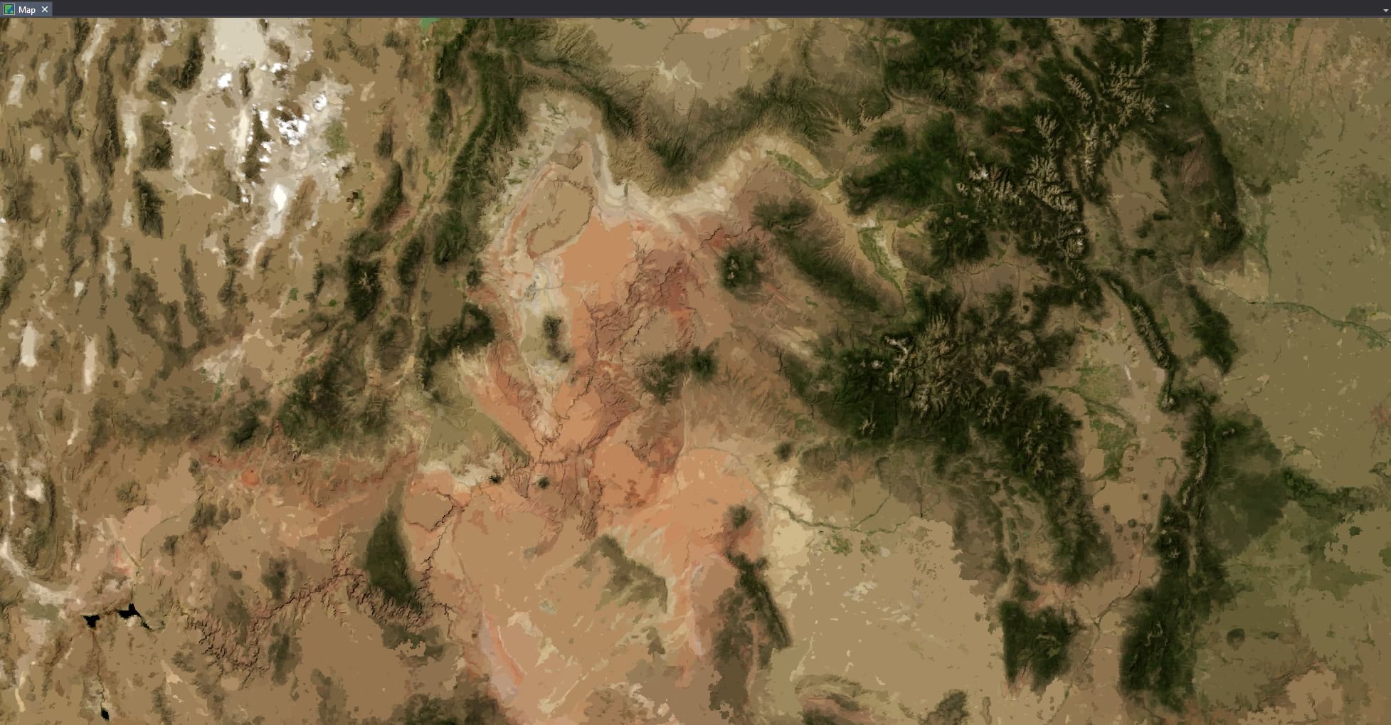

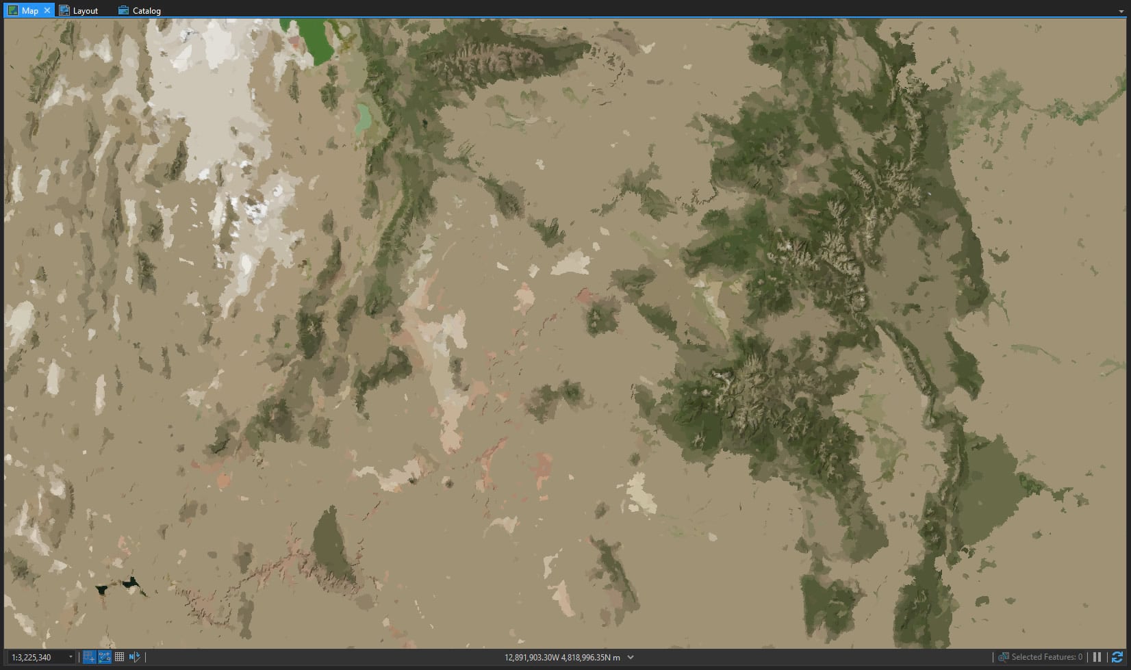

And here’s the Colorado Plateau, with the Grand Canyon in the bottom left corner, the Great Salt Lake north of that, and the Rockies extending through the right side of the canvas—I mean map.
This one looks better when you increase the parameters’ precision. You might have to click this image to see it at full size to notice that it’s even been posterized.

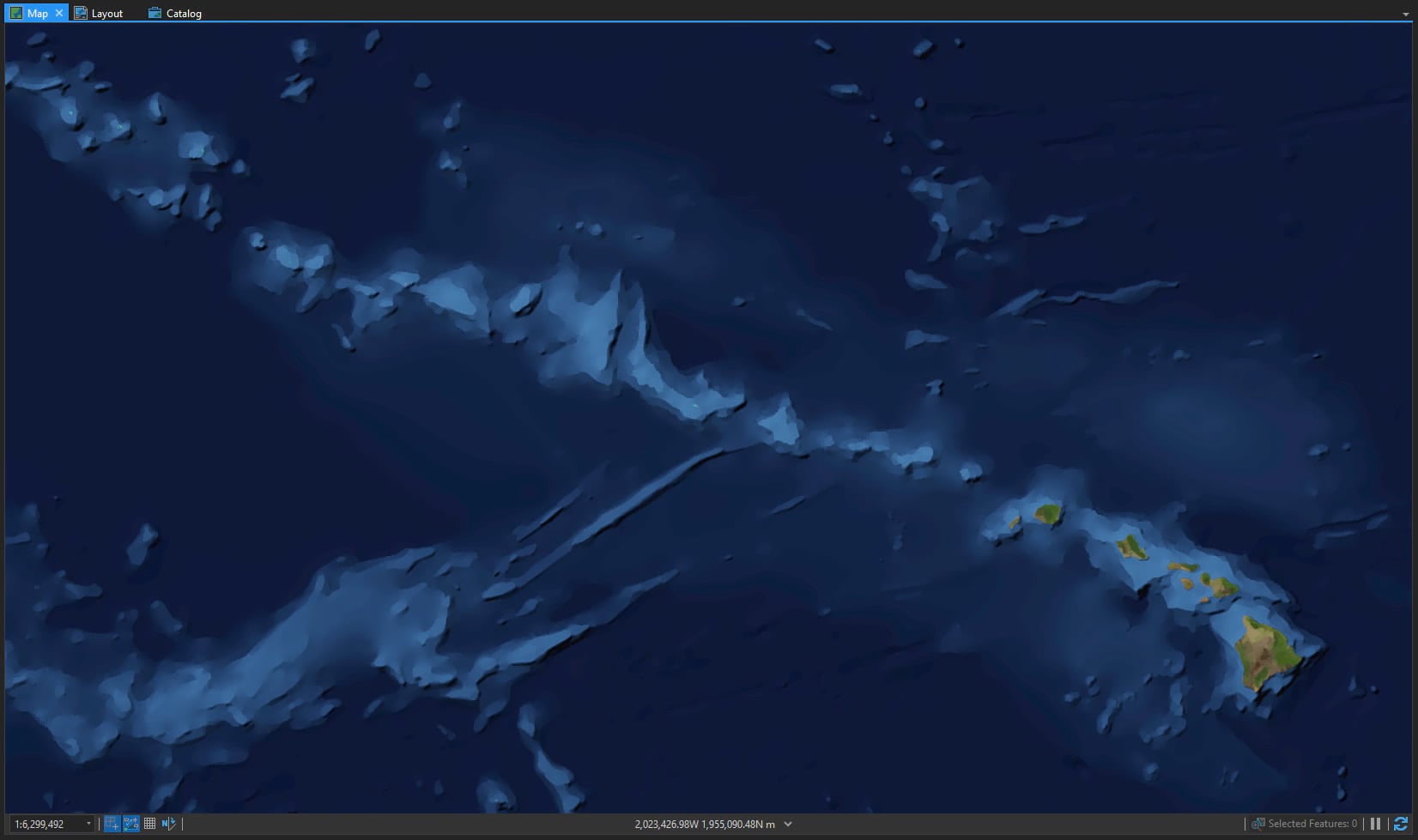

Bathymetry looks pretty cool too. Here’s a posterized Hawaiian chain and seafloor.
