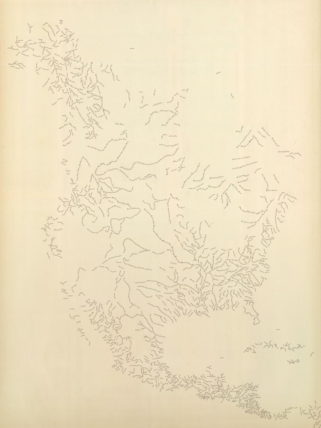

Here is a map of Europe’s and Africa’s rivers where the rivers are shown as just their names…
Click to embiggen...
Before you ask me, “hey John, have you seen the typographic maps Andy Woodruff made using only feature labels?” let me just tell you now absolutely I’ve seen them and they are gorgeous. There is something sort of magical and cognitively easing about typographic maps. If there are many types of landcover shown, like in Andy’s maps, the features are immediately keyed to their type or name. No reason to choose where/how to label because the thing itself is a label. And your brain thanks you for not making it load up a key of symbols into its leaky working memory while your eyes dart back to the map. The data is encoded directly as the features. That’s pretty great.
When you strip it back to only show a single sort of feature, like rivers, you get a sense of flow and hierarchy, the river names painting in the density and length naturally and sort of wonderfully.

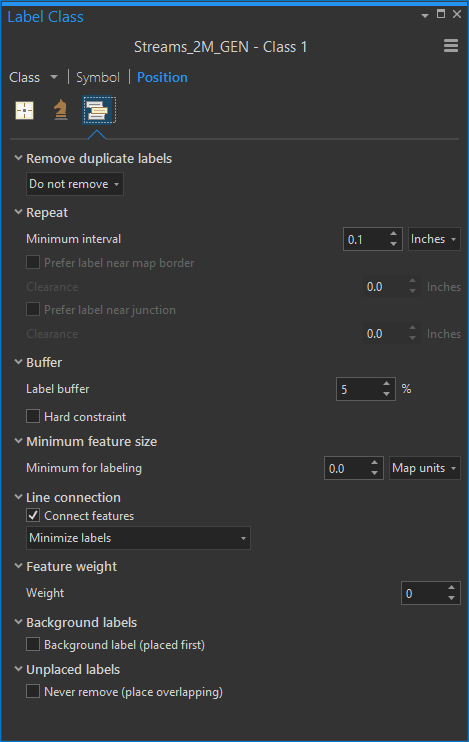

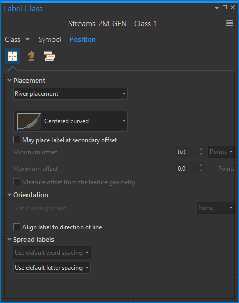

  • Label with “River Placement”, centered and curved right over the feature.

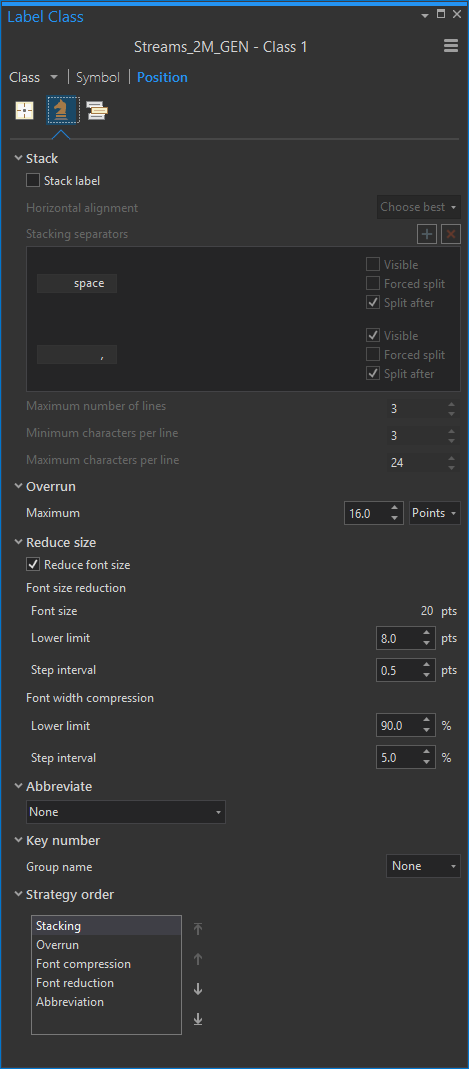

  • Do not remove duplicate labels and give them a minuscule separation interval.

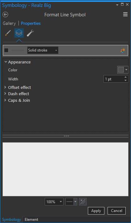

  • Leave river layer turned on but turn off all of its symbology layers.

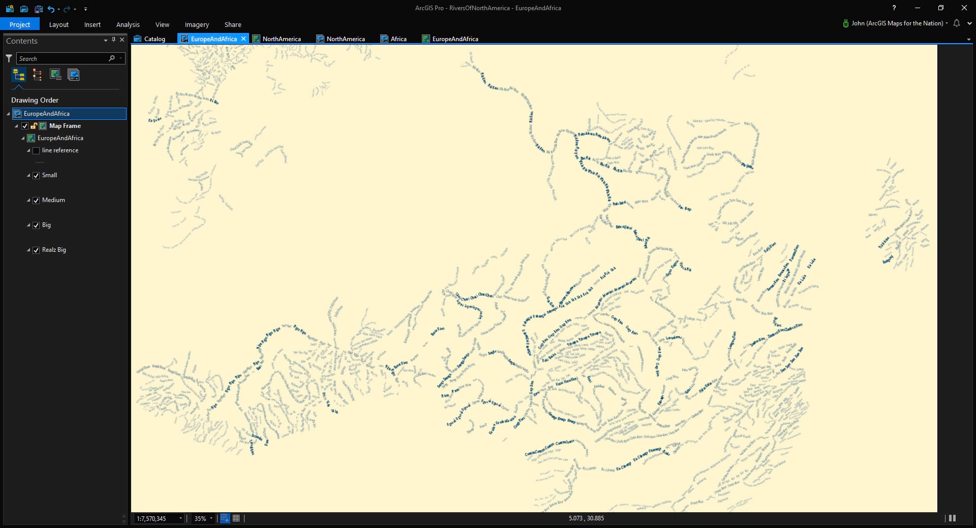

  • Break out your rivers by size and scale each layer’s labels accordingly.

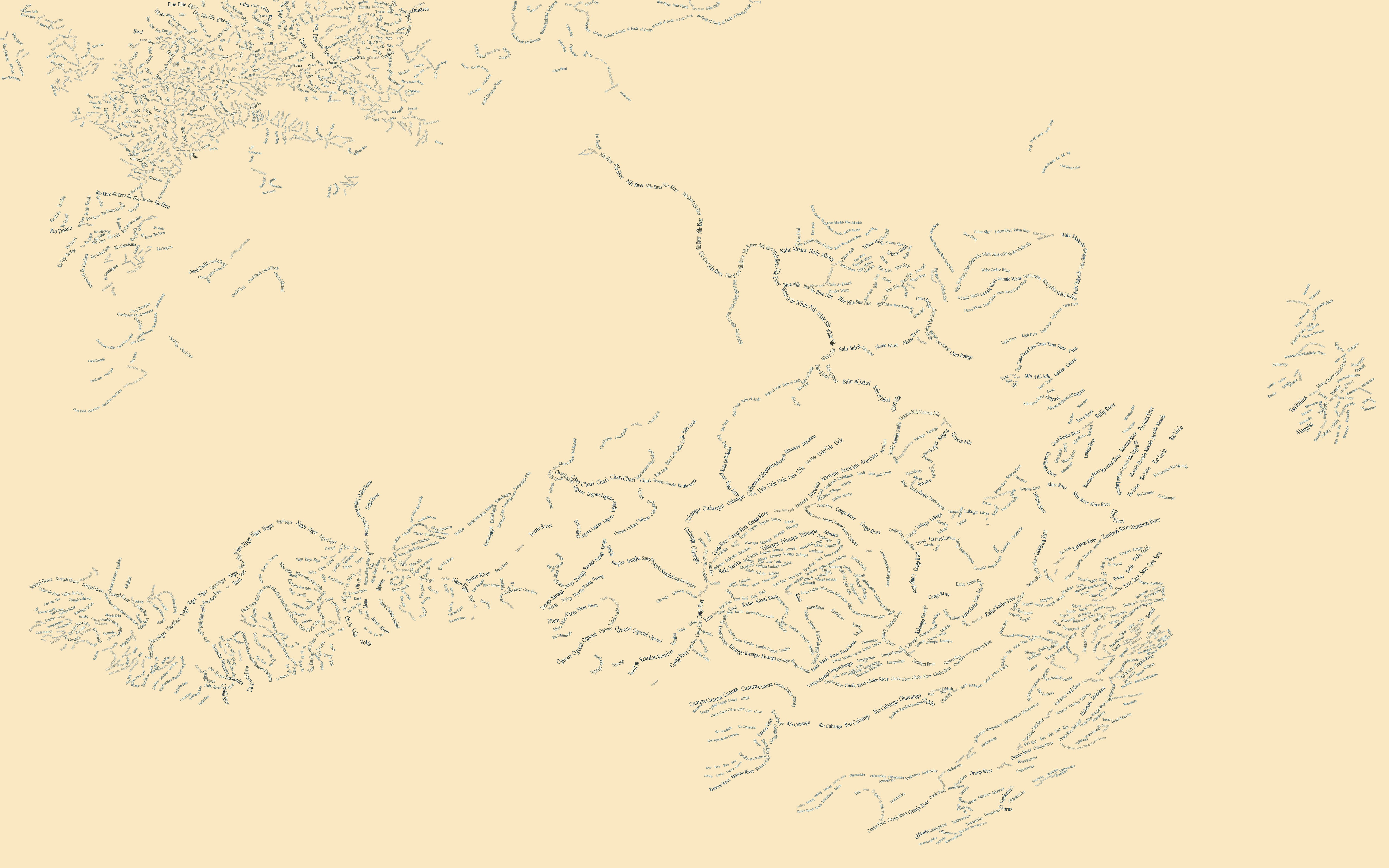

Here is my map, with unlabeled rivers shown as lines..
Then I leave the layer tuned on but uncheck all of the symbology items so labels can appear but there isn’t any line symbology getting in the way…

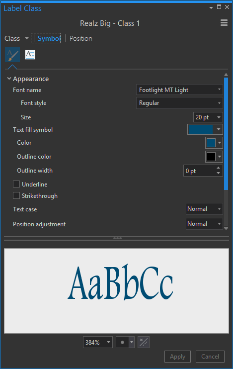

Wait, but how? No worries, here are all the settings for the label tabs that I used for my rivers (“position” is that target thing, “fitting strategy” is the knight chess piece, and “conflict resolution” is that little stack of boxes, though, if I were designing the icons, it would look like a little picture of Stuart Smalley)…

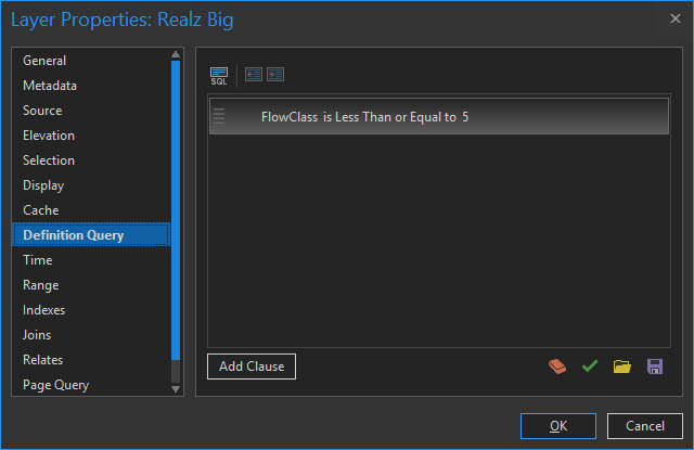

Lastly, I split my river layer up into several layers, based on river size, using definition queries (with the layer selected, go to the Data tab, then expand the Definition Query section)…
And I gave larger rivers bigger font sizes and bolder colors and smaller rivers smaller font sizes and lighter colors.
