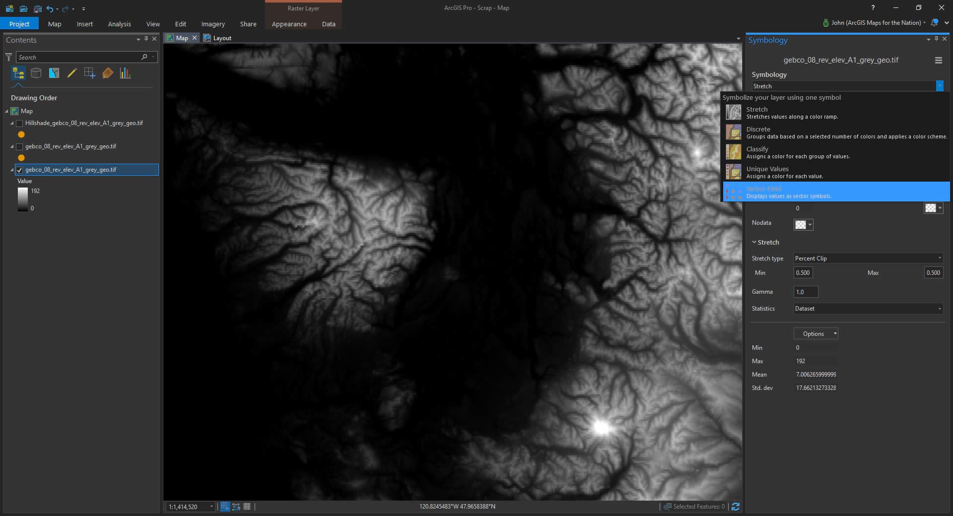

Here is a trusty ol DEM, stretched along a default black to white color ramp.

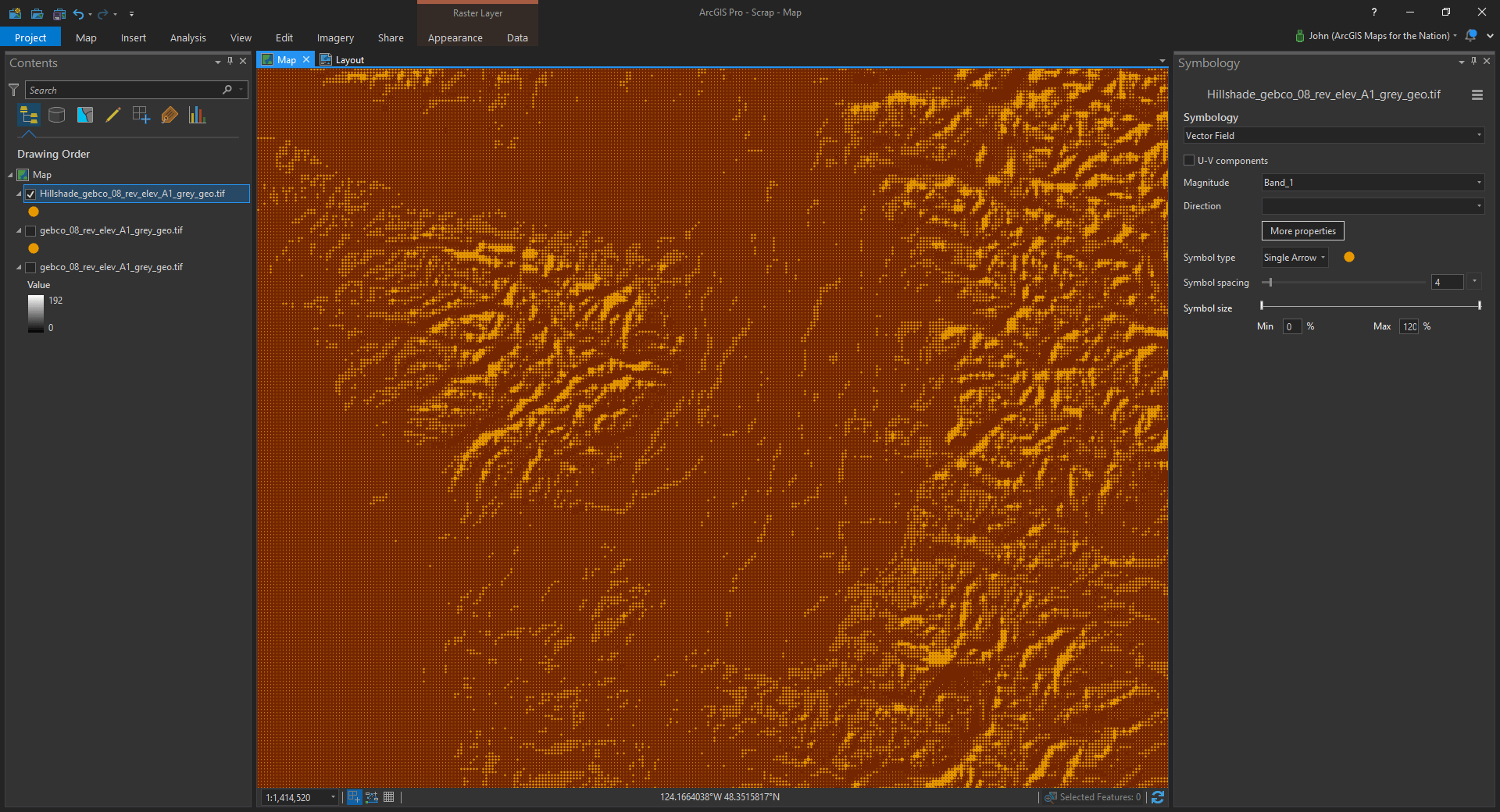

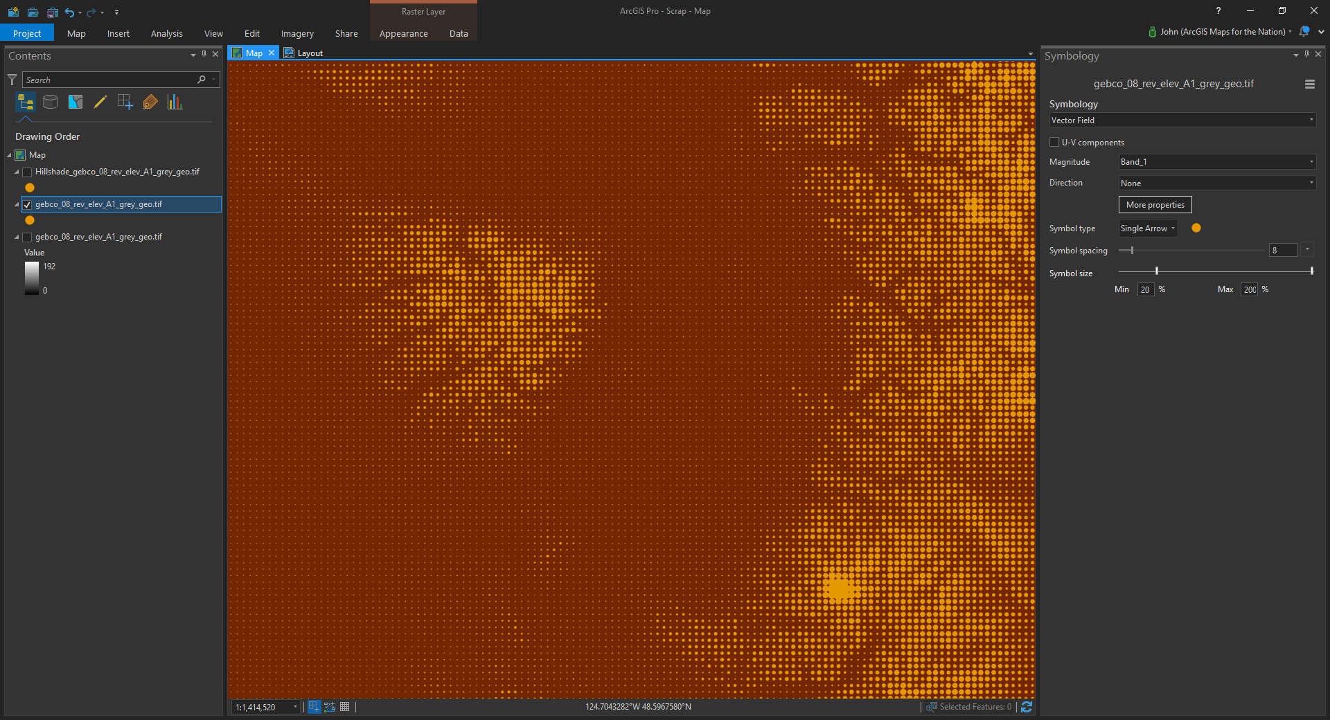

But if you expand the symbology dropdown you see a mysterious little option there called Vector Field. Actual cartographers use that to make wind and current maps, but where’s the fun in using tools the way they were intended?

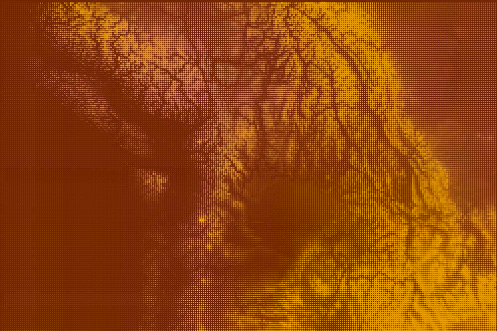

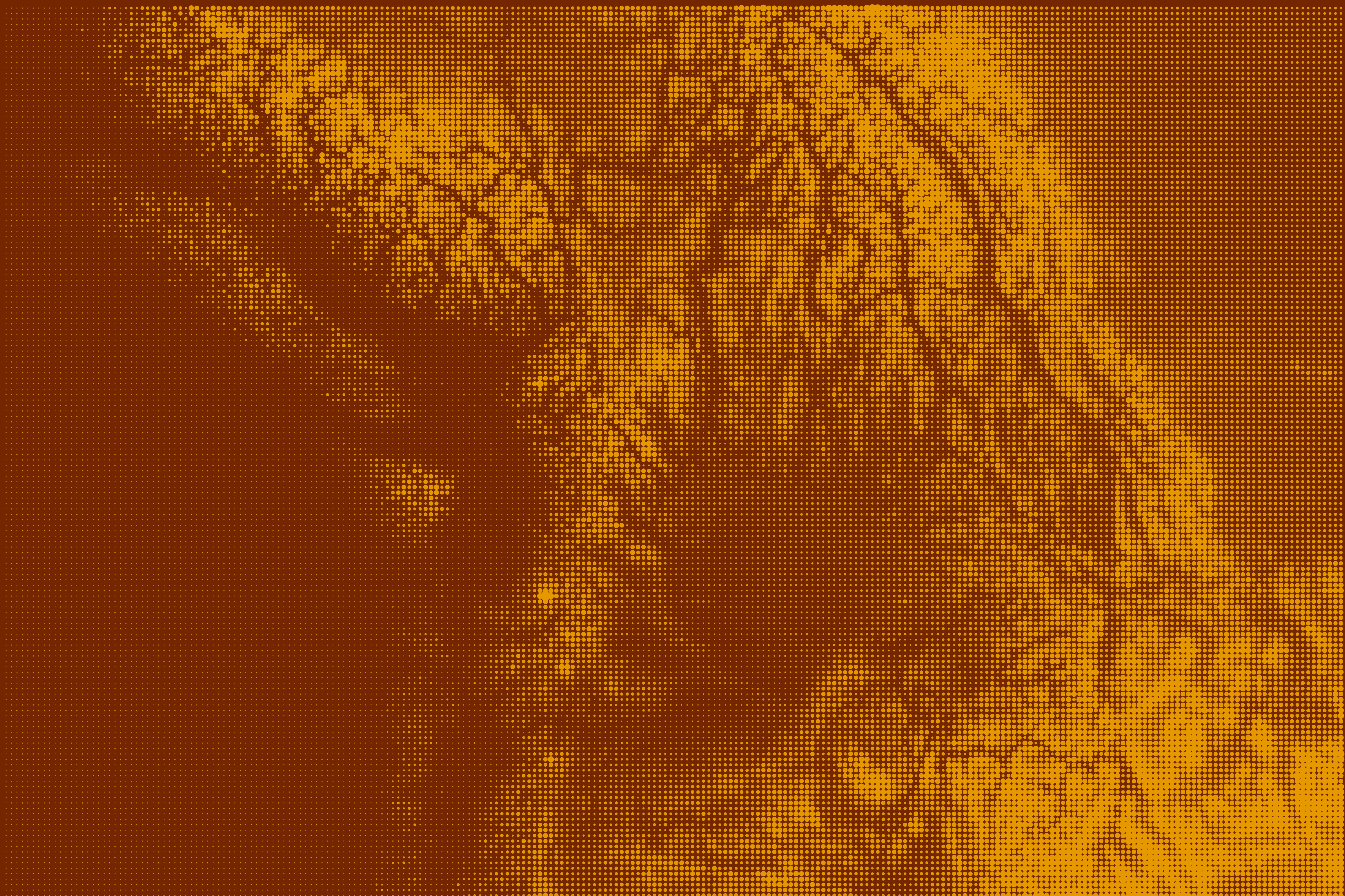

Wham! a cool little dot-matrix-looking thing of elevation. Just play with the symbols to get it the way you like.

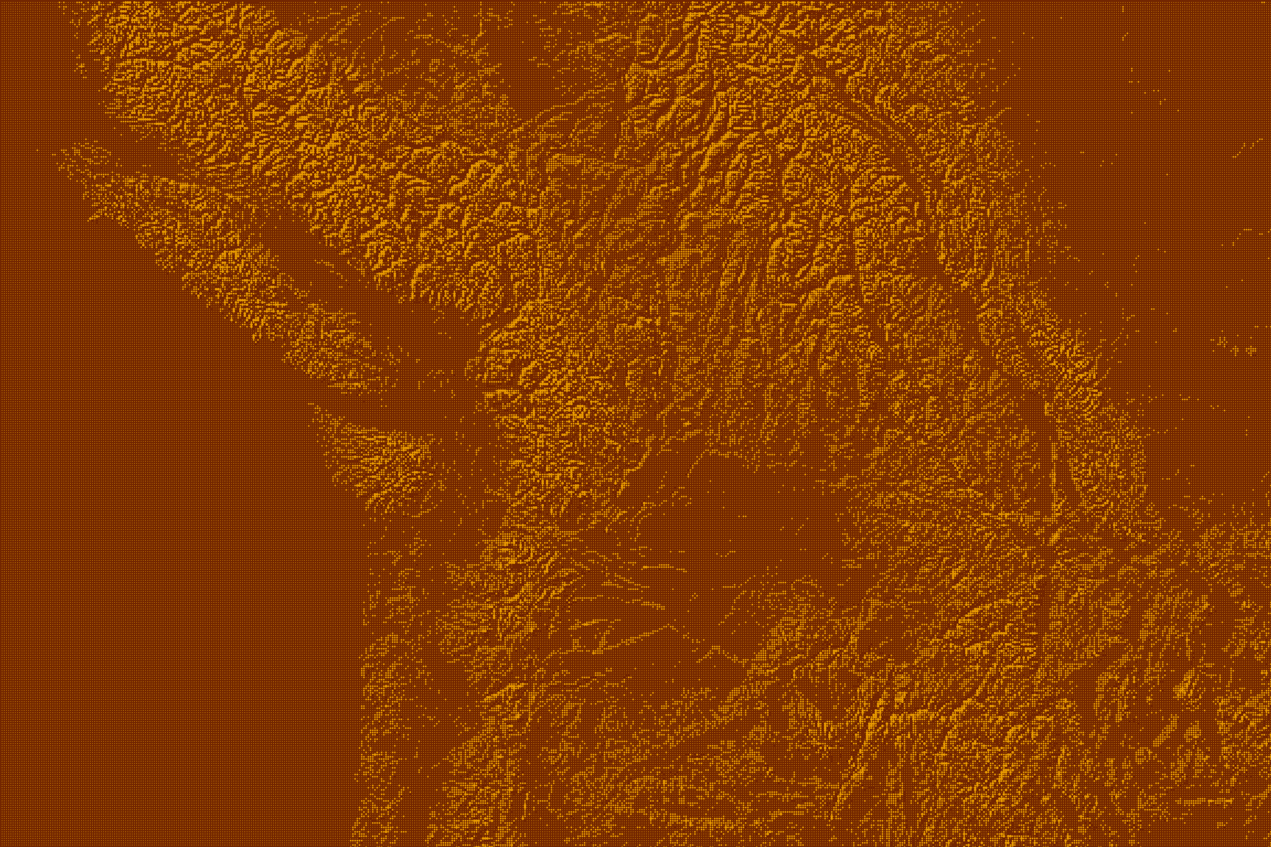

It might be a handy, stylized, graphical background for your map. So what about the original goal, which was to make a hillshade version of this? No problem, just open up the Raster Functions and apply a hillshade to your DEM. The vector field symbology works on the derived hillshade image, too…
Crinkle-tastic, right?

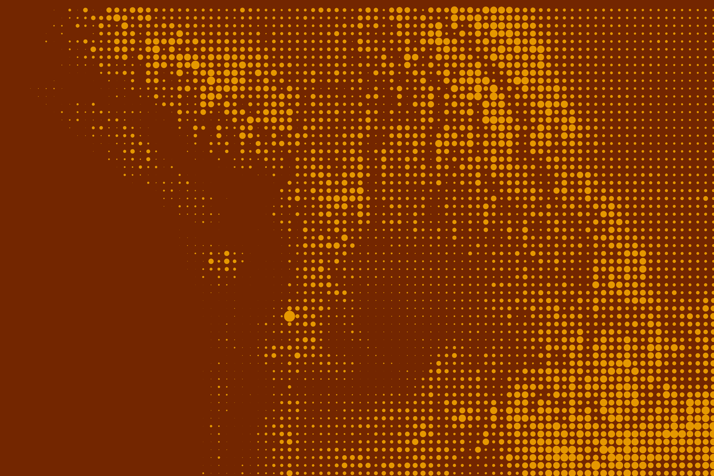

Play with the symbol spacing and symbol size range to get the look you want. Here’s a pretty detailed dot matrix elevation…
And here it is with a sparser, minimalist, symbol density…
Here’s a closer look at the dot matrix hillshade…

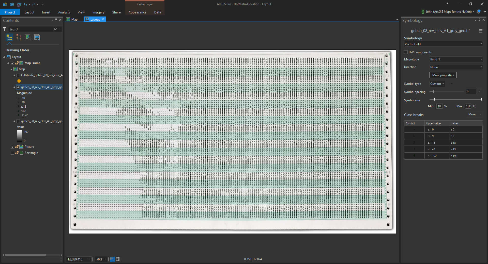

Hang on a second, all this talk of “dot matrix” and no actual ascii art dot matrix map? Ok, just toss in a background image and make your symbols printer fonts…
