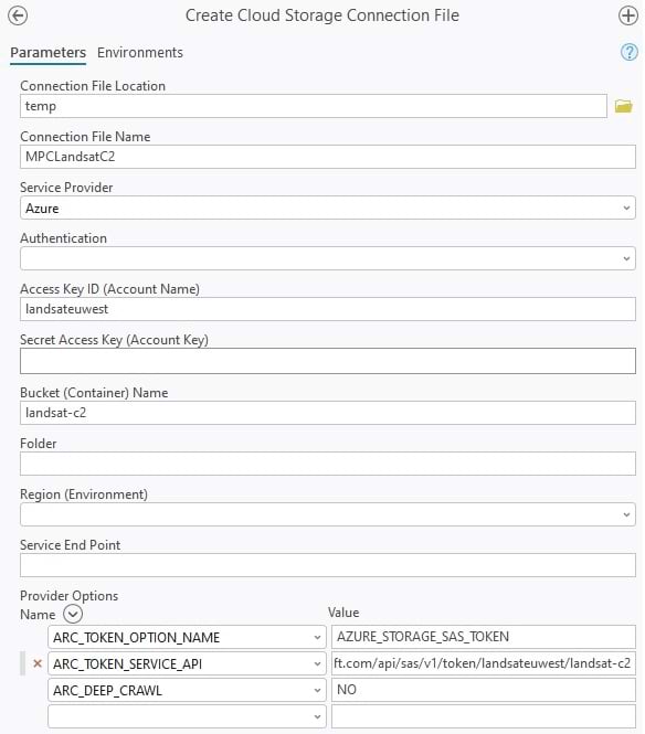

Creating ACS file for Microsoft Planetary Computer STAC
1. When we work with collections in the MPC STAC, we will create ACS connection files that require the following parameters.
- Storage Account Name: Name of the account to access this storage.
- Container Name: Name of the bucket or container.
- ARC_TOKEN_SERVICE_API: URL of the token vendor.
- ARC_TOKEN_OPTION_NAME: Type of token from the service provider.
2. We can get the account name and container information directly from the MPC site.
- Go to the Microsoft Planetary Computer Data Catalog. Search for and select the dataset collection you want to access. We will use the Landsat Collection 2 Level-2 as an example.
- View the Landsat Collection 2 Level-2 dataset overview page, which provides a STAC Collection link on your browser or on a JSON viewer.
- Search for two pieces of metadata: msft:storage_account and msft:container.The values of these two parameters are the Account Name and Container Name values for the Landsat collection 2 Level-2 collection.For this tutorial, use landsateuwest for Storage Account Name and landsat-c2 for Container Name.
3. Once you have the account name and container name, apply them to the ARC_TOKEN_SERVICE_API.
- In the request URL template, https://planetarycomputer.microsoft.com/api/sas/v1/token/{storage_account}/{container},replace {storage_account} with landsateuwest and replace {container} with landsat-c2.
- So, for the Landsat Collection 2 Level-2, the request URL is https://planetarycomputer.microsoft.com/api/sas/v1/token/landsateuwest/landsat-c2
4. We now have all the parameters that we need to create our ACS files. Open the Create Cloud Storage Connection File geoprocessing tool and set the following parameters:
- Connection File Location—C:\temp
- Connection File Name—landsatc2mpc.acs
- Service Provider—Azure
- Access Key ID (Account Name)—landsateuwest
- Bucket (Container) Name—landsat-c2
- Provider Options:
- ARC_TOKEN_OPTION_NAME — AZURE_STORAGE_SAS_TOKEN
- ARC_TOKEN_SERVICE_API — https://planetarycomputer.microsoft.com/api/sas/v1/token/landsateuwest/landsat-c2
- ARC_DEEP_CRAWL — NO
5. Now run the tool to create the cloud storage connection file. Once created, you can use this file when you create your connection to the Landsat collection on the MPC STAC.

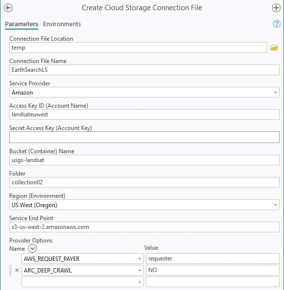

Creating ACS file for Earth Search STAC
1. When we work with collections in the Earth Search STAC, we will create cloud storage connection files that require the following parameters.
- Access Key ID (Account Name): Name of the account that will be used to access this storage.
- Secret Access Key (Account Key): The secret access key string to authenticate the connection to cloud storage.
- Bucket (Container) Name: Name of the bucket or container.
- Region: The region string for the cloud storage.
- AWS_REQUEST_PAYER: Requester Pays buckets can be accessed by setting this option to requester.
2. Find your account name and account key, which are available once you sign up with Amazon Cloud Services and get an AWS account. Contact your administrator or IT support if needed.
3. To get the bucket name and the region, visit the Registry of Open Data on AWS
4. Search for USGS Landsat and click the Details link to open the information on the USGS Landsat on AWS
5. On this page, get the following information:
- Resource typeS3 Bucket: Requester Pays (Indicates this is a protected bucket and that the requester (user) is required to pay for access to this bucket)
- Amazon Resource Name (ARN): arn:aws:s3:::usgs-landsat/collection02/ (This is the bucket name and folder name.)
- AWS Region: us-west-2 (This is the region where this cloud store is.)
6. Open the Create Cloud Storage Connection File geoprocessing tool and set in the following parameters.
- Connection file location: C:\temp
- Connection file name: EarthSearchLS.acs
- Service Provider: Amazon
- Access Key ID (Account Name): landsateuwest
- Bucket (Container) Name: usgs-landsat
- Folder: collection02
- Region: us-west-2
- Provider Options:
- AWS_REQUEST_PAYER: requester
- ARC_DEEP_CRAWL: NO
7. Now run the tool to create the cloud storage connection file. Once created, you can use this file when you create your connection to the Landsat collection on the Earth Search STAC.
