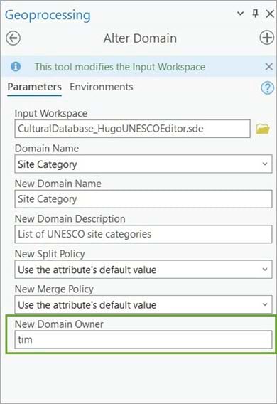

With the ArcGIS Pro 3.0 release, users can now transfer the ownership of enterprise geodatabase domains without having to delete and recreate the domain as the new user. This can be done as the current domain owner or the geodatabase administrator by using the Alter Domain geoprocessing tool or directly in the Domains view by editing the Owner column for the domain.
- A new parameter was added to the Alter Domain geoprocessing tool. The “New Domain Owner” takes the name of the database user that the domain ownership will be transferred to.

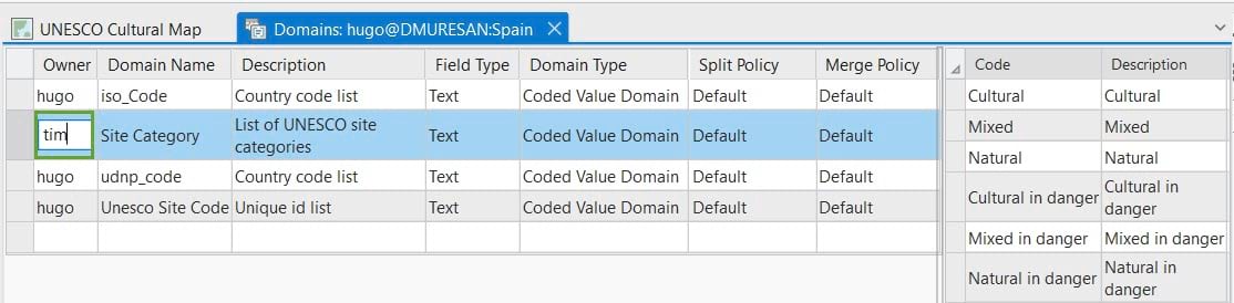

- Directly in the Domains view
The Owner column can be edited by double-clicking the owner value you want to change the ownership of and typing the new owner database username.

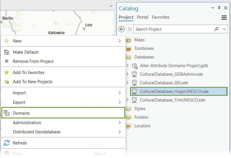

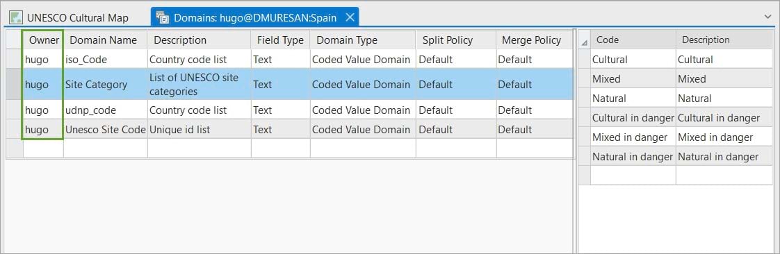

The first step is to survey and review the domains owned by Hugo. This can be done by opening the Domains view from a connection established by Hugo.
![Database connection as Hugo Database connection as Hugo](https://www.esri.com/arcgis-blog/wp-content/uploads/2022/11/hugo-database-connection-3.jpg)

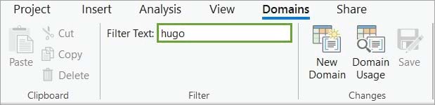

In the Domains view for the geodatabase, we can easily see that Hugo owns four attribute domains, but in a production geodatabase it may be necessary to use the Filter Text box to help filter only domains owned by a specific user.
![](https://www.esri.com/arcgis-blog/wp-content/uploads/2022/11/filter-text.jpg)
![Attribute domains owned by Hugo Attribute domains owned by Hugo](https://www.esri.com/arcgis-blog/wp-content/uploads/2022/11/domains-owned-by-Hugo.jpg)

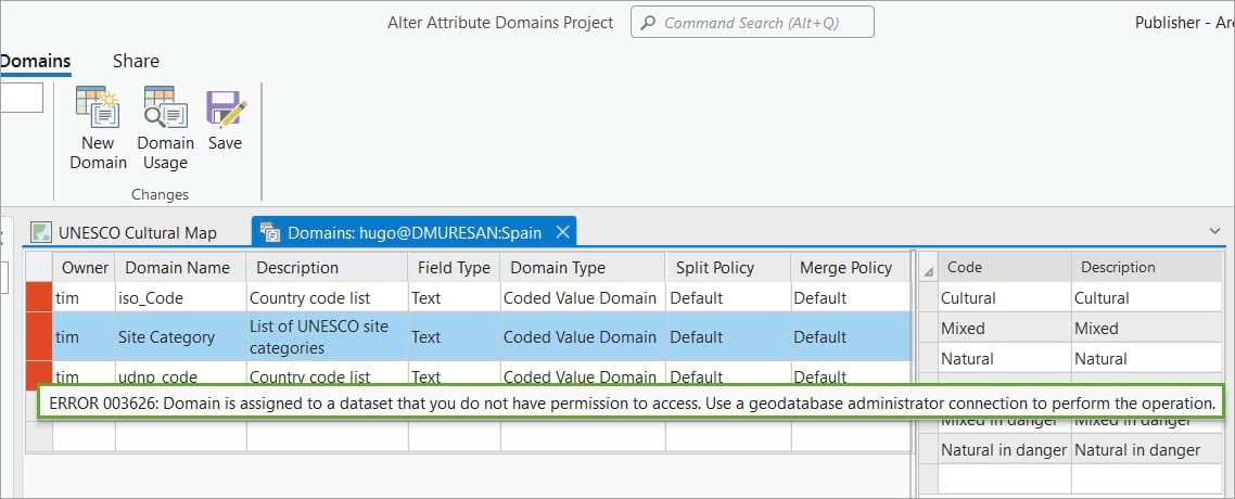

When Hugo tries to change the new owner username, he gets an error message. Although he is the domain owner, because the attribute domain is assigned to a dataset, he doesn’t have access to, the operation fails.
This is a common situation when a database user creates and manages the attribute domains but does not have access to all datasets in the geodatabase that the domain is assigned to.
![Hugo cannot change ownership to the attibute domains Hugo cannot change ownership to the attibute domains](https://www.esri.com/arcgis-blog/wp-content/uploads/2022/11/error003626.jpg)

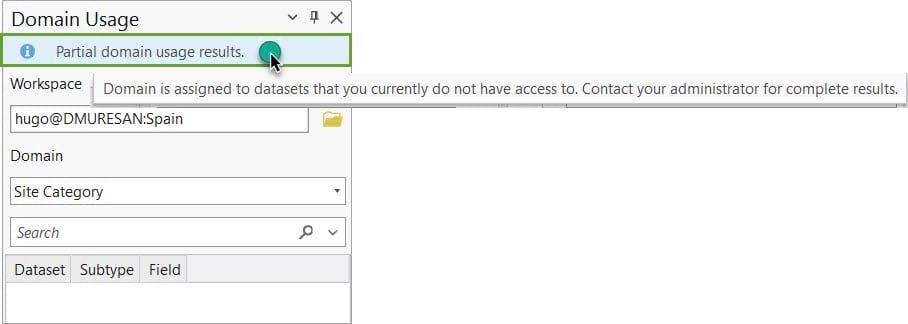

In order for Hugo to determine if he has access to all the datasets the domain is used in, he will use the Domain Usage pane. To access this, he will right-click on the Site Category domain in the Domains view and select Domain Usage. This opens the Domain Usage pane that displays the datasets that the domain is used in.
Hugo receives a banner in the Domain Usage pane that says ‘Partial domain usage results’. This is because Hugo doesn’t have permission to the datasets the domain is assigned to.
![Domain Usage tool Domain Usage tool](https://www.esri.com/arcgis-blog/wp-content/uploads/2022/11/domain-usage-site-category.jpg)

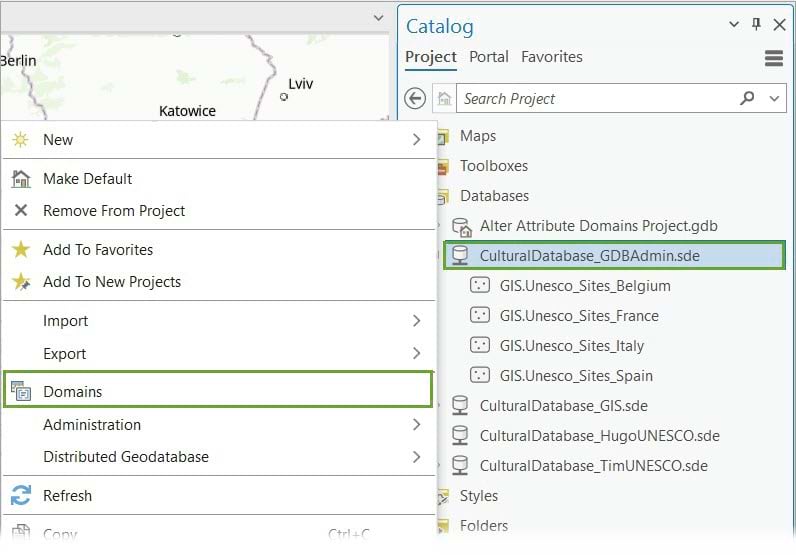

For this workflow, we will be using the Domains view accessed from the SDE user connection.
![Database connection as SDE user Database connection as SDE user](https://www.esri.com/arcgis-blog/wp-content/uploads/2022/11/sde-database-connection-1.jpg)

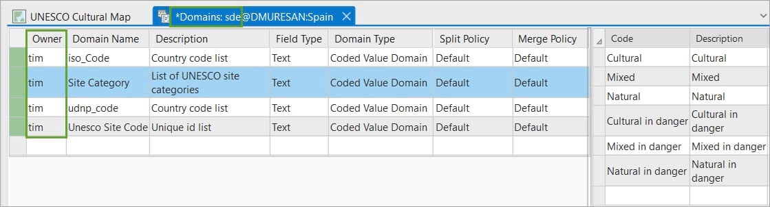

The geodatabase administration, in this case, the SDE user, performs the same task successfully because they have permission to the datasets.
![](https://www.esri.com/arcgis-blog/wp-content/uploads/2022/11/sde-changes-domain-ownership.jpg)
When Hugo opens the Domains view, the new owner is Tim and he doesn’t have access to the domains anymore, as the domain entries are greyed out.
