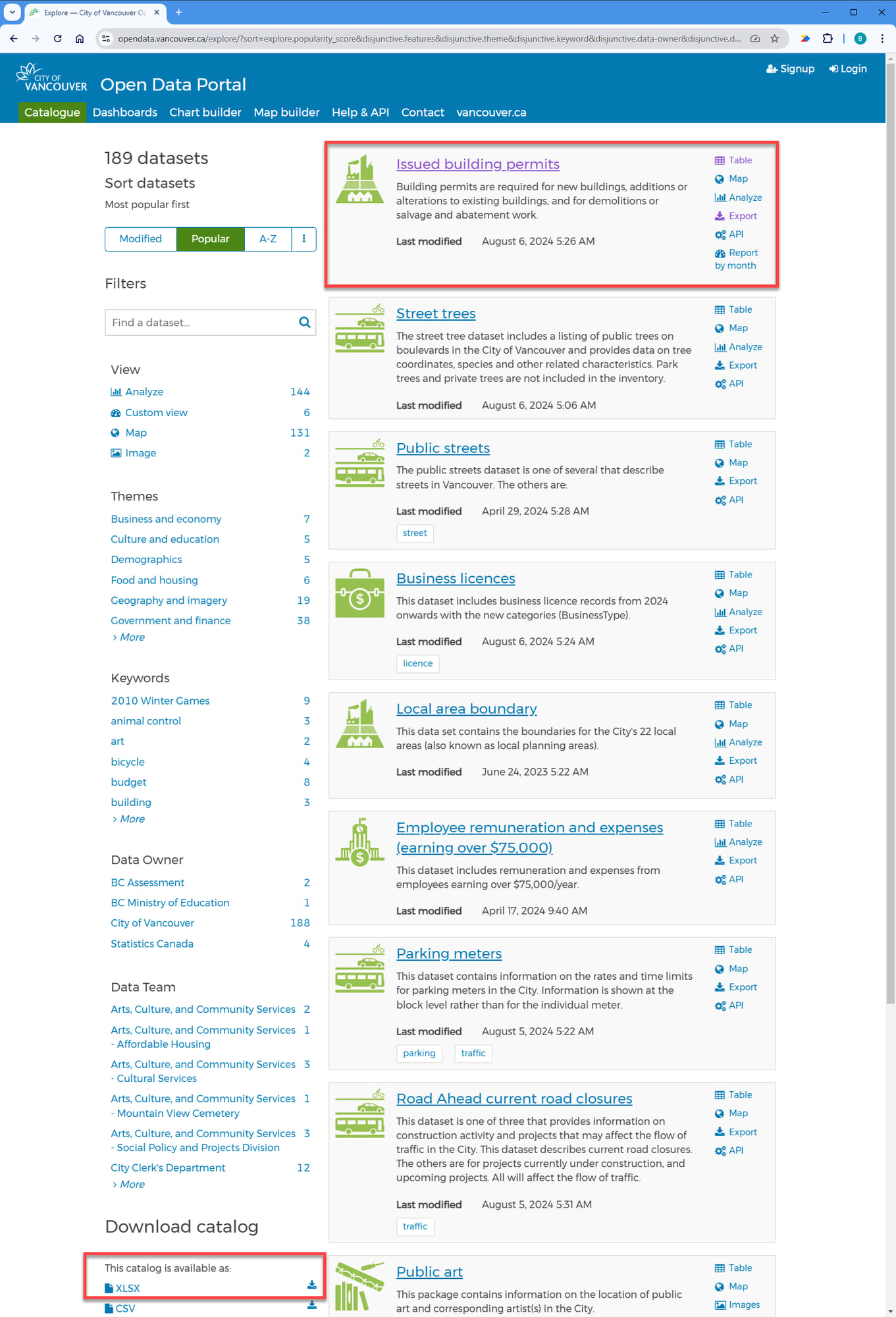

Below is the landing page for Vancouver’s portal. The datasets are sorted based on popularity, though we are skewing the results for the sake of this demonstration. We then highlight the dataset we want to harvest as well as a  link to an Excel spreadsheet near the bottom of the screen that contains all dataset metadata.
Data Landing Page

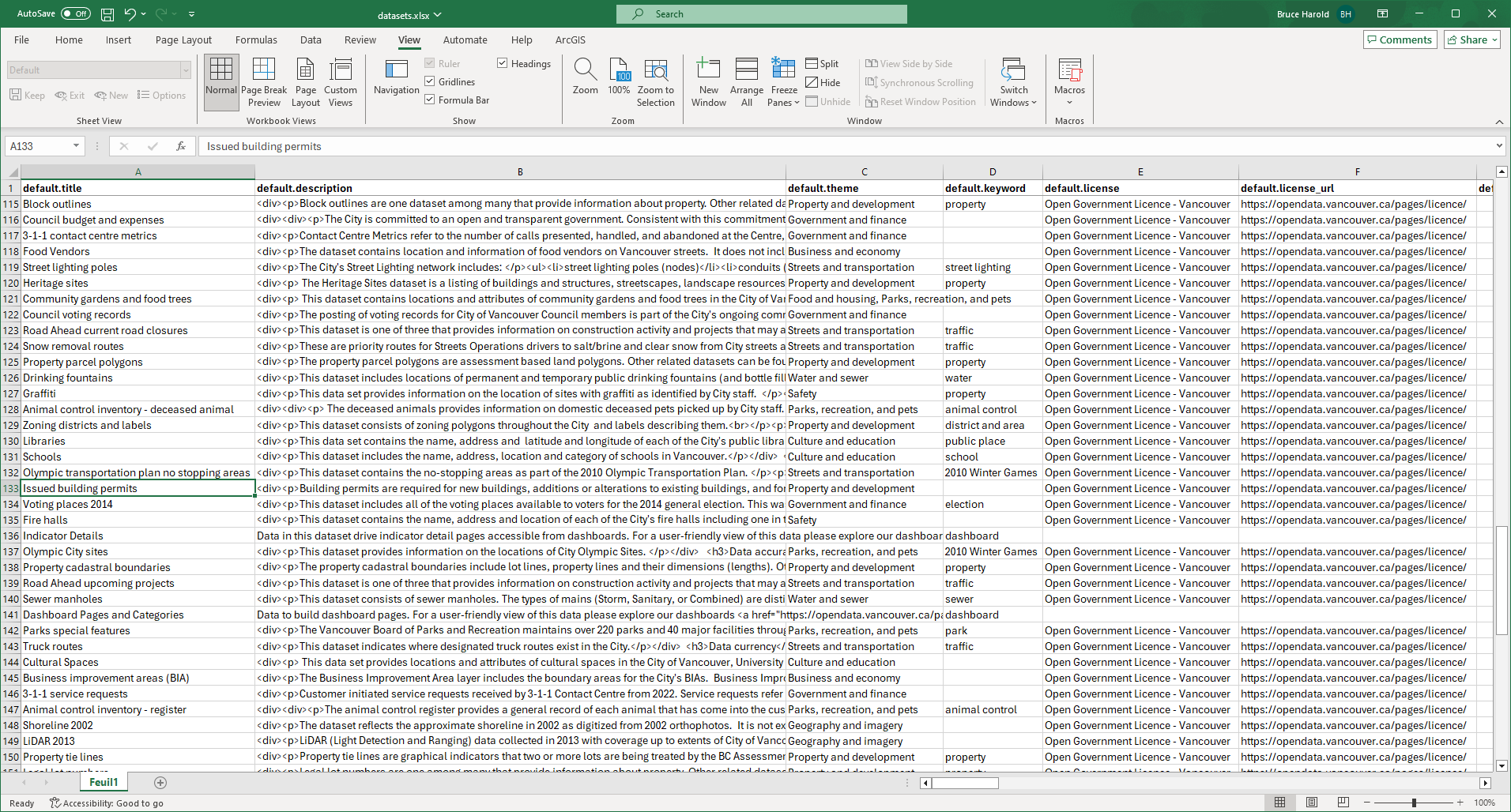

We then open the spreadsheet so we can see the row for the subject matter dataset – Issued building permits.
Dataset metadata spreadsheet
After that, it is just a matter of getting the cell values for metadata elements from the Excel spreadsheet to the hosted feature layer. The good news is that the RefreshBuildingPermits ETL tool was built for this sort of thing.

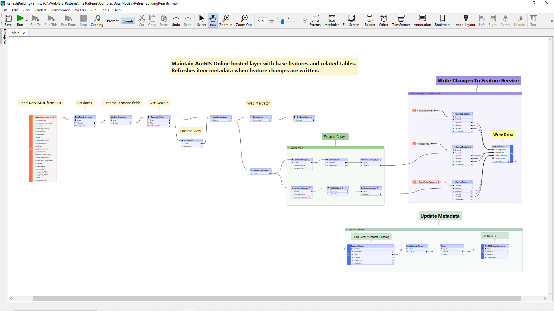

Without making this a tutorial on ETL tool design, the steps we’re using for our information product are to:
  • Make an initial file geodatabase incarnation of the data using the ETL tool ImportBuildingPermits that has the shutdown script shown above.
  • Create the layer with symbology and the desired pop-up behavior we want in ArcGIS Pro.
  • Publish the feature class and related tables as a hosted feature layer to ArcGIS Online.
  • Maintain the hosted feature layer using the RefreshBuildingPermits ETL tool.
By doing this, we are putting the hosted feature layer’s metadata update functions in a second ETL tool. If you look at the bottom right of the screen you will see a bookmark labeled Update Metadata. The FeatureWriter transformer handling actual permit data has a summary port which triggers a FeatureReader when any data is written to a hidden connector. The FeatureReader accesses the Excel file on the open data site and gets the right cell contents to an ArcGISOnlineConnector (also works with ArcGIS Enterprise) with the following settings:
Metadata details with ArcGISOnlineConnector
Essentially, the process is as easy as filling in the form. As long as there are no data changes, there are no metadata changes either. How easy is that? You now know how to harvest and write metadata using ETL tools!

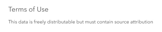

For the purposes of this demonstration, let’s say that we manage an ArcGIS Online or ArcGIS Enterprise organization with hundreds of items that need to have the terms of use updated. This change will need to be made for all hosted feature layers in a content folder.
Example:
This is what we have now:
This is what we want:

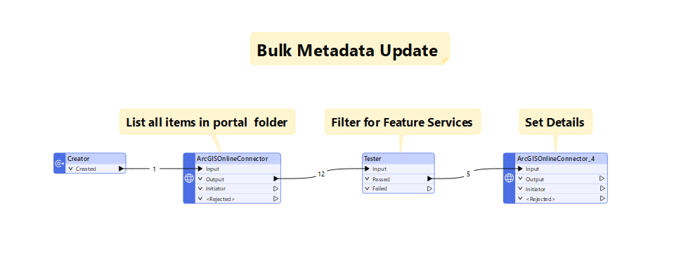

In order to make this bulk change, we can use another easy ETL tool:

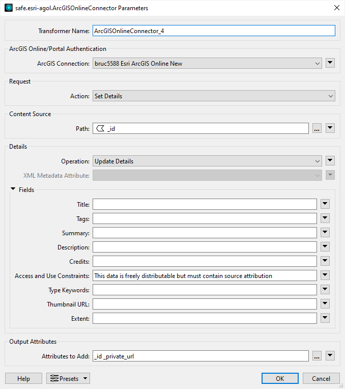

An ArcGISOnlineConnector can be used to list the candidate portal items along with a Tester to filter for hosted feature layers, and another ArcGISOnlineConnector to update the target element.
If no value is supplied for an item, it is left unchanged. To zero out an item, you would supply a value of NULL.
