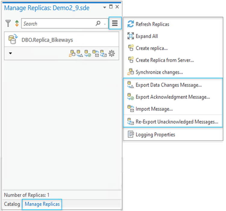

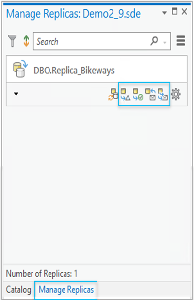

This manual process of exchanging messages, also known as disconnected synchronization, is accomplished through the following set of new tools:
WHERE can I find the geoprocessing tools?
For discoverability and ease of use we’ve added the new tools to the following locations:
