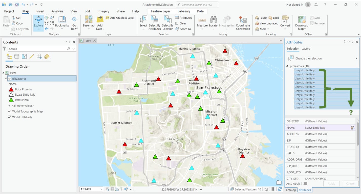

In our workflow, we need to add the same images to multiple features at the same time. I used the Select By Attributes option to create my selection set. Currently, the software allows you to add multiple attachments to a single feature, but not multiple features. Here is a screenshot that illustrates adding attachments within an editing session:
In this editing session, I see the Add attachments option when choosing a selected item from the list in the Attributes pane.
However, I want to add the same restaurant logo to all the selected features at once. Here we see in the next screenshot, that if I select them as a group, the option to add attachments is not available. I have two options to address this. Add the attachment of the restaurant logo one at a time. Or create a match table to add the same image logo to each selected feature using its ObjectID. Either of these could take a significant amount of time, especially if we have many features and files.

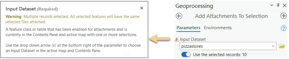

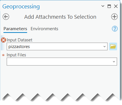

Input Dataset parameter
The first required parameter is the Input Dataset. This parameter expects the input dataset to be a layer in the Contents pane of the active map with one or more selections. To add the data to the tool, use the down arrow. The tool automatically detects the number of selected records to process during the run operation.
The tool will show a warning indicator next to the Input Dataset parameter with more than one selection. This warning lets you know that each selected feature will have the same selected files attached. We can see the description by placing our mouse pointer on the warning icon. This works for our scenario, as I want the same image logo attached to all 10 locations of Lizzy’s Little Italy.

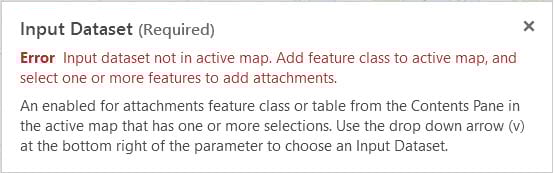

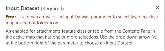

The tool will also issue the following errors with an error indicator in the same location as the warning icon under the following conditions.
The first error (most common) indicates that the input dataset was selected using the folder ? icon. It lets you know you need to choose an input dataset in the active map using the down arrow in the parameter window.
The second error (rare, but still possible) lets you know that a dataset is not in the active map. This occurs when you select an input dataset and then change to another map that does not contain the dataset. The error messages prevent you from running the tool until you resolve the issues as suggested.

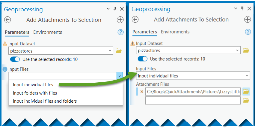

Input Files parameter
The second parameter provides you with options for where you want to choose files to attach.
- Input individual files — One or more files chosen from different locations.
- Input folders with files — One or more folders chosen from different locations and all supported files in each folder are added as attachments.
- Input individual files and folders — If desired, a combination of the first two options allows for many files and folders with files, attaching them to one or more selected features. For example, this option allows you to add a single file from one location, and then add a folder of files from another location.
In my case, I only needed to select one file, so I chose the first option. This allowed me to choose one or more files to add as attachments for all 10 of my selected restaurants.

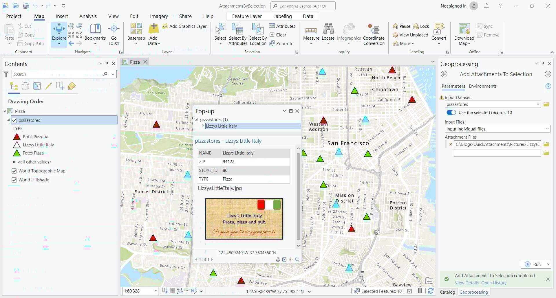

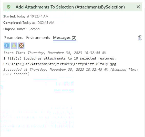

With the parameters all filled in, I was able to run the tool and the logo image for Lizzy’s Little Italy was attached to each of the 10 selected features. I can verify the updates by returning to the map and choosing one of the features to see the attachment in a pop-up window.

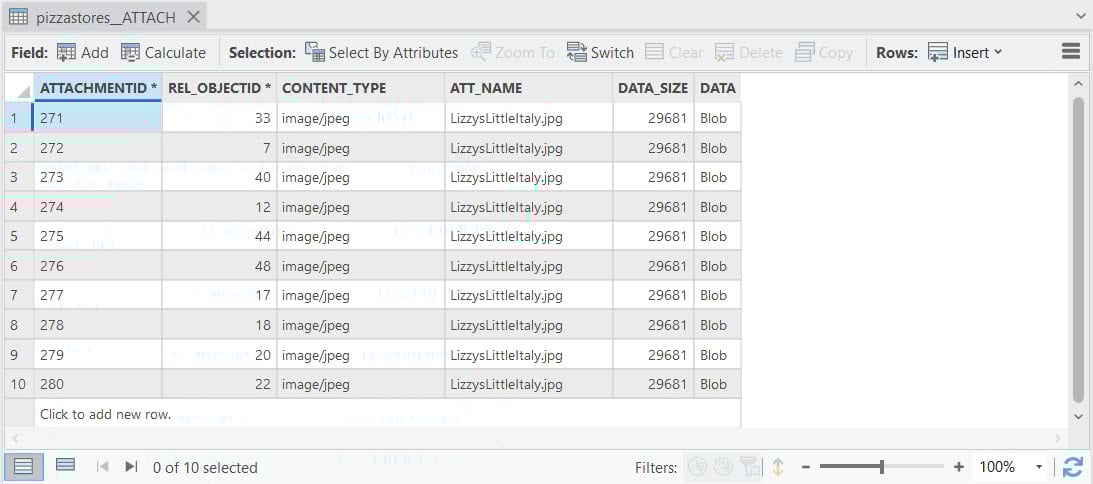

I can also validate the attachments by viewing the completed tool messages or by opening and viewing the pizzastores_ATTACH table. The ATTACH table stores added attachments in a BLOB (binary large object) field.

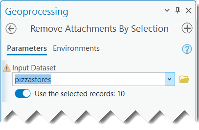

This sample tool does exactly what the name implies — remove attachments by selection. Like the Add Attachments To Selection sample tool, it has the same warnings and errors for the Input Dataset parameter. Choose the input dataset from the active map that has the selected features you want attachments removed. Click Run. But, before we get to removing attachments, let’s also review this tool as well.
If I keep the current selection for pizzastores, the Remove Attachments By Selection tool will remove all the attachments that I just loaded. Here we see the ATTACH table no longer has any rows of the previous attached files after running the tool with the same selected features.
In short, the Remove Attachments By Selection tool deletes all attachments for all selected features. The tool will also do the following:
