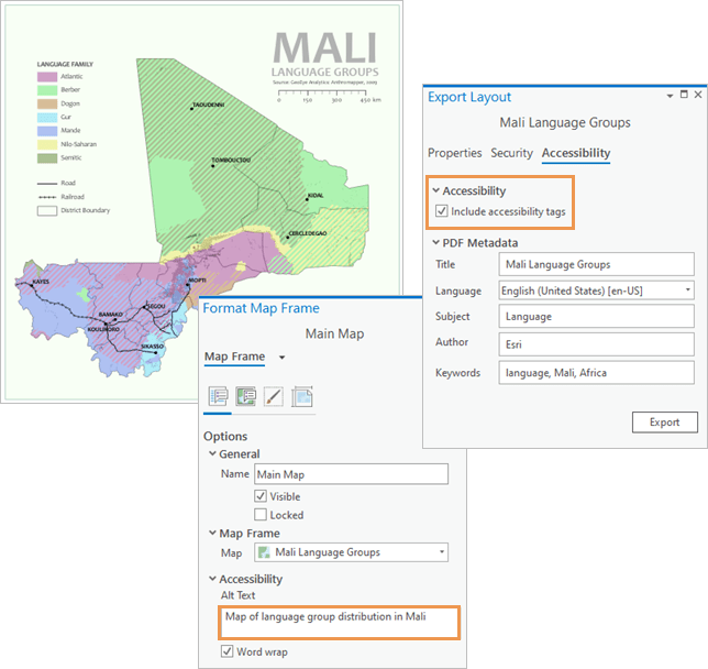

Export Layers As Accessible PDF Files
You can now export layouts as accessible .pdf files. These files can include descriptive alt text for map frames, chart frames, and pictures that can be read by screen readers to enhance comprehension of your layout.
When you compose your layout, you can specify alt text in the Element pane for an element, such as a map frame. When you export the layout as a PDF file, check the box to include accessibility tags in the Export Layout pane. Screen readers will be able to read the alt text in the exported file.
![pdf-files pdf-files](https://www.esri.com/arcgis-blog/wp-content/uploads/2021/05/pdf-files.png)
