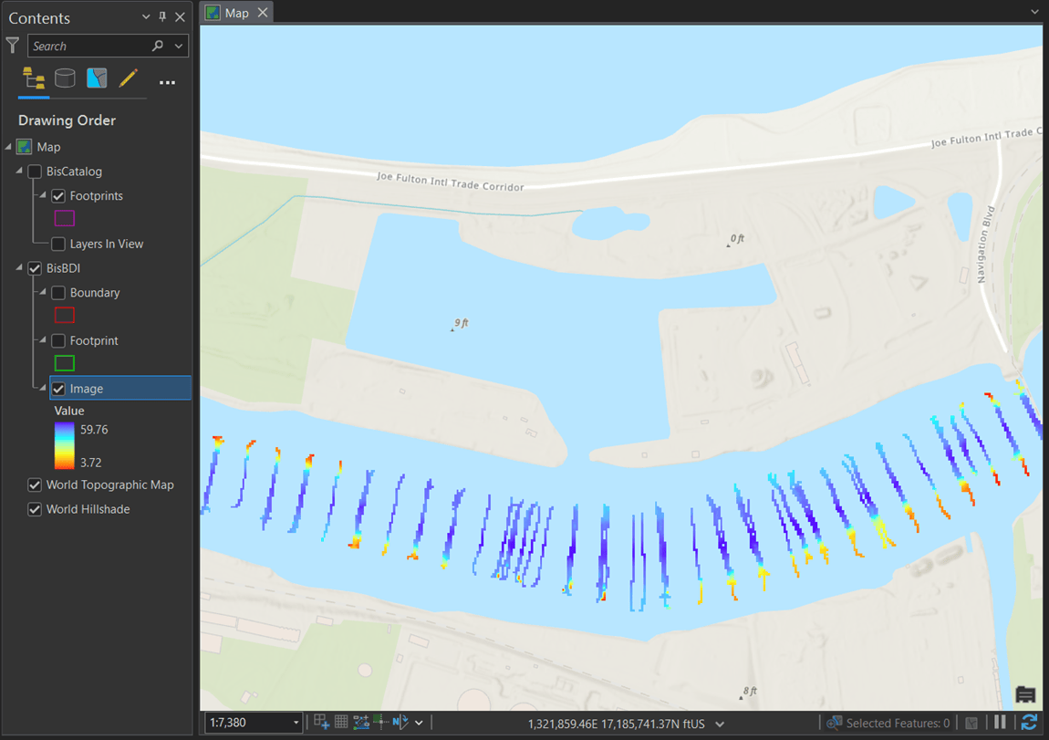

With the move into the ArcGIS Pro toolbox, there are three new geoprocessing tools that can help you manage the Bathymetric Information System (BIS). The first of these tools is Add Point Data To BIS. Similar to the Add Point Cloud To BIS tool available at 3.2, the new tool accepts both point cloud and elevation point data and replaces the former tool previously available with the ArcGIS Bathymetry product files.
![Point data in the BisBDI mosaic dataset visualized on the map Point data in the BisBDI mosaic dataset visualized on the map](https://www.esri.com/arcgis-blog/wp-content/uploads/2024/05/enhanced-support-for-points_bathy-3.3.png)
Learn more about the Add Point Data To BIS tool

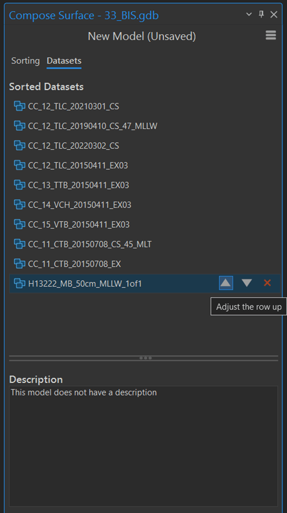

Along with these three new geoprocessing tools, the Compose Surface tool has also been enhanced with a new Datasets tab, where you can view sorted datasets in an ordered list according to the attribute rules configured on the Sorting tab.
![A list of sorted datasets on the Datasets tab of the Compose Surface tool, with the Adjust the row up arrow highlighted A list of sorted datasets on the Datasets tab of the Compose Surface tool, with the Adjust the row up arrow highlighted](https://www.esri.com/arcgis-blog/wp-content/uploads/2024/05/Compose-surface-sorted.png)
You can use this list as a quick reference to see how datasets are ordered and make manual changes if there is a dataset you want to prioritize or move.
