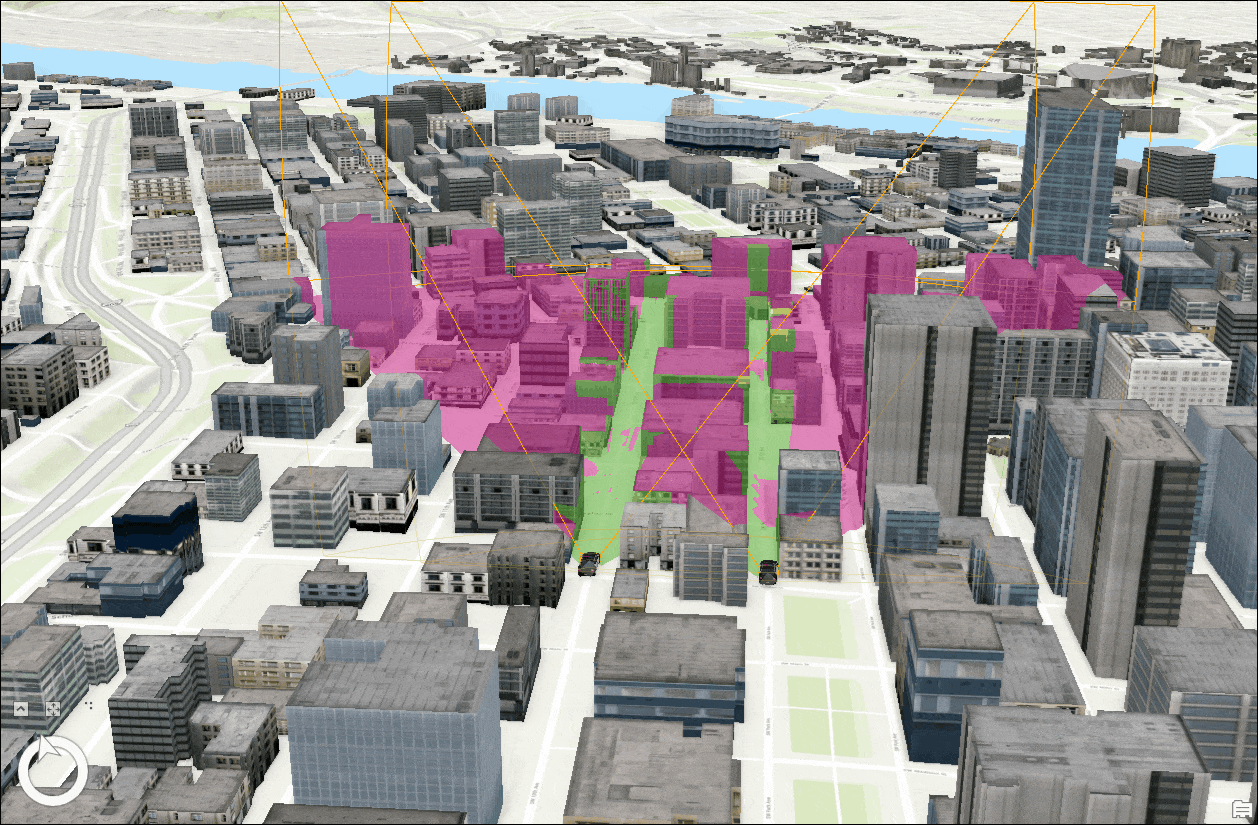

You can—for security reasons—find the areas in a 3D space that are visible from police cars.

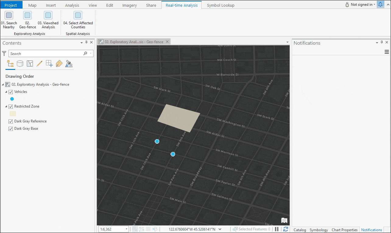

You can define a geofence and send alerts as vehicles enter or leave any restricted zone.

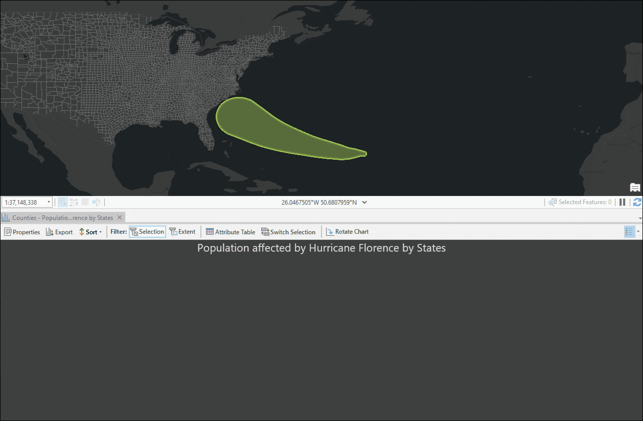

Or you can automatically perform spatial analysis to find all the counties and the total population that will be affected by an approaching hurricane.
