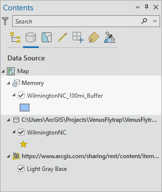

Because memory datasets are stored in your computer’s RAM, they cannot be viewed from the Catalog pane or view in a database or folder connection. But layers with a memory data source will display on the map and are listed in the Contents pane.
Contents pane List By Data Sources tab
View datasets saved to the memory workspace from the Contents pane List By Data Sources tab

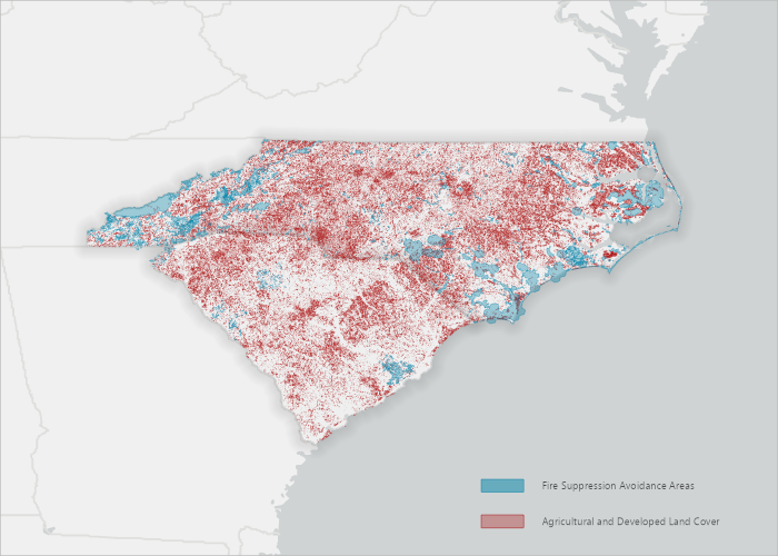

Venus Flytrap habitat threats and fire suppression avoidance areas

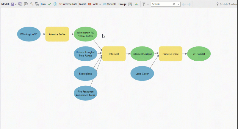

Using ModelBuilder, let’s build a geoprocessing workflow to identify the potential Venus Flytrap habitat locations.
Create a model that uses the following tools and steps:
  1. Pairwise Buffer: Define a 100-mile buffer around Wilmington, NC.
  2. Intersect: Find the intersection between the 100-mile buffer, ecoregions, longleaf pine habitat, and fire suppression avoidance areas.
  3. Pairwise Erase: Remove all agricultural and developed land cover areas from the potential habitat locations.
Use the memory workspace for the Pairwise Buffer and Intersect tools output, since we do not want to keep those results and want the fastest performance possible. Use the project geodatabase for the final output of Pairwise Erase, as we want to keep that dataset for review and sharing the results.
Modelbuilder
The model uses the memory workspace for intermediate steps
By running the tool with memory workspace outputs for the intermediate steps, the model completes in 2 minutes, which is faster than writing to the file geodatabase for all steps. And you will not get any intermediate outputs cluttering your project database.
