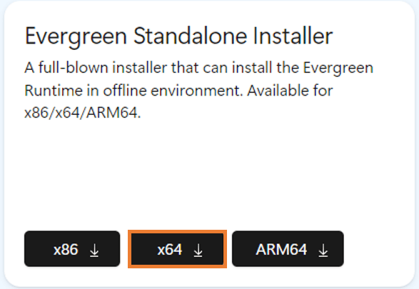

If you do not already have WebView2 Runtime installed, you can download and install it from this site.
Choose the Evergreen Standalone Installer x64 download.
The installer will automatically detect and install the latest version of WebView2 Evergreen standalone on your machine. You do not need to restart your machine after the installation.

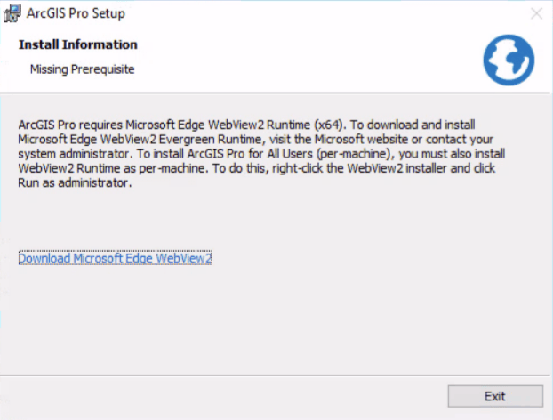

What will happen if I try to install ArcGIS Pro 3.3 and I don’t have WebView2 Runtime?
This will happen…
