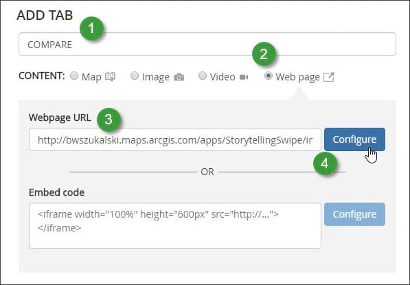

To embed a story map in a Story Map Series, follow the steps below.
Step 1 – Add a new tab, entry, or bullet depending on the layout chosen, and enter a title.
Step 2 – Choose Web page.
Step 3 – Copy and paste the story map URL, making sure &embed is appended.
Step 4 – Click Configure.

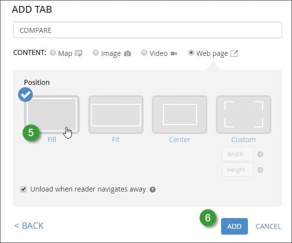

Step 5 – Choose Fill (the default).
Step 6 – Click Add and complete the tab, entry, or bullet.

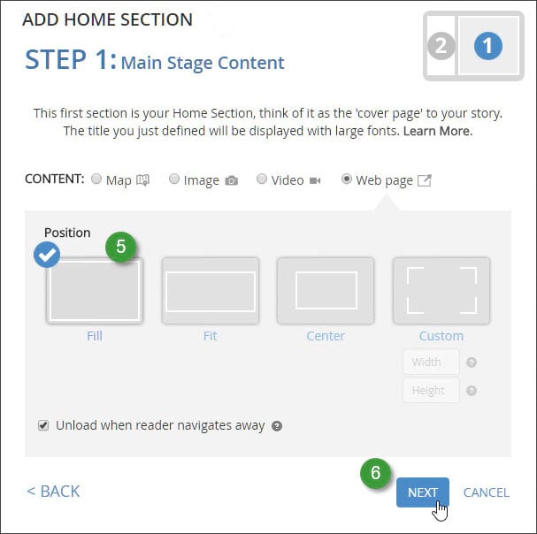

To embed a story map in a Story Map Journal follow the steps below.

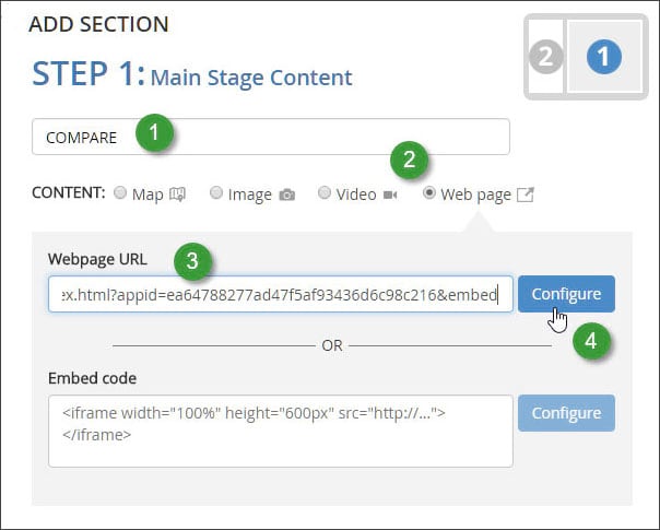

Step 1 – Add a new Section, and in the Main Stage Content enter a title.
Step 3 – Copy and paste the story map URL, and make sure &embed is appended.
Step 6 – Click Next to complete the new section.

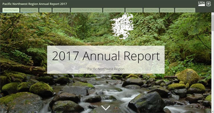

This Story Map Series from the Pacific Northwest Region, USDA Forest Service, embeds a Story Map Cascade in each tab. This delivers a consistent user experience throughout the story, and each tab represents a unique theme in the report.
