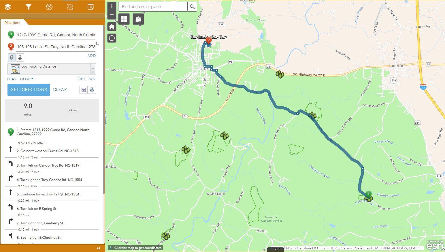

Point-to-Point Routes
When you want to find the shortest or quickest route between a single harvest and single mill, use the Get Directions tool. The result will be the least-cost path between the two locations. You can set the travel mode, add restriction barriers, and even factor in traffic conditions. Once directions are created, you can make changes to the route and save the route as a layer.

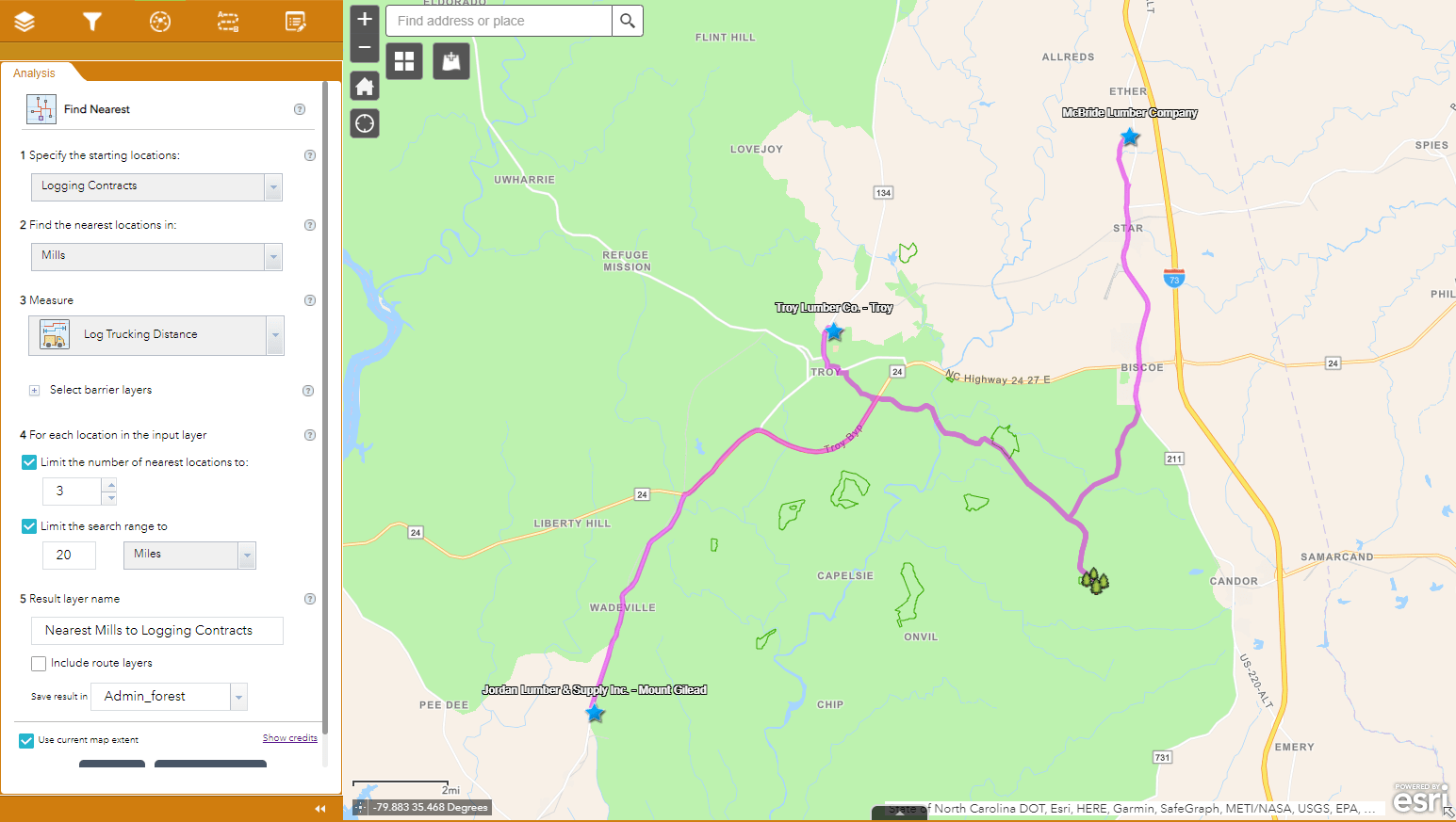

Closest Facility Routes
In some cases, there may be multiple mills in an area. The best mill to haul logs to may not always be a clear choice. The Find Nearest tool can be used to find the nearest mill to the harvest location. The near distance can be based on a straight-line distance or use travel time or driving distance as the measure. The tool can also be used to find a specified number of locations within a given distance and rank them based on proximity.

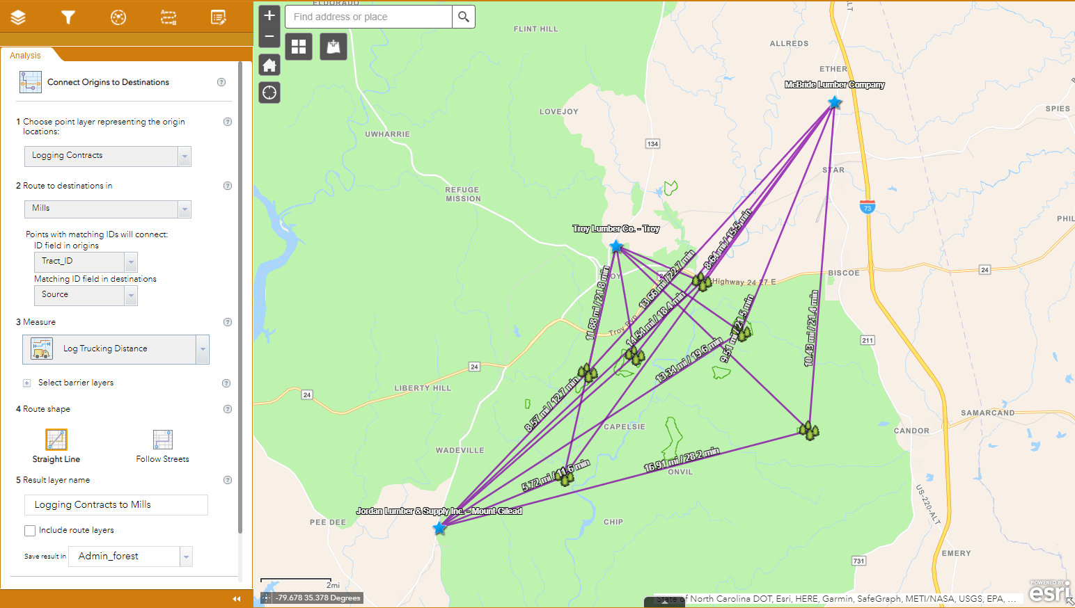

Bulk Routes
When you are planning timber harvests or evaluating timber sales, you may be interested in understanding all possible haul scenarios. Estimating transportation costs for each origin-destination pair is important to determine the best option. The Connect Origins to Destinations tool can be used to generate drive times and distances from multiple origins to multiple destinations.

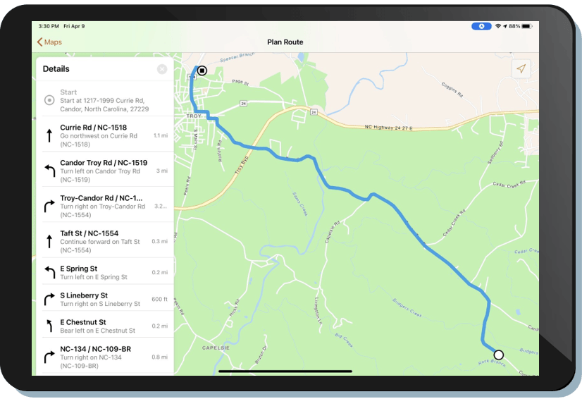

Results from network analysis tools are stored as new layers in ArcGIS Online by default. These layers can be added to maps for visualization, shared with others, or archived for recordkeeping. In some cases, you may want to share routes with field workers to provide guidance. Instead of sending or printing off directions, you can share the output of your analysis directly. Route Layers are a special type of item that include all the information for a particular route, such as stops and travel directions. Route Layers can be used in ArcGIS Navigator to provide drivers with turn-by-turn directions and voice guidance in both connected and disconnected environments.
