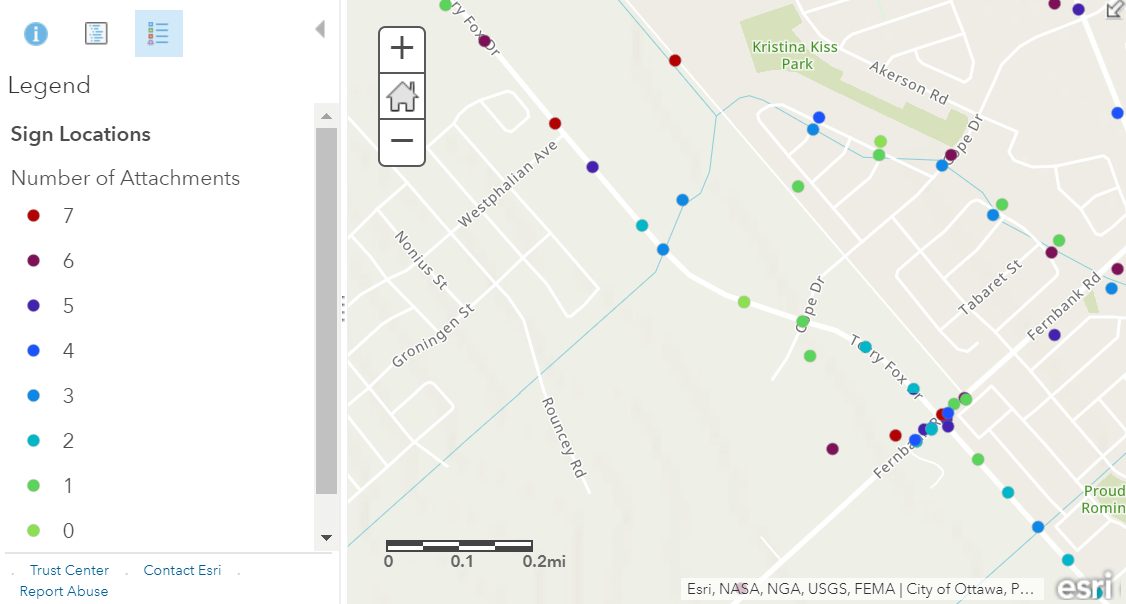

Get the number of attachments
Getting the total number of attachments per feature comes in handy when trying to identify what assets might be missing visual information, such as photos to support asset condition surveys. The fastest way to get this information is to chain the new Attachments() function with the Count() function.
//returns the number of attachments per feature
Count(Attachments($feature))
Because you are calculating this information to a field, you can than render your map or filter your features based on the new value. This lets you do something that resembles the map below.
![](https://www.esri.com/arcgis-blog/wp-content/uploads/2019/03/Attachments1.png)

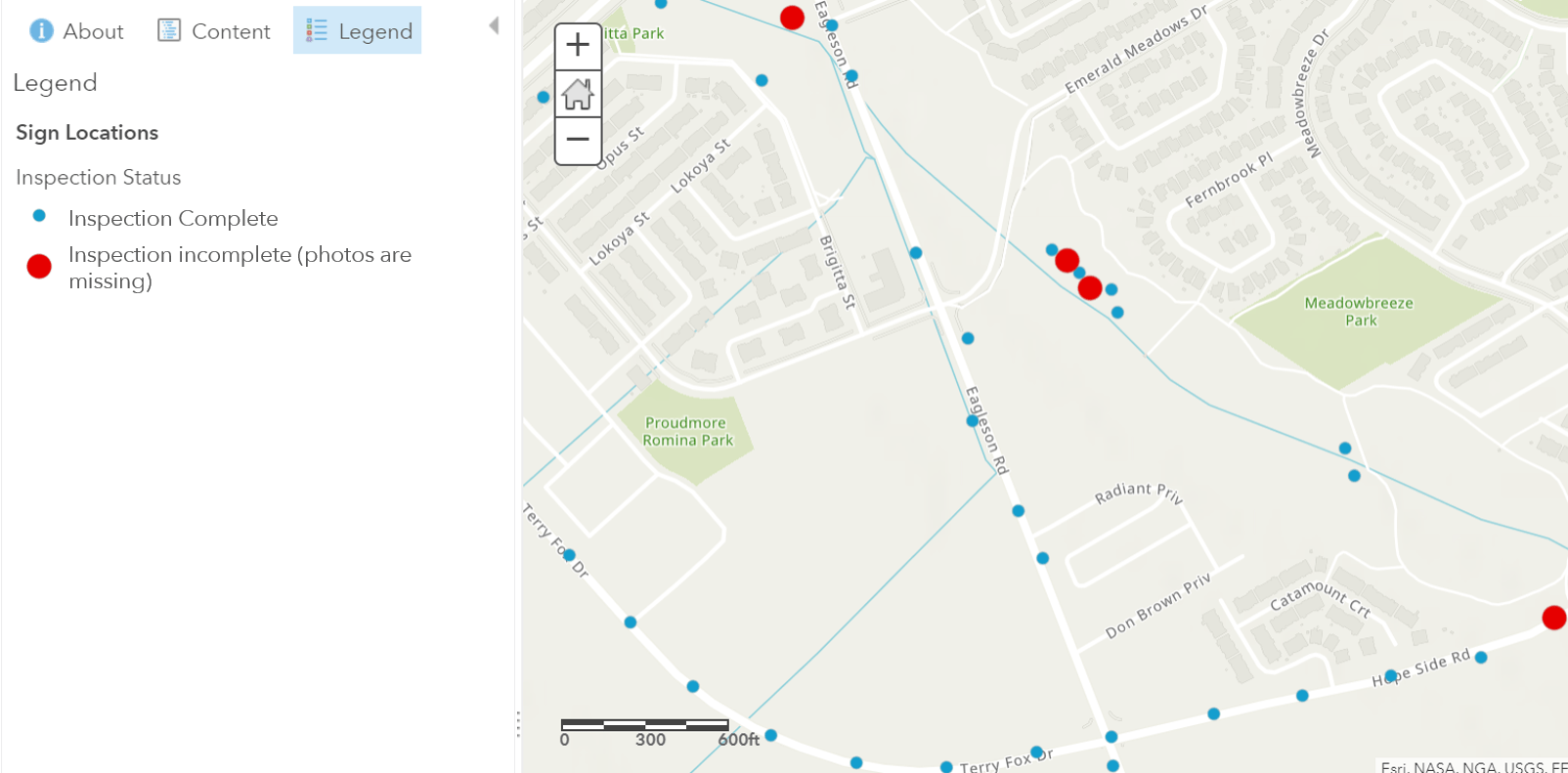

Identify features with attachments based on a condition
After getting the number of attachments, you can build in more complexity as required. For example, what if you only wanted to identify features that have 0 attachments AND have a status of Inspected. Your expression might look something like this:
// Is status = Inspected, and does the feature have attachments
If ($feature.status == 'Inspected') {
If(Count(Attachments($feature)) > 0) {
// if count is greater than zero there are attachments
return 'Inspection Complete'
} else {
// otherwise the feature has been inspected but missing photos
return 'Incomplete inspection (photos are missing)'
} else {
return 'Not Applicable'
![](https://www.esri.com/arcgis-blog/wp-content/uploads/2019/03/Attachments2.png)

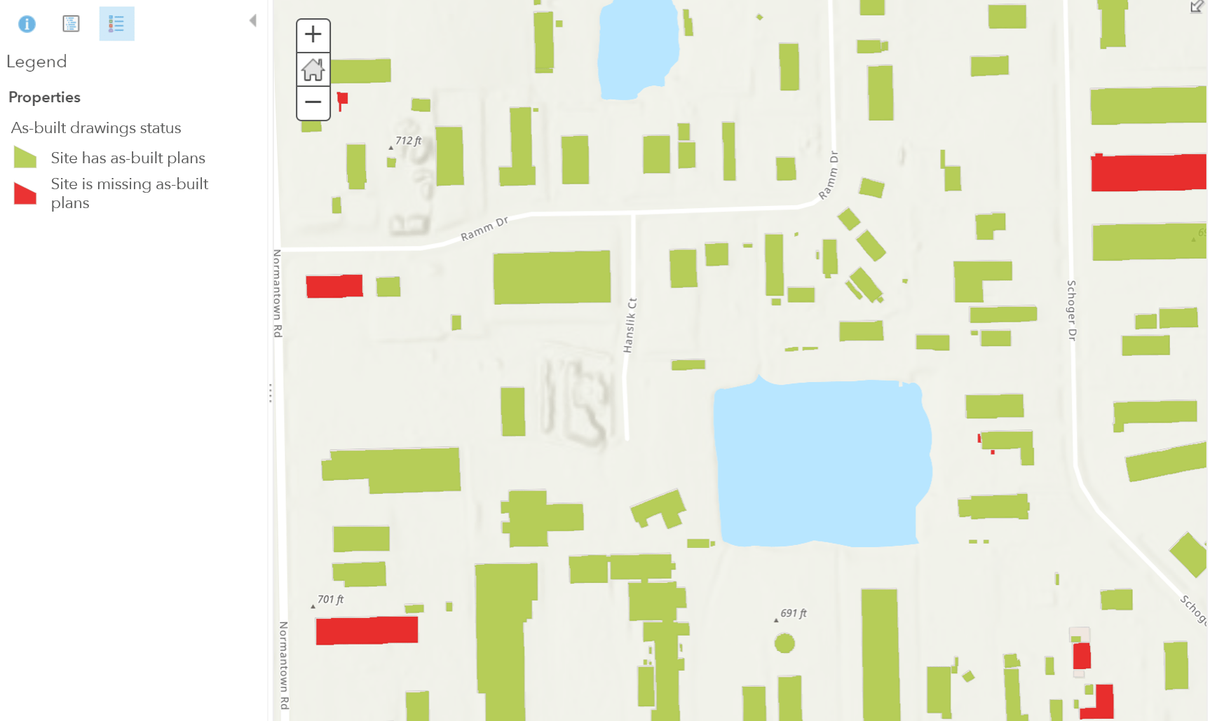

Find a specific file within your feature’s attachments
With this new information, you can send your field crew back out with a focused objective to collect photos for the missing assets.
You can also dive in and get information about one or more specific attachments by accessing the properties of the Attachment data type. That additional information might be useful if you’re trying to understand something like your attachments and their size or type. Maybe you’re interested in finding a specific attachment by a well-known file name. Diving deeper could let you quickly audit your buildings/properties and make sure they all have an as-built plan attached to them based on your organization’s naming conventions.
That would look roughly like:
var attachmentOptions = {"types":["application/pdf"]}
var pdfAttachments = Attachments($feature,attachmentOptions)
var hasAsBuilt = 0
// Make sure there are attachments before trying to get the properties
If (!isEmpty(pdfAttachments)) {
for (var a in pdfAttachments) {
//look for the specific file name
if (pdfAttachments[a].name == 'As Built.pdf') {
hasAsBuilt = 1
// Check the value and return a human readable string
If (hasAsBuilt == 1) {
return "Site has as-built plans"
} else {
return "Site is missing as-built plans"
![](https://www.esri.com/arcgis-blog/wp-content/uploads/2019/03/Attachments3-1.png)
It’s important to remember that like most things in Arcade, you are responsible for checking for nulls. Without checking for no attachments in this scenario, you will end up with errors (on features with no attachments) evaluating the expression.
