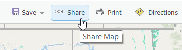

Step 1. Using the map viewer, save any changes you may have made, then click Share.

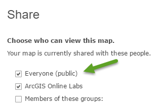

Step 2. Share the map publicly. This enables the Embed In Website button shown in Step 3 below.

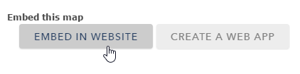

Step 3. Choose Embed In Website.

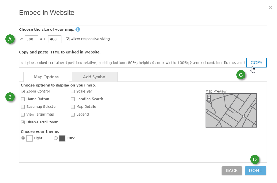

Step 4. Choose the embed options as desired.
A. Specify the size of your map. It’s recommended that you leave Allow responsive sizing checked. This ensures the map will use the available width while maintaining the aspect ratio.

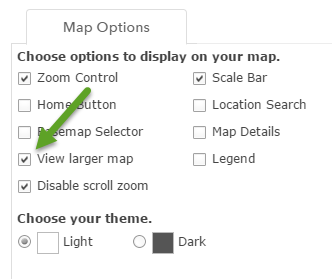

B. Choose the desired Map Options. For example, you may want to include a view larger link, or a Home button, or may want a dark theme instead of a light one.
Map Options are a powerful feature, enabling you to customize your embedded map experience in a variety of ways, similar to some configurable apps.
Tip: Keep Disable scroll zoom checked to prevent scroll from zooming the map, instead of scrolling the web page. Viewers can still navigate the map by panning, or clicking zoom in/out buttons.
C. Any changes you make will automatically modify the HTML. When finished, click Copy to capture the HTML to the clipboard to paste into your website or blog.
D. Click Done to dismiss the dialog.

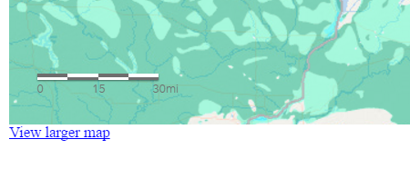

Add a View larger map link
An option you can enable for your embedded map is View larger map. It’s a link a visitor to your site can click to see and interact with a larger version of your map, outside the context of the hosting web page or blog. Check the box in the Map Options (see 5B above) to enable View larger map.
A View larger map link will be added to the HTML, and will appear on the left, below your map, when you embed it.
You can edit the embed HTML to change the link text, size, color, and more using standard markup.
