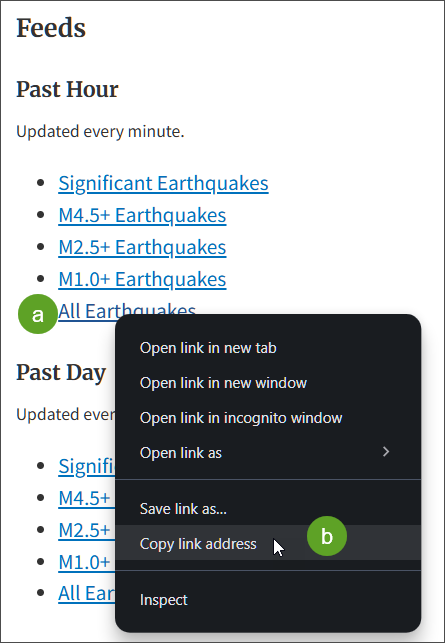

Step 1  Go to the USGS earthquakes live feeds spreadsheet format site.
Step 2a  Locate the feeds in the last hour section (on the right of the page) and right-click the link to All earthquakes.
Step 2b  Choose Copy link address to obtain the URL to the location of the file. Note that depending on the browser you use (this examples shows Chrome) the options shown in the menu may differ.
Obtain URL to file

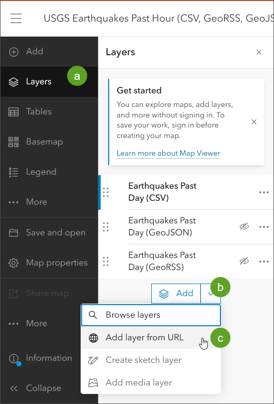

Step 2a  Open the map and click Layers from the Contents (dark) toolbar.
Step 2b  Click the drop-down for Add Layer and choose Add layer from URL.
Add layer from URL

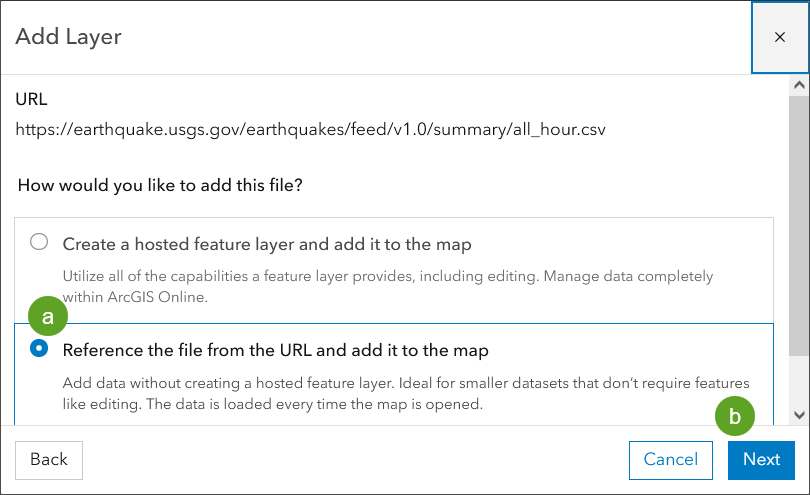

Step 3a  Paste the URL obtained in Step 2b above into the
Step 3b  Ensure the type is CSV (this should happen automatically).
Step 3c  Click Next.
Step 4a  Add the file by referencing the file by URL. If you choose to create a hosted feature layer, a snapshot of the current status will be published and you will need to update the hosted feature layer manually.
Step 4b  Click Next.

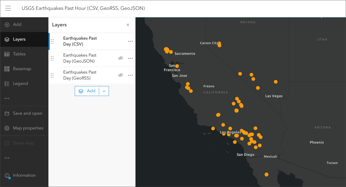

The locations of earthquakes are read from the CSV file (which is physically located on the USGS website and referenced via its URL) and displayed on the map.
Every time the map is opened, new data will be fetched from the layer URL locations. Since a refresh interval has also been set, even when the map is not refreshed the layers will update every minute, matching the USGS update interval.
!-minute refresh for live earthquake feed

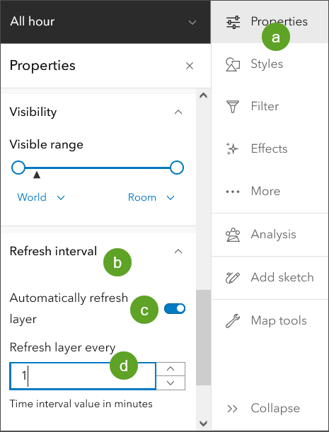

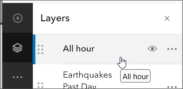

To set a refresh interval, select the layer.
Select layer
From the Settings (light) toolbar do the following:
Step 5a  Click Properties.
Step 5b  Scroll down and click Refresh interval.
Step 5c  Toggle Automatically refresh layer on.
Step5d  Set the refresh interval to 1 minute to match the refresh interval of the source USGS file.
Refresh interval
The layer refresh interval is saved with the map, and updates will occur as specified wherever the map is used (in apps, embedded in websites, etc.).
