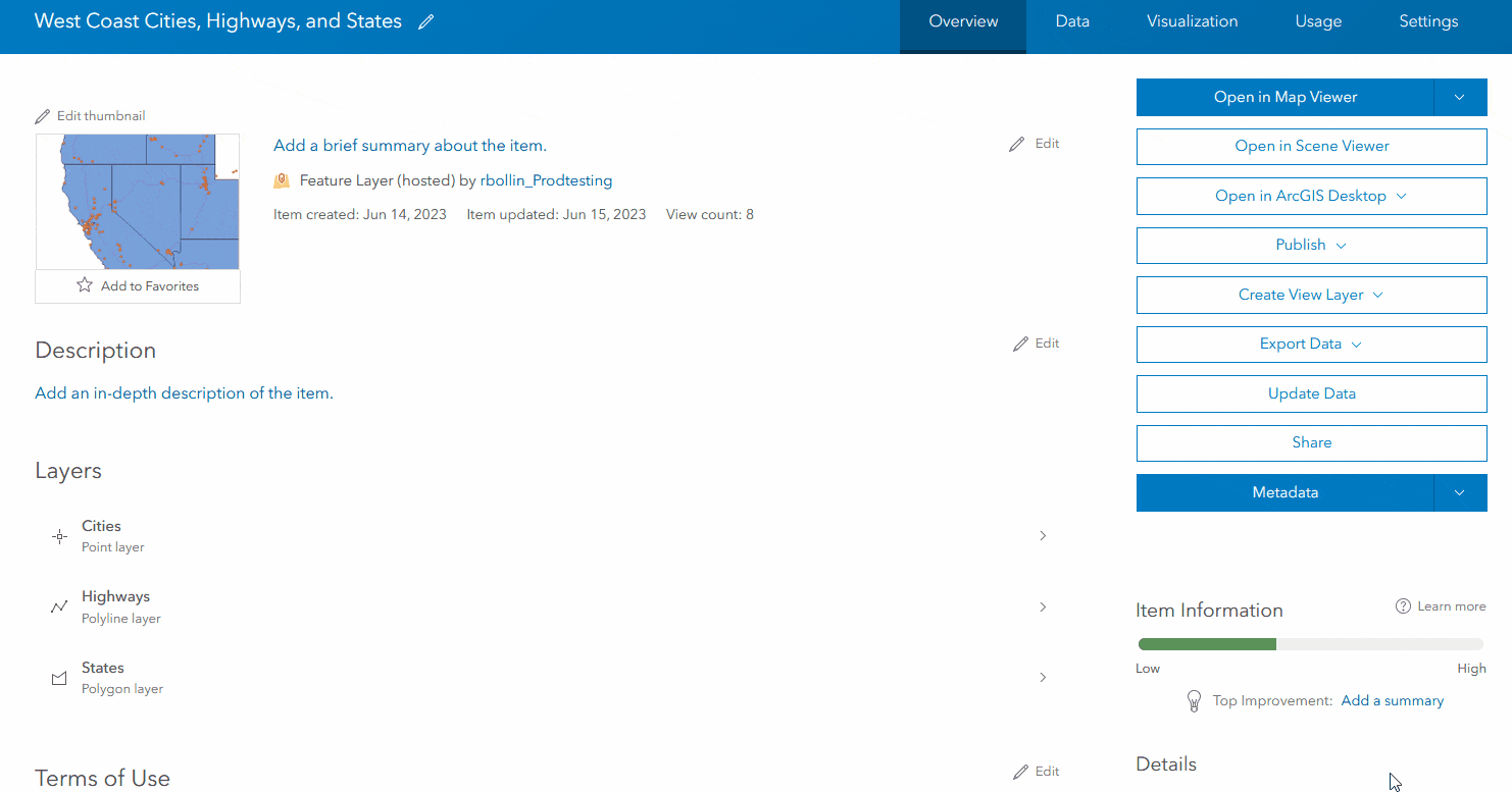

Where can you access Update Data?
- The Update Data button on the Item Details page
- The Update Data button on the layer’s details page*
- Through the Options menu on the Data tab*
*Note: The option to Overwrite entire feature layer is not available through these entry points.

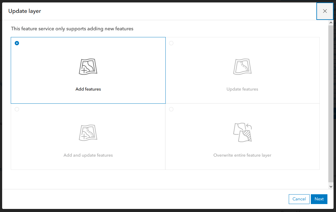

![http://In%20this%20image%20where%20sync%20and%20change%20tracking%20is%20enabled%20on%20a%20hosted%20feature%20layer,%20all%20options%20except%20add%20features%20are%20greyed%20out](https://www.esri.com/arcgis-blog/wp-content/uploads/2023/06/SyncChangeTracking.png)

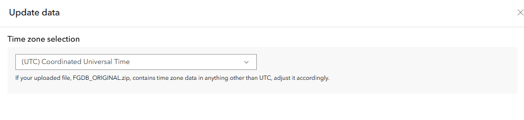

- Select a time zone for your uploaded file if it was created in something other than standard UTC
![This image shows the timezone selection UI This image shows the timezone selection UI](https://www.esri.com/arcgis-blog/wp-content/uploads/2023/06/timezoneselection-1.png)
