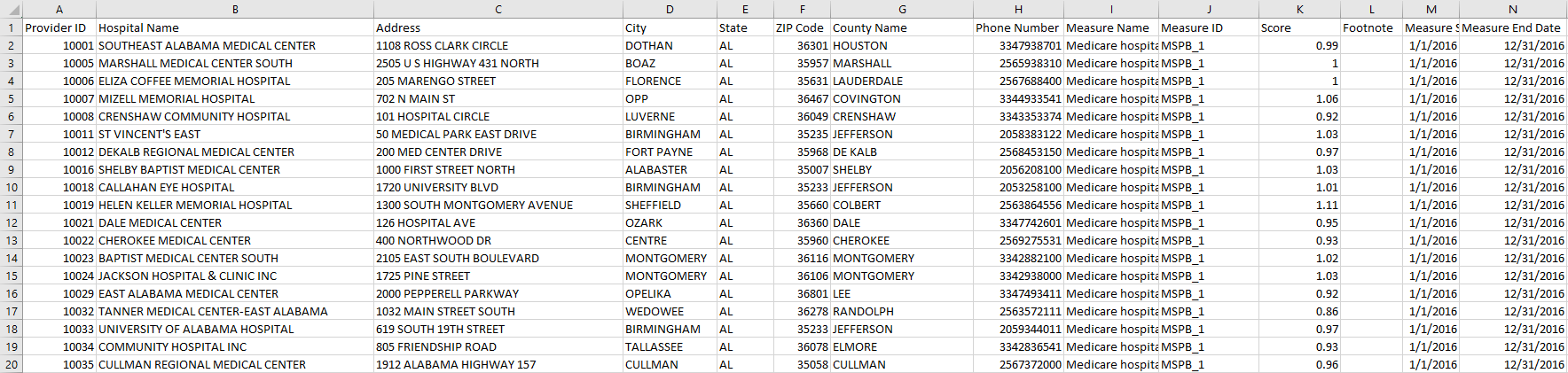

Often times, data analysts and GIS specialists need to turn spreadsheets on their local computer into a feature layer. Here, I have a local spreadsheet on my computer that contains information about Medicare spending per patient for various hospitals. The fields that contain location data for each hospital are called Address, City, State, and Zip_Code.
![spreadsheet of 20 rows of hospitals with addresses in multiple fields (street, city, state, zip_code) spreadsheet of 20 rows of hospitals with addresses in multiple fields (street, city, state, zip_code)](https://www.esri.com/arcgis-blog/wp-content/uploads/2019/06/Hospitals_table.png)

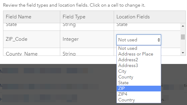

ArcGIS Online will then prompt you to publish this file as a hosted feature layer, and will pick up on the fact that your data has address fields in it, and offer to use those as the location fields. Check to make sure that Address, City, State, and Zip are matched as desired. In my case, my field is named “ZIP_Code” so I manually set it to use that field as the zip:
![All address fields were recognized by ArcGIS Online except for Zip_Code. This screenshot shows manually setting this field to use the location field option of "ZIP" All address fields were recognized by ArcGIS Online except for Zip_Code. This screenshot shows manually setting this field to use the location field option of "ZIP"](https://www.esri.com/arcgis-blog/wp-content/uploads/2019/06/Set_up_geocode.png)
I can also manually set the field type here as well. For example, if you have FIPS codes with leading zeros in your flat file, you might want to make sure these are read in as strings rather than integers.

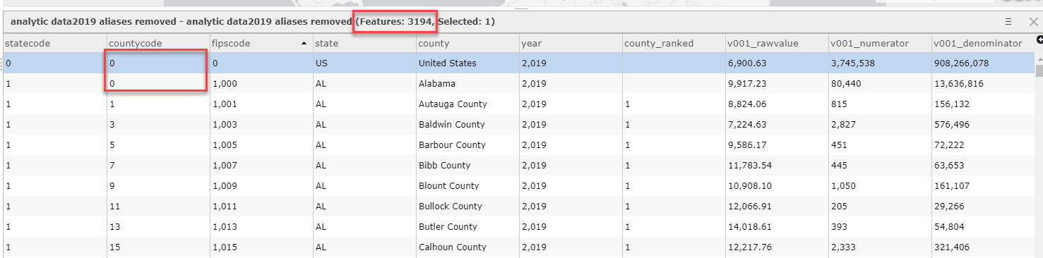

You might have noticed something else as well: This table contains records for the US as a whole, records for each state, and records for each county, pretty common for government datasets. Since I am just bringing in this a basic rectangular dataset, or flat file, as a table into ArcGIS Online, this is okay. Once I’m working with it, I can apply filters.
Similar to before, I’ll start from My Content, click Add Item -> From Computer, but select “add as table” this time instead of “Coordinates” or “Addresses or Places” as shown:
![Screenshot of three radio buttons: Coordinates, Address or Place, and Add as Table. Add as Table is selected and screenshot has a red box around this choice. Screenshot of three radio buttons: Coordinates, Address or Place, and Add as Table. Add as Table is selected and screenshot has a red box around this choice.](https://www.esri.com/arcgis-blog/wp-content/uploads/2019/06/Add_as_table.png)
Again, once the item is generated, ArcGIS Online will bring you to the Item Details Page. From here, I’ll select Open in Map Viewer -> Add to New Map. Now I can filter out the records that I’m not interested in. First, with my table added to the Map Viewer, I can verify how many records this table has (3,194). Remember, it has a record for the whole US, for each state, and then for each county. Records for the U.S. and the states have a value of 0 in the field called countycode:
![Screenshot of an attribute table with a red box around the "features:" count on the top of the table. Screenshot of an attribute table with a red box around the "features:" count on the top of the table.](https://www.esri.com/arcgis-blog/wp-content/uploads/2019/06/attribute_table.png)
I can apply some filters to get down to only the records I want. First, I’ll say countycode is not 0 to remove any non-county records.
![Filter expression dialogue box with an expression saying 'countycode is not 0' Filter expression dialogue box with an expression saying 'countycode is not 0'](https://www.esri.com/arcgis-blog/wp-content/uploads/2019/06/Filter_1.png)
This gets me down to 3,142 records.

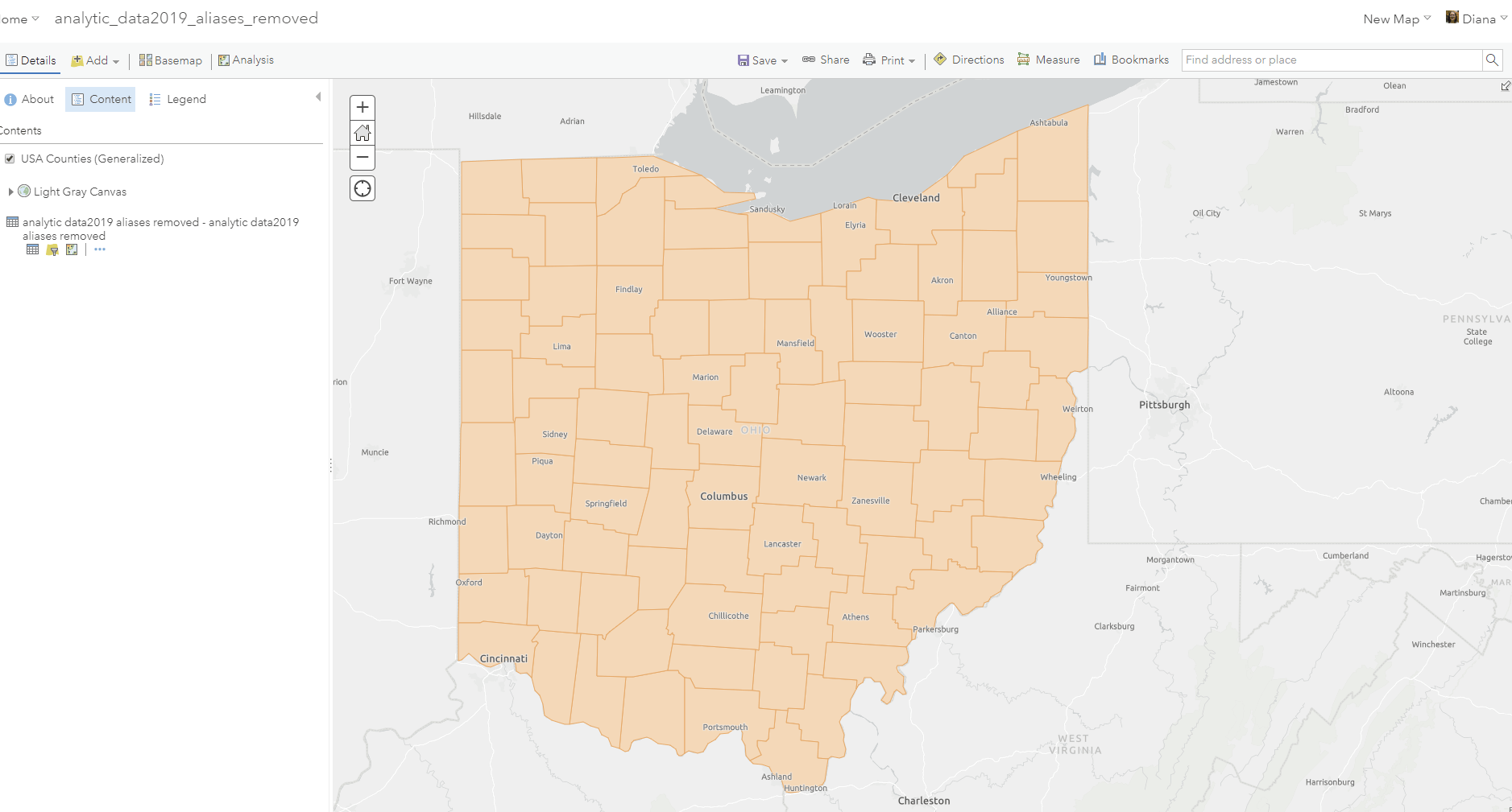

From there, I’ll click Add -> Browse Living Atlas Layers, and add the USA Counties (Generalized) layer of county polygons to my map. Apply a filter to the counties layer as well, so that it only shows counties in Ohio, not all counties in the U.S. Doing this will decrease running time for our Join, and also consume fewer analysis credits!
![Map of Ohio Counties. Map of Ohio Counties.](https://www.esri.com/arcgis-blog/wp-content/uploads/2019/06/Ohio_Pre_Join.png)

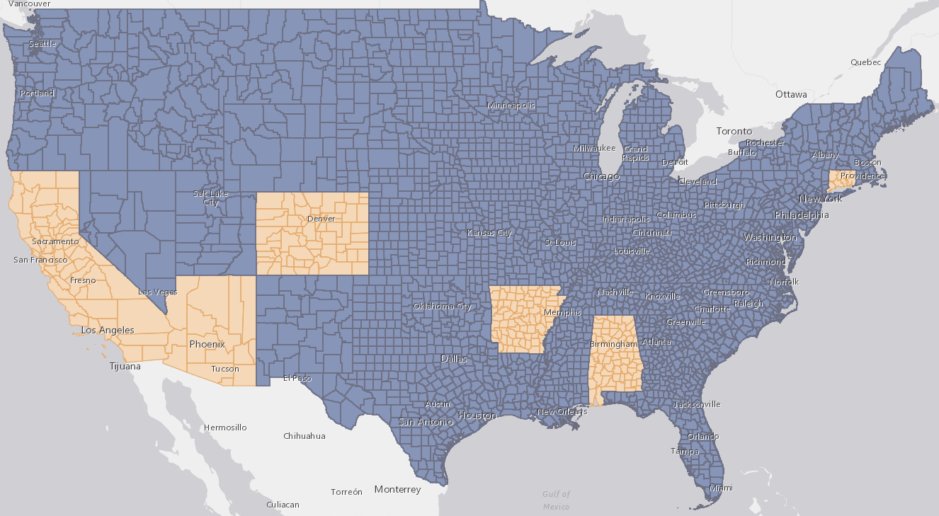

When Joining by a Match ID such as FIPS
- Watch leading zeros for states with single-digit FIPS codes: Alabama (01), Alaska (02), Arizona (04), Arkansas (05), California (06), Colorado (08), and Connecticut (09). Often these leading zeros get dropped because computers are quick to recognize this field as a numeric rather than string field. If your resulting layer looks like this, it’s because one place has the leading zeros and one does not, and therefore values do not match. You can preserve the leading zero by manually setting the field type to String when adding the spreadsheet as a feature layer.

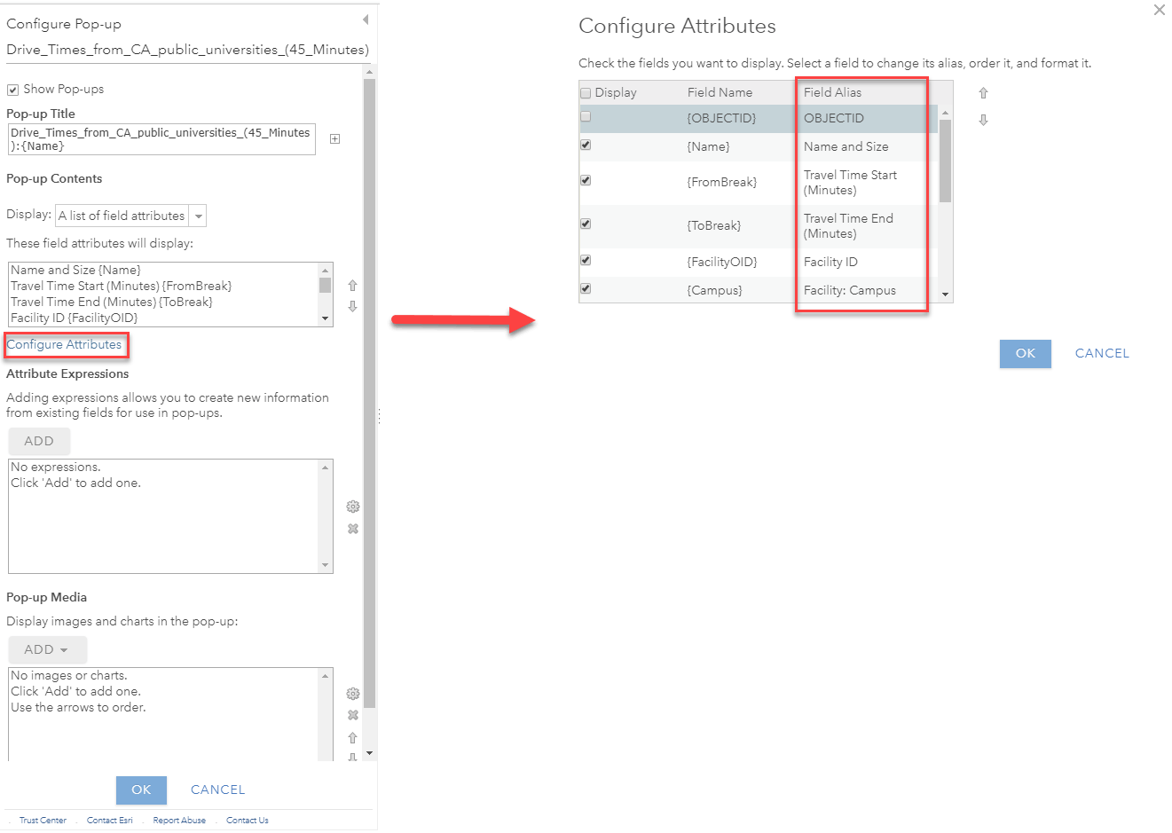

Remember those nice display names we saved from earlier? We’ll now add those as our field aliases. There are two major benefits to adding aliases: one is a benefit for the viewer of your map, and the other is a benefit for any users of this layer. First, they make any auto-generated and pop-ups legends instantly more meaningful since the alias is used in legends and pop-ups first, the field name is used only if there are no aliases. Second, aliases help anyone working with the layer (including you!) while viewing the attribute table, trying to figure out what this data is about, and making decisions for symbolizing their map. Aliases turn spreadsheet data into a shareable dataset.
There are two main ways to add aliases:
- From within the Web Map, go to Configure Pop-up -> Configure Attributes and then type in the aliases for your fields of interest. Here I can type in the display name I want in the column called Field Alias:
