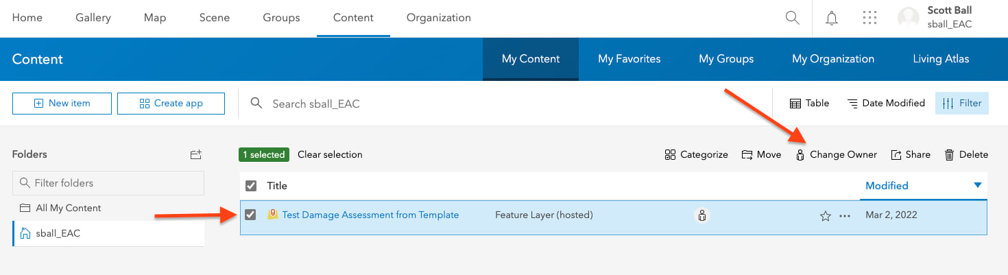

Once everyone has the right privileges, the process is straightforward. The person transferring the content will select the item(s) within their ‘My Content’ page within the organization. In this example I am going to transfer ownership of the ‘Test Damage Assessment from Template’ feature layer to someone else.
image showing a selected item in 'My Content'

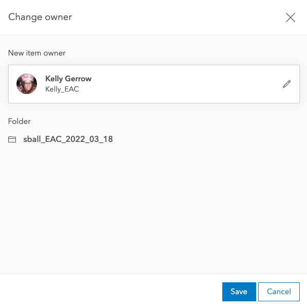

With the item(s) selected, choose ‘Change Owner’ and select the organization member to which you wish to transfer the content ownership. In the image below I’ve chosen to send the feature layer to Kelly.
the 'Change Owner' dialog box
Click ‘Save’ and the content will be transferred to the member you selected. You will notice the content is no longer visible in ‘My Content’. Keep in mind the member receiving the content (the new item owner) will not receive a notification that they have new content. It is a good idea to reach out to them outside the ArcGIS Online system to let them know the process has been completed.

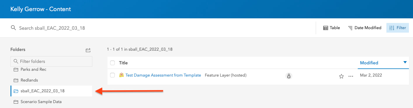

When the transfer has completed, the person receiving the content will have a new folder in their ‘My Content’ page. The new folder will contain the transferred items and will have the name of the person who transferred the content and the date it was transferred in the folder name. The person receiving the content is the new owner of the item(s) and they are free to modify the item(s) as they wish. Kelly can now see the Test Damage Assessment in the sball_EAC_2022_03_18 folder I transferred to her in her ‘My Content’ page.
the new folder in the new owners Content page

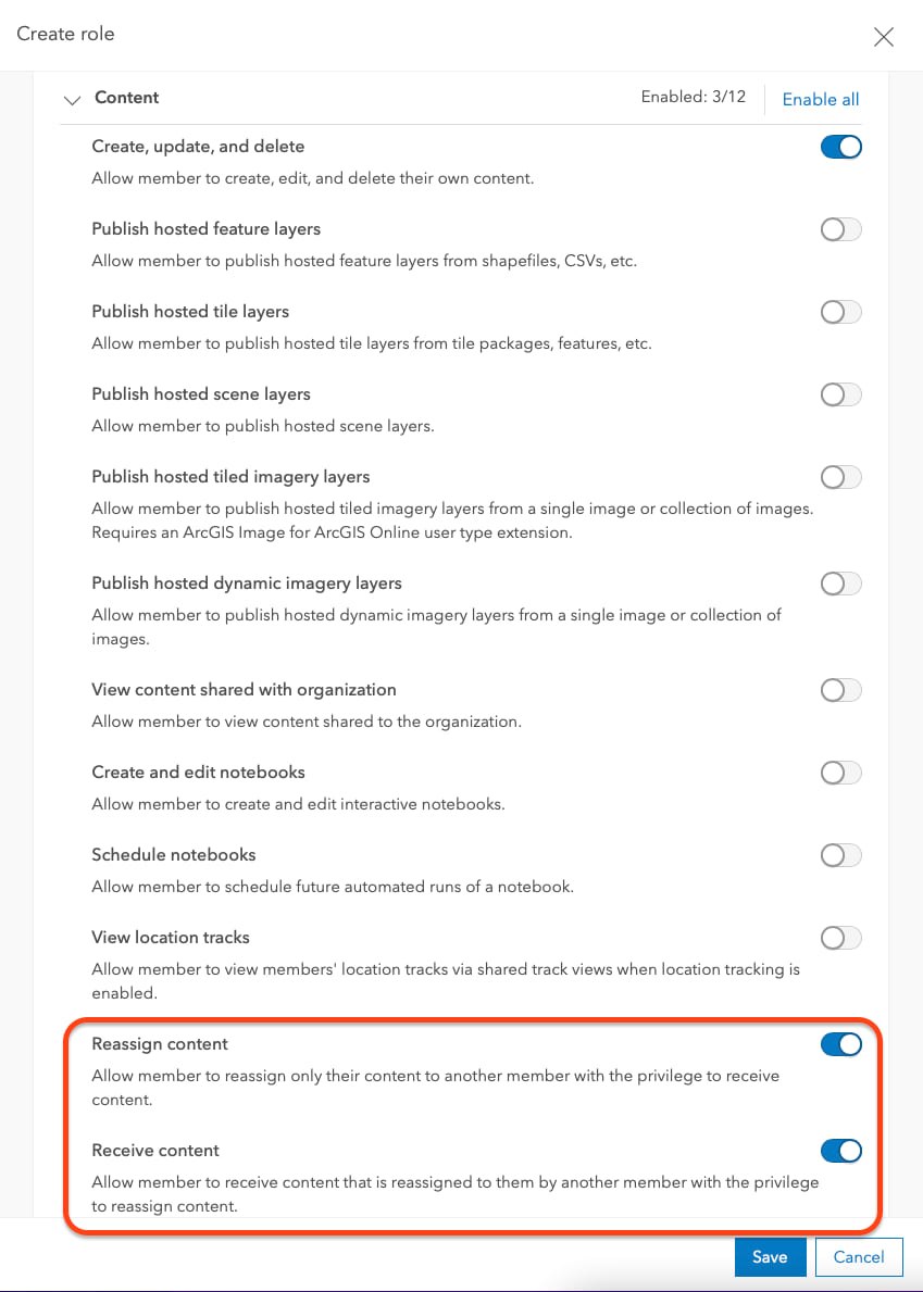

There are two new member privileges that an organization administrator can use to enable sending and receiving of content:
  • Reassign content
  • Receive content
These privileges are set as part of a custom role that can be assigned to your organization members. They are not available to use with default member roles (aside from Administrators, who have always had the ability to transfer content), but custom roles can be easily created in the image of a default role during configuration. When editing a custom role, administrators can find the new privileges under ‘General privileges’ > ‘Content’ at the bottom of the section just beneath the ‘View location tracks’ privilege.
the two new member privileges highlighted in the UI
If you want members with this custom role to be able to send and receive content, turn both privileges on. We encourage you to carefully consider who within your organization should have these privileges (and when). Do all of your users need them all the time? Or do they only need them during certain time periods, such as during project transitions? Do only certain trusted power users need them? You will want to balance the power of unrestrained content transfer versus the administrative overhead of assigning and reassigning roles when content transfers need to happen. You know your organization and your personnel the best and you can determine the best strategy for your organization.
