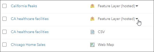

The first thing you’ll notice when looking at a list of items is that feature layer items now display a small arrow next to the item name.

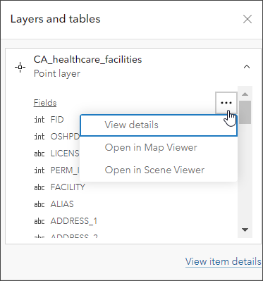

Click the arrow to reveal details. For example, in the item shown below, the feature layer has one point layer. Click the layer name to display the attributes.
After learning more about the layer, you can click the ellipsis (…) to view the item details or open it in Map Viewer or Scene Viewer.
The example shown below has several different sublayers and tables. Click a sublayer or table name to further expand the preview to show the list of fields. This is an easy way to ensure the layer has the right attributes you’re looking for.
