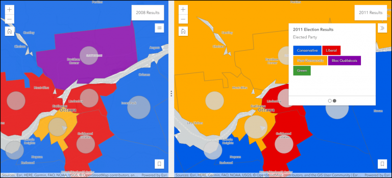

Example 1: Compare changes year over year change in the same location

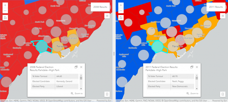

How a population votes in a national election changes between election years. Map readers can use visualizations to understand which party received the most votes, what voter turnout was, and changes over time. The compare app allows users to explore election results between two years, allowing a side-by-side comparison of the same geography. In the example 1, app readers can navigate to their location of interest and directly compare how the symbology has changed.
![](https://www.esri.com/arcgis-blog/wp-content/uploads/2018/12/Pop-Up-768x346.png)
Example 1 is an app compares the 2008 and 2011 election results in Canada. The map and pop-ups are synchronized, enabling the map reader to compare the exact geographic region with the two sets of results. The navigation experience is seamless, as moving to one location in the 2008 results is mirrored in the 2011 results and vice-versa. The synchronized pop-ups enable users to compare the attributes of the same electoral district in different maps in a side-by-side format. Bookmark navigation is used to easily guide readers to areas of interest selected by the map author.

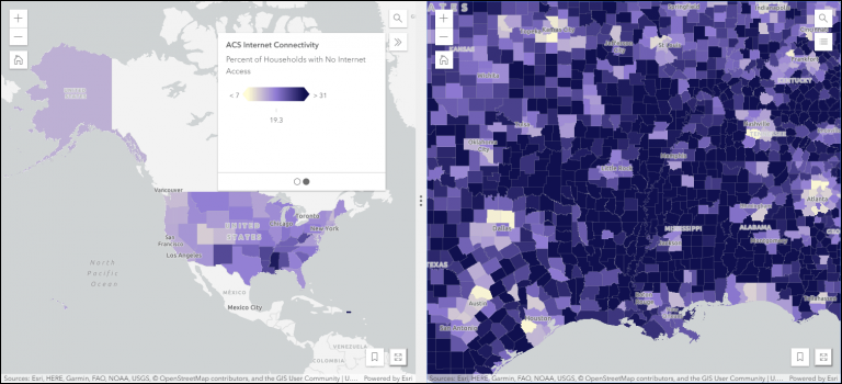

Example 2: Compare a single subject in different locations
When displaying thematic maps using a single variable across a large geographic area, being able to easily compare different locations helps map readers understand regional changes. Example 2 below displays the percentage of households with no access to the internet based on data from the American Community Survey. Map readers can compare the results of the survey data from the state, county, and census block geographies. As the map navigation isn’t synchronized, readers can scroll, search, and navigate to areas of interest in each map and directly compare between the two windows.

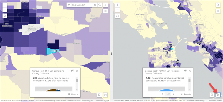

When investigating a location, pop-ups can provide detailed information about specific zones, enabling users to see the spatial pattern, as well as specific values. The expand option button allows users to more deeply explore a specific region and then return to side-by-side inspections.

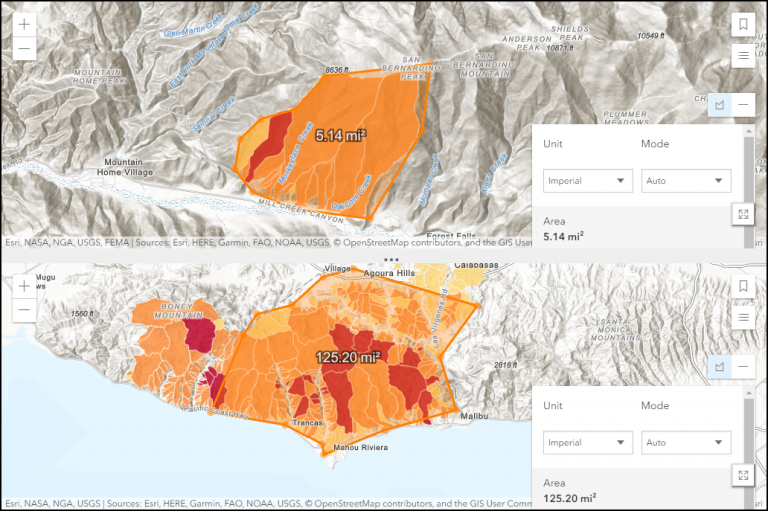

Example 3: Compare locations in a stacked view and explore size with the measure tool
With the new Compare app, you can choose to display the maps side by side or stacked, depending on how you want to display the features in the maps. Adding the measure tool allows map readers to explore the size in relation to other features in the app.

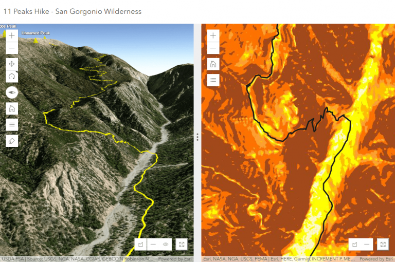

Example 4: Compare a scene and a map
The new Compare app doesn’t make you choose to either compare two maps or two scenes. You can choose to compare a scene to a map, which allows users to understand a 3D and 2D visualization of data. When the scene and map are synchronized, map readers can navigate by panning and zooming in either the scene or map to find the location that they want to explore further, or by navigating through slides. Example 4 allows map readers to view and quantify the elevation gain for a specific hike.
