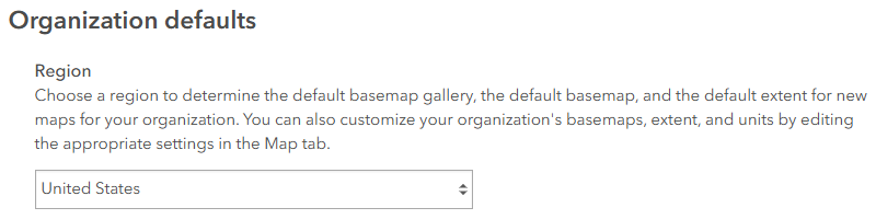

If you would like to use the new set of custom basemaps for United States in your work, you should first verify that the region setting for your organization (or public account) is set to United States. When signed in to ArcGIS.com, you can click your name and My settings to confirm if your region is set to United States. If not, you can coordinate with the organization administrator to update the organization defaults like below.

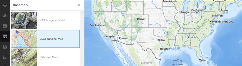

When this is done, you can open the Map Viewer, select the Basemap tool on the toolbar and you should be able to scroll down and see a curated set of country-specific basemaps, including the USGS National Map and others.
If you see these country-specific basemaps, you can select one of the over 25 vector basemap styles that Esri offers (e.g. Topographic, Navigation, Outdoor, etc.) and you will be using one of the new custom basemaps for the United States. If you save a new web map, it will save this basemap layer in your map.
