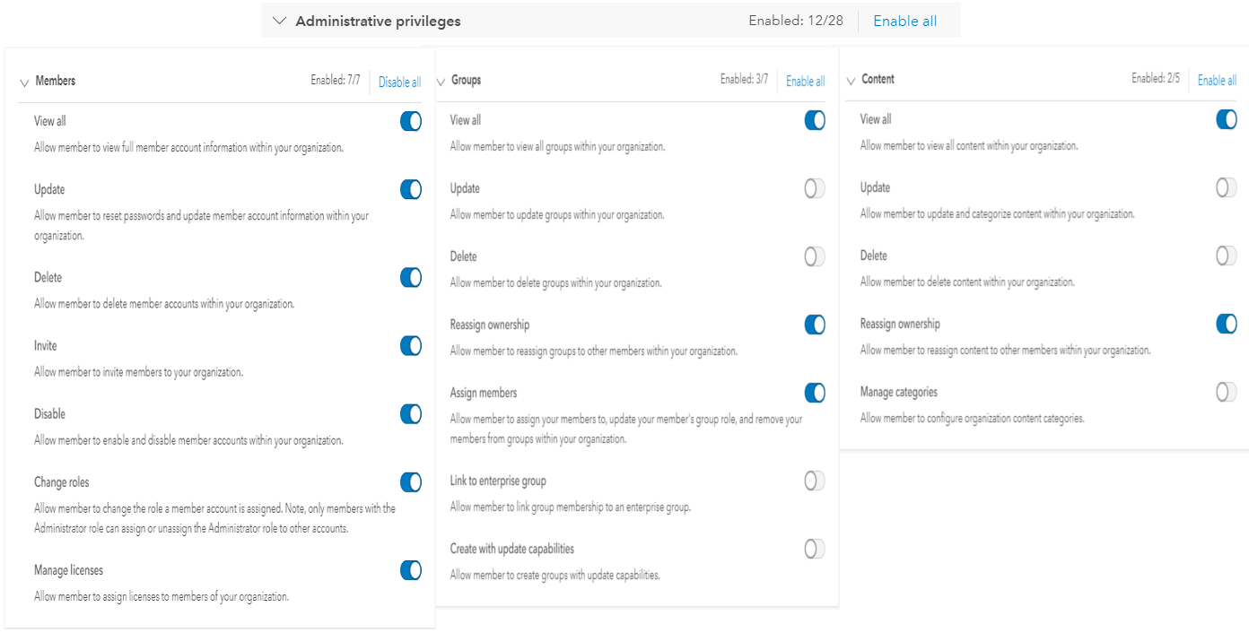

Image of the necessary permissions for a custom role in this example.
Image 1 - Members: View all, Update, Delete, Invite, Disable, Change roles, Manage Licenses; Groups: View all, Reassign ownership, Assign members; Content: View all, Reassign ownership.

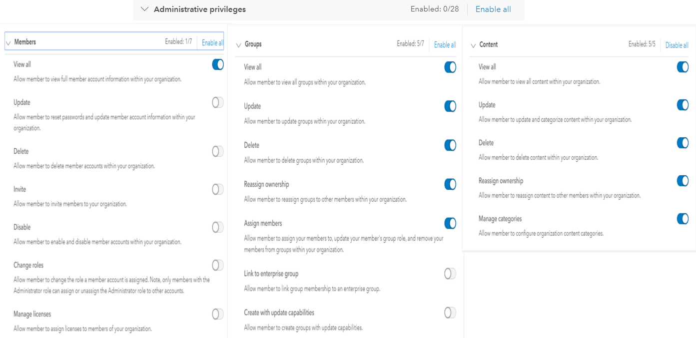

Image 2 - Members: View all; Groups: View all, Update, Delete, Reassign ownership, Assign members; Content: View all, Update, Delete, Reassign ownership, Manage categories.

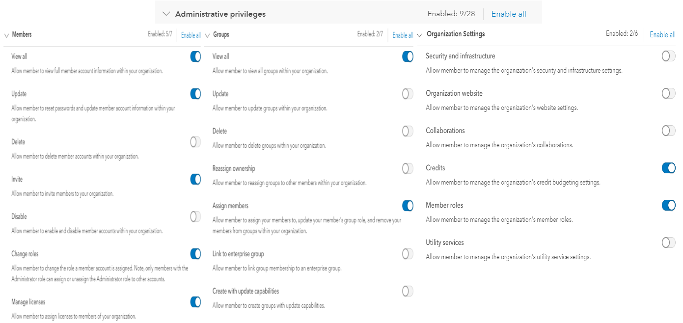

Image 3 - Members: View all, Update, Invite, Change roles, Manage licenses; Groups: View all, Assign members; Organization settings: Credits, Member roles.

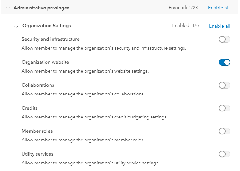

Image 4 - Organization Settings: Organization website.
