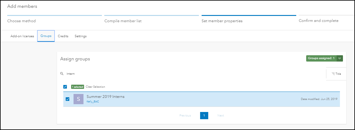

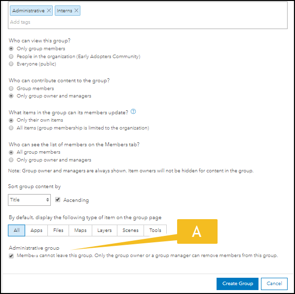

To create an administrative group, you must be a default administrator of your organization. When creating the group, ensure that the Administrative Group option is enabled (Image 1- A). As this group is going to be used for administration rather than sharing, only the group managers and owner will be able to contribute content to this group. Once the group is created, you can either manually add the interns as group members, or include the group as a member property when initially inviting the interns to join the organization. Using the invitation workflow will ensure that the member is added to the group when their account is created (Image 2).

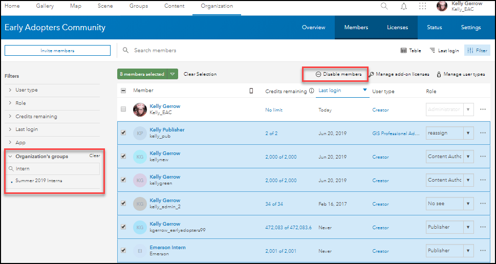

At the end of the work term, a member manager can filter by the group name and disable all the intern members in a single action (Image 3). As the membership is managed from account creation until the end of the work term, there is no concern that an account was missed during this action.

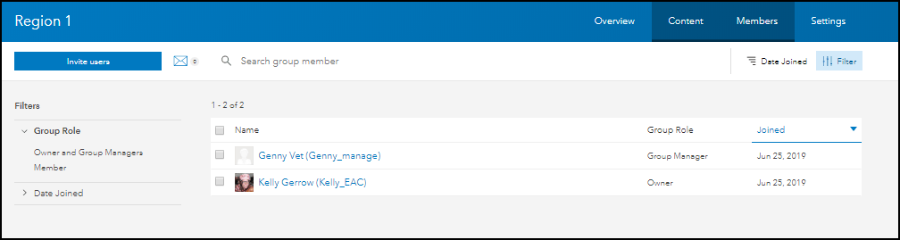

As organizations have grown over time, so has the number of departments or regions that use ArcGIS Online. Many organizations have multiple administrators or member managers to manage the accounts and access of members in their region. If an organization has a single member with the administrator role and several member managers (custom role with administrative privileges), it is still possible to have the member managers control the membership of the administrative group. The administrator must initially set up the administrative groups as described in the first example above (Image 1), but can then add the member manager as a group manager for their specific region.
![Displays group roles for Region 1 group. Kelly is the group owner and Genny is the group manager. Displays group roles for Region 1 group. Kelly is the group owner and Genny is the group manager.](https://www.esri.com/arcgis-blog/wp-content/uploads/2019/06/member-manager.png)

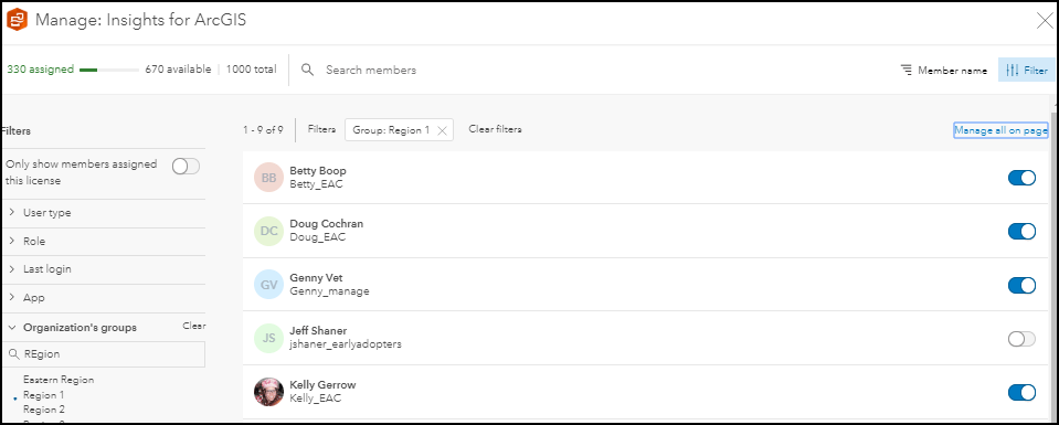

The image above, (Image 4) shows Genny is the group manager of the Region 1 group. She can invite and add members to the Region 1 group and remove them as needed, but doesn’t have the ability to remove members from the other region groups. As group manager of the Region 1 group, Genny can easily find and manage the members in her regional group. This is particularly helpful when Genny needs to see which members of her region need a license for Insights for ArcGIS, as shown in the image below (Image 5).
