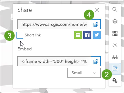

Tip: To capture a viewpoint, click Share to copy the short link. To obtain the viewpoint cam coordinates (which you can combine with other scenes and URL parameters), follow these steps.
Step 1 – Open a scene and navigate to a location at the desired viewpoint.
Step 2 – Click Share from the toolbar.
Step 3 – Uncheck Short link.
Step 4 – Copy the link.
Copy link
